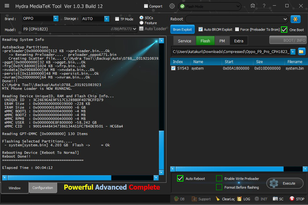

Hydra Oppo F9 (CPH1823) System File successfully flashed by Hydra Tool
546
Brand : OPPO Model : F9 (CPH1823) Connection : Flash Mode
How To Boot : Power off phone
* BROM Mode : Press VOL + or Press VOL -+
FriendlyName :MediaTek USB Port (COM77)
SymbolicName :\??\USB#VID_0E8D&PID_0003#5&346af9c5&0&1#{a5dcbf10-6530-11d2-901f-00c04fb951ed}
Driver Ver :01/22/2016,3.0.1504.0
Handshaking...Ok
Identifying Hardware ID.....
BROM CPUID : 0788MT6771[6771]
getMTKPayloadExploit : 0788
#Executing Exploit..
#SUCCESS..
Handshaking...Ok
FUSEID : 00000000
SECURE VERSION : 00
BL VERSION : FE
BR Secured : E0
Preparing Download Agent..
DA : 6771.bin
Ver : MTK_AllInOne_DA_v3.3001.2020-11-03.22:07_536568
Init : Loader [1]
Sending : Accepted
Identifying Protocol...
Protocol : New
Synchronization...SYNC
Mode : brom
Preloader Initialization...
Parsing preloader_oppo6771_18311_F9.bin
Init : Accepted
Execute Secondary Loader
Init : Loader [2]
Executing : SYNC
UNIQUE ID : 3C26E9EAE9F517C128980F4D7BCFFD79
ERAM Size : 0x0000000000039000 -228 KB
IRAM Size : 0x0000000180000000 -6 GB
eMMC CID : 90014A484347386134A51FC7B4DE9501 - HCG8a4
DA Speed : high-speed
Reading System Info
Autobackup Partitions
-> Renaming Preloader.... preloader_oppo6771.bin
Creating Scatter file... C:\Hydra Tool\\Backup\Auto\0788__031921083923\MT6771_Android_scatter.txt
-frp[0x07C88000]1024 KB ->frp.bin...Ok
-nvdata[0x09D88000]64 MB ->nvdata.bin...Ok
-persist[0x11800000]48 MB ->persist.bin...Ok
-nvram[0x20D00000]64 MB ->nvram.bin...Ok
Done!!!
- system[system.bin] 4.203 GB Flash -> = Ok
Reboot Done!!
Elapsed Time : 00:04:12
