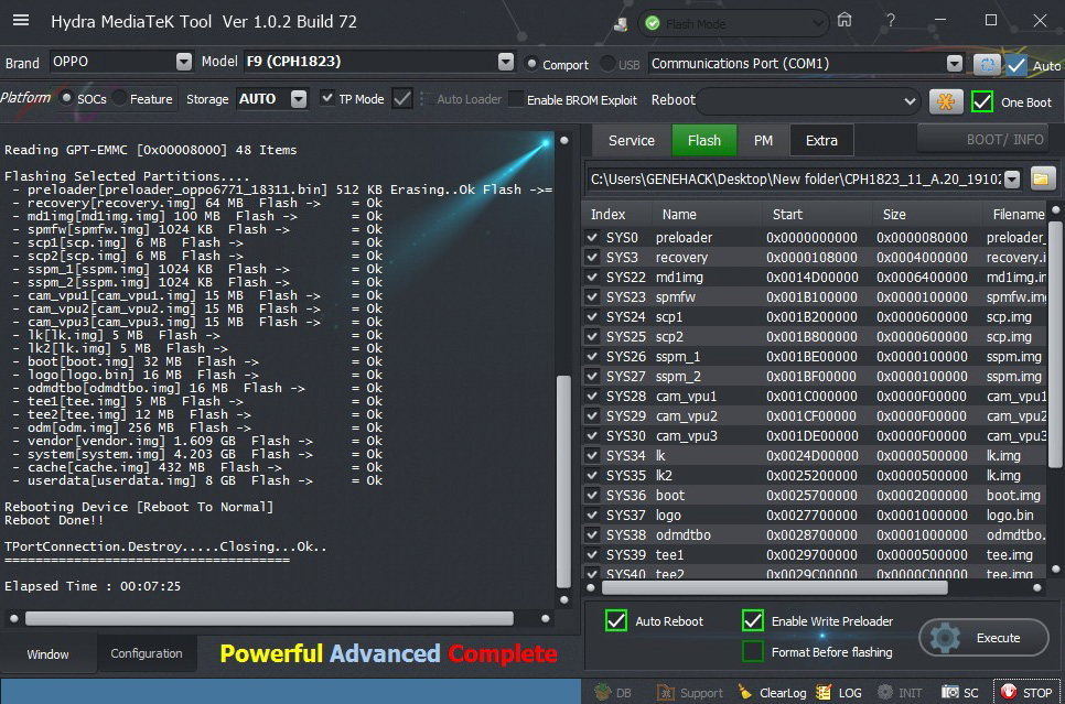

Oppo F9 (CPH1823) Flashing successfully done by Hydra Tool
Brand : OPPO Model : F9 (CPH1823) Connection : Flash Mode
How To Boot : Remove Batt if possible
* TP Ground Must be near cpu..
* Remove ground upon popup of the message dialog.
Connection
-Please wait...
-Found...[COM3]
TPortConnection.Create...(COM3)..Opening...Ok
UNIQUE ID : FE2775F4794EE65CA980BDB802D0B900
eMMC USER : 0x0000000E8B800000 -58.18 GB
eMMC CID : 90014A484347386134A51E46153CA50D - HCG8a4
Reading GPT-EMMC [0x00008000] 48 Items
- preloader[preloader_oppo6771_18311.bin] 512 KB Erasing..Ok Flash ->= Ok
- recovery[recovery.img] 64 MB Flash -> = Ok
- md1img[md1img.img] 100 MB Flash -> = Ok
- spmfw[spmfw.img] 1024 KB Flash -> = Ok
- scp1[scp.img] 6 MB Flash -> = Ok
- scp2[scp.img] 6 MB Flash -> = Ok
- sspm_1[sspm.img] 1024 KB Flash -> = Ok
- sspm_2[sspm.img] 1024 KB Flash -> = Ok
- cam_vpu1[cam_vpu1.img] 15 MB Flash -> = Ok
- cam_vpu2[cam_vpu2.img] 15 MB Flash -> = Ok
- cam_vpu3[cam_vpu3.img] 15 MB Flash -> = Ok
- lk[lk.img] 5 MB Flash -> = Ok
- lk2[lk.img] 5 MB Flash -> = Ok
- boot[boot.img] 32 MB Flash -> = Ok
- logo[logo.bin] 16 MB Flash -> = Ok
- odmdtbo[odmdtbo.img] 16 MB Flash -> = Ok
- tee1[tee.img] 5 MB Flash -> = Ok
- tee2[tee.img] 12 MB Flash -> = Ok
- odm[odm.img] 256 MB Flash -> = Ok
- vendor[vendor.img] 1.609 GB Flash -> = Ok
- system[system.img] 4.203 GB Flash -> = Ok
- cache[cache.img] 432 MB Flash -> = Ok
- userdata[userdata.img] 8 GB Flash -> = Ok
Reboot Done!!
Elapsed Time : 00:07:25
