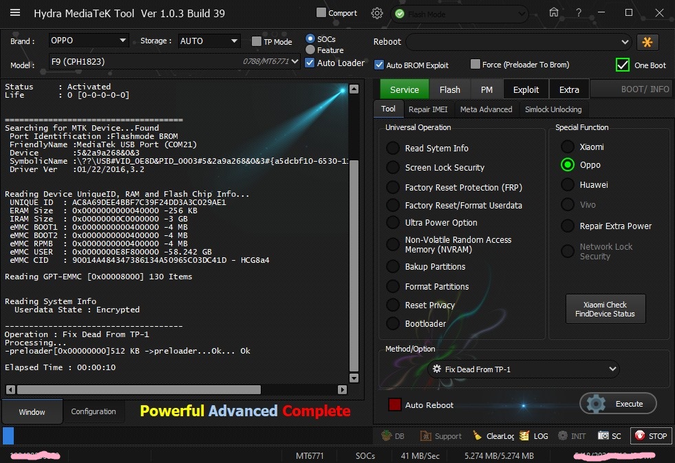

Oppo F9 (CPH1823) fix from dead using TP method done by Hydra Tool
1. Run Hydra MTK Tool.
2. Choose Brand and Module.
3. Go to "Service"--> "Tool"
4. Choose "Oppo"
5. Choose "Fix Dead from TP 1" from drop down menu.
6. Click on "Execute"
7. Connect device with computer using Data Cable.
8. Wait until the operation is completed.
4. Choose "Oppo"
Screen Shorts
Logs
FriendlyName :MediaTek USB Port (COM21)
Device :5&2a9a268&0&3
SymbolicName :\??\USB#VID_0E8D&PID_0003#5&2a9a268&0&3#{a5dcbf10-6530-11d2-901f-00c04fb951ed}
Driver Ver :01/22/2016,3.2
UNIQUE ID : AC8A69DEE4BBF7C39F24DD3A3C029AE1
eMMC CID : 90014A484347386134A50965C03DC41D - HCG8a4
Reading System Info
Userdata State : Encrypted
Operation : Fix Dead From TP-1
Processing...
-preloader[0x00000000]512 KB ->preloader...Ok... Ok
Elapsed Time : 00:00:10
