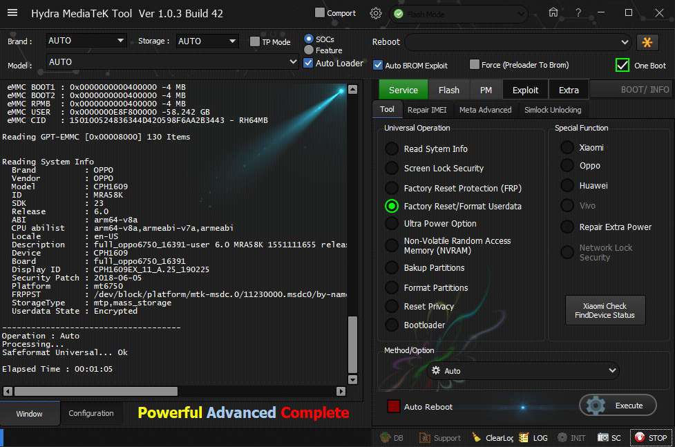

Oppo CHP 1909 (A5s) Universal Unlock successfully done by Hydra Tool
1. Run Hydra MTK Tool.
2. Go to "Servuce"--> "Tool"
3. Choose "Factory Resert / Format User Data"
4. Choose "Auto" from "Method / Option" drop down menu.
5. Click on "Execute"
6. Connect device to computer using data cable
7. Wait until the operation is completed.

Operation : Auto
Processing...
Safeformat Universal... Ok
Elapsed Time : 00:01:05
