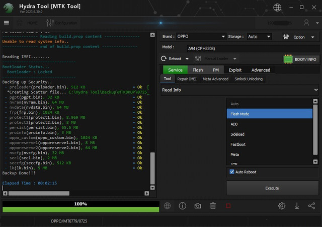

Oppo A94 (CPH2203) FRP Lock Remove with Hydra Tool
- First Keep press boot info
To Enable BROM  Mode :
     Method 1    - Bootkey (Vol + - Power) or any combination
     Method 2    - Enable Preloader to brom(crashing Method)
     Method 3    - Test Point Data0 + ground
To Enable Preloader  Mode :
     Method 1    - Just Insert cable
  MTK Port Type   : Flashmode BROM
  FriendlyName    : MediaTek USB Port_V1632 (COM3)
  Device          : /5&16dd958c&0&3
  SymbolicName    : \\?\usb#vid_0e8d&pid_0003#5&16dd958c&0&3#{a5dcbf10-6530-11d2-901f-00c04fb951ed}
  Driver Ver      : 01/22/2015,3.0.1504.0
  Service         : wdm_usb
Openning Port [COM3] Ok
Handshaking...Ok
  HwCode          : 0725 {MT6779}
  Hwver           : 0000
  Target config   : E5
  SBC             : 01 (True)
  SLA             : 00 (False)
  DAA             : 04 (True)
  SWJTAG          : 04 (True)
  EPP             : 00 (False)
  CERT            : 00 (False)
  MEMREAD         : 20 (True)
  MEMWRITE        : 40 (True)
  CMD_C8          : 80 (True)
  Connection      : BROM
  HW Subcode      : 8A00
  HW Subcode      : CA01
  SW Ver          : 0000
  ME_ID           : F8C2FEF370871CF248367A86F75748C7
  SOC_ID          : A0200F9A1F078757B16E32F2CB362B8EC1B5217BF2A87FA09DDD942C2F7E1BB7
Exploiting Device...
Successfully Exploited..
Handshaking...Ok
Starting to dump...
Prel Size : 0x000550A4
Successfully dump preloader..  [C:\Hydra Tool\Boot\PreloaderDump\preloader_k79v1_64.bin]
  Target config   : 00
  SBC             : 00 (False)
  SLA             : 00 (False)
  DAA             : 00 (False)
  SWJTAG          : 00 (False)
  EPP             : 00 (False)
  CERT            : 00 (False)
  MEMREAD         : 00 (False)
  MEMWRITE        : 00 (False)
  CMD_C8          : 00 (False)
  Connection      : BROM
Patching da2 ... Ok
Uploading Stage 1....
Jumping to 0x00200000 Ok 0xC0
Successfully received DA sync
  ONNECTION_AGENT : brom
  DRAM config needed for : 4839485131354146414D424441520000
Sending auto preloader from dump...  [preloader_k79v1_64.bin]
Sending emi data succeeded.
Uploading stage 2...
Successfully uploaded stage 2
  ERAM Size       : 0x0000000000080000-512 KB
  IRAM Size       : 0x0000000200000000-8 GB
  UFS MID         : 0x48
  UFS FWVer       : 0xA043
  UFS Blocksize   : 0x0000000000001000-4 KB
  UFS LU0 Size    : 0x0000000000400000-4 MB
  UFS LU1 Size    : 0x0000000000400000-4 MB
  UFS LU2 Size    : 0x0000001DCB000000-119.172 GB
  UFS ID          : H
  UFS CID         : 4839485131354146414D42444152000000000000
  HW-CODE         : 0x725
  HWSUB-CODE      : 0x8A00
  HW-VERSION      : 0xCA01
  SW-VERSION      : 0x0
  CHIP-EVOLUTION  : 0x0
  DA-VERSION      : 1.0
  Speed           : high-speed
Reading Partition Table ..
Partition Count : 53
Unable to read system info..
Reading IMEI........
Bootloader Status...
  Bootloader : Locked
Backing up Security..
- preloader(preloader.bin), 512 KB                    = Ok  [preloader_k79v1_64.bin]
  *Creating Scatter file... C:\Hydra Tool\Backup\MTKBKUP\0725_F8C2FEF370871CF248367A86F75748C7\Auto\080923103130\6779_Android_scatter.txt
- pgpt(pgpt.bin), 32 KB                               = Ok
- nvram(nvram.bin), 64 MB                             = Ok
- nvdata(nvdata.bin), 64 MB                           = Ok
- frp(frp.bin), 1024 KB                               = Ok
- protect1(protect1.bin), 8.969 MB                    = Ok
- protect2(protect2.bin), 8 MB                        = Ok
- persist(persist.bin), 55.5 MB                       = Ok
- proinfo(proinfo.bin), 3 MB                          = Ok
- oppo_custom(oppo_custom.bin), 1024 KB               = Ok
- opporeserve1(opporeserve1.bin), 8 MB                = Ok
- opporeserve2(opporeserve2.bin), 64 MB               = Ok
- nvcfg(nvcfg.bin), 32 MB                             = Ok
- sec1(sec1.bin), 2 MB                                = Ok
- seccfg(seccfg.bin), 512 KB                          = Ok
- lk(lk.bin), 5 MB                                    = Ok
Backup Done!!!
Elapsed Time : 00:02:15
- FRP Lock Remove Done

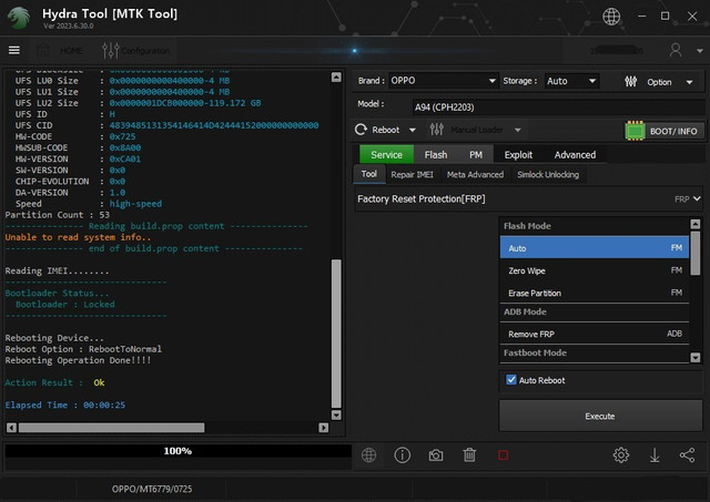

                      Service Function
               Factory Reset Protection[FRP]
                            Auto
  Service         : wdm_usb
  UFS MID         : 0x48
  UFS FWVer       : 0xA043
  UFS ID          : H
  HW-CODE         : 0x725
  HWSUB-CODE      : 0x8A00
  HW-VERSION      : 0xCA01
  SW-VERSION      : 0x0
  DA-VERSION      : 1.0
  Speed           : high-speed
  Bootloader : Locked
Rebooting Device...
Rebooting Operation Done!!!!
Action Result :  Ok
Elapsed Time : 00:00:25
