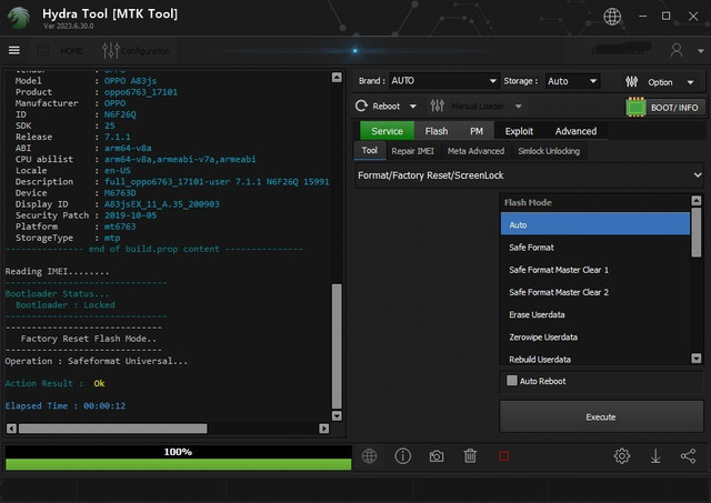

- Service Function
- Format/Factory Reset/ScreenLock
- Auto
                      Service Function
                            Auto
  MTK Port Type   : Flashmode BROM
  FriendlyName    : MediaTek USB Port_V1633 (COM4)
  Device          : /6&299c7bb&0&1
  SymbolicName    : \\?\usb#vid_0e8d&pid_0003#6&299c7bb&0&1#{a5dcbf10-6530-11d2-901f-00c04fb951ed}
  Driver Ver      : 01/22/2015,3.0.1504.0
  Service         : wdm_usb
Openning Port [COM4] Ok
Reading Partition Table ..
  ERAM Size       : 0x0000000000040000-256 KB
  IRAM Size       : 0x00000000C0000000-3 GB
  EMMC RPMB Size  : 0x0000000000400000-4 MB
  EMMC USER Size  : 0x0000000747C00000-29.121 GB
  EMMC CID        : 90014A484247346132A51F70E83715ED - HBG4a2
  HW-CODE         : 0x690
  HWSUB-CODE      : 0x8A00
  HW-VERSION      : 0xCA01
  SW-VERSION      : 0x1
  CHIP-EVOLUTION  : 0x0
  DA-VERSION      : 1.0
  Speed           : high-speed
Partition Count : 42
  Brand          : OPPO
  Vendor         : OPPO
  Model          : OPPO A83js
  Product        : oppo6763_17101
  Manufacturer   : OPPO
  SDK            : 25
  Release        : 7.1.1
  ABI            : arm64-v8a
  CPU abilist    : arm64-v8a,armeabi-v7a,armeabi
  Locale         : en-US
  Description    : full_oppo6763_17101-user 7.1.1 N6F26Q 1599151965 release-keys
  Device         : M6763D
  Display ID     : A83jsEX_11_A.35_200903
  Security Patch : 2019-10-05
  Platform       : mt6763
  StorageType    : mtp
Reading IMEI........
Bootloader Status...
  Bootloader : Locked
   Factory Reset Flash Mode..
Operation : Safeformat Universal...
Action Result :  Ok
Elapsed Time : 00:00:12

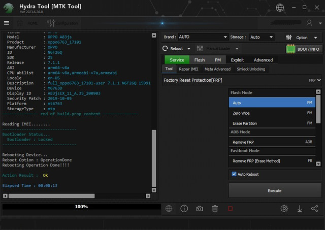

- Select FRP Lock Remove
                      Service Function
               Factory Reset Protection[FRP]
                            Auto
  Service         : wdm_usb
  HW-CODE         : 0x690
  HWSUB-CODE      : 0x8A00
  HW-VERSION      : 0xCA01
  SW-VERSION      : 0x1
  DA-VERSION      : 1.0
  Speed           : high-speed
  Brand          : OPPO
  Vendor         : OPPO
  Model          : OPPO A83js
  Manufacturer   : OPPO
  SDK            : 25
  Release        : 7.1.1
  ABI            : arm64-v8a
  Locale         : en-US
  Device         : M6763D
  Platform       : mt6763
  StorageType    : mtp
  Bootloader : Locked
Rebooting Device...
Reboot Option : OperationDone
Rebooting Operation Done!!!!
Action Result :  Ok
Elapsed Time : 00:00:13
