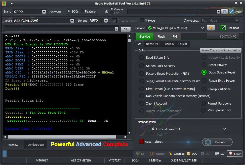

OPPO A83 Dead Fix Unbrick device by hydra tool
Dead boot for oppo a83
Brand : OPPO Model : A83 (CPH1729) Connection : Flash Mode
How To Boot : Power off phone
* BROM Mode : Press VOL +
Connection[WAITING]Found[COM9] Status[Opened]
Identifying Hardware ID
BROM CPUID : 0690 (0000)MT6763T[6763]
BROM HW_SW_VER : 8A00 CA01 0001 0000
SECURE VERSION : 05
BL VERSION : FE
BR Secured : E5[SBC+SDA+SEL]
Security Authorization....
Sending[Oppo_A83.auth] Accepted
Preparing Download Agent..
Download Agent : 6763_F156FF6B3D.bin
MTK_DOWNLOAD_AGENT -HYDRA
MTK_AllInOne_DA_v3.3001.2017/09/22.09:22
Initializing Loader [1]
Sending Loader [1] Accepted
PROTOCOL[NEW] - eMMC
PHONE SYNC[Accepted]
DA Mode : brom
Preloader Initialization....
Parsing preloader_oppo6763_17101.bin
Sending FlashInit Accepted
Initializing Loader [2]
Sending Loader [2]
16
434E5953Accepted
ERAM Size : 0x00000000C0000000 -3 GB
IRAM Size : 0x0000000000040000 -256 KB
eMMC CID : 90014A484247346132A5C7A048B3C405 - HBG4a2
UNICAL RID : 65948ED6274280B6394415AE498CCC2F
DA Speed : high-speed
Done!!!
Reading System Info
Autobackup Partitions
preloader[0x00000000-0x00080000]512 KB Done
-> Renaming Preloader.... preloader_oppo6763_17101.bin
Creating Scatter file... C:\Hydra Tool\\Backup\Auto\__0690--()_100420153000\MT6763T_Android_scatter.txt
nvdata[0x07B88000-0x0BB88000]64 MB Done
nvram[0x1A000000-0x1E000000]64 MB Done
Done!!!
Done!!!
Reading System Info
Operation : Fix Dead From TP-1
Processing...
preloader[0x00000000-0x00080000]512 KB Done... Ok
Elapsed Time : 00:01:24
