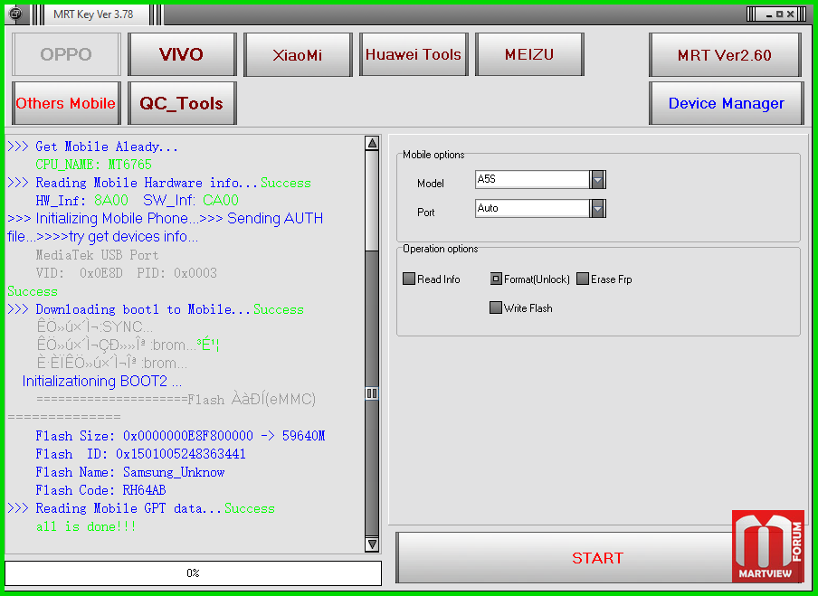

STEPS:
  1. FIRST SELECT A5S MODEL CLICK START BUTTON.​
  2. THEN PRESS (VOL+ & VOL -)
  3. AFTER THAT INSERT USB, WHEN META MODE RELEASE VOL - KEY,
  4. BUT KEEP PRESS VOL + WHEN FORMAT STARTED RELEASE VOL + KEY,
  5. FORMAT DONE.
