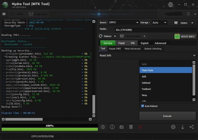

Reading IMEI........
Bootloader Status...
  Bootloader : Locked
Backing up Security..
- preloader(preloader.bin), 512 KB                    = Ok  [preloader_oppo6765_18511.bin]
  *Creating Scatter file... C:\Hydra Tool\Backup\MTKBKUP\0766_84A3DCDD12971AC477FCE766CC33D53\Auto\07072122910\6765_Android_scatter.txt
- pgpt(pgpt.bin), 32 KB                               = Ok
- nvram(nvram.bin), 64 MB                             = Ok
- nvdata(nvdata.bin), 64 MB                           = Ok
- frp(frp.bin), 1024 KB                               = Ok
- protect1(protect1.bin), 8 MB                        = Ok
- protect2(protect2.bin), 8.469 MB                    = Ok
- persist(persist.bin), 48 MB                         = Ok
- proinfo(proinfo.bin), 3 MB                          = Ok
- oppo_custom(oppo_custom.bin), 1024 KB               = Ok
- opporeserve1(opporeserve1.bin), 8 MB                = Ok
- opporeserve2(opporeserve2.bin), 64 MB               = Ok
- nvcfg(nvcfg.bin), 32 MB                             = Ok
- sec1(sec1.bin), 2 MB                                = Ok
- seccfg(seccfg.bin), 8 MB                            = Ok
- lk(lk.bin), 5 MB                                    = Ok
Backup Done!!!
Elapsed Time : 00:00:53

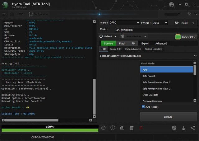

- Factory Reset phone
                      Service Function
              Format/Factory Reset/ScreenLock
                            Auto
  MTK Port Type   : Flashmode BROM
  FriendlyName    : MediaTek USB Port_V1632 (COM12)
  Device          : /5&8b543b&0&4
  SymbolicName    : \\?\usb#vid_0e8d&pid_0003#5&8b543b&0&4#{a5dcbf10-6530-11d2-901f-00c04fb951ed}
  Driver Ver      : 01/22/2015,3.0.1504.0
  Service         : wdm_usb
Openning Port [COM12] Ok
Reading Partition Table ..
  ERAM Size       : 0x000000000003A000-232 KB
  IRAM Size       : 0x00000000C0000000-3 GB
  EMMC RPMB Size  : 0x0000000001000000-16 MB
  EMMC USER Size  : 0x0000000747C00000-29.121 GB
  EMMC CID        : 90014A68423861503E03665A02AC46A7 - hB8aP>
  HW-CODE         : 0x766
  HWSUB-CODE      : 0x8A00
  HW-VERSION      : 0xCA00
  SW-VERSION      : 0x0
  CHIP-EVOLUTION  : 0x0
  DA-VERSION      : 1.0
  Speed           : high-speed
Partition Count : 42
  Vendor         : OPPO
  Manufacturer   : OPPO
  SDK            : 27
  Release        : 8.1.0
  ABI            : arm64-v8a
  CPU abilist    : arm64-v8a,armeabi-v7a,armeabi
  Locale         : en-US
  Description    : full_oppo6765_18511-user 8.1.0 O11019 1616154336 release-keys
  Security Patch : 2021-04-05
  StorageType    : mtp
  Bootloader : Locked
   Factory Reset Flash Mode..
Operation : Safeformat Universal...
Rebooting Device...
Rebooting Operation Done!!!!
Action Result :  Ok
Elapsed Time : 00:00:09
