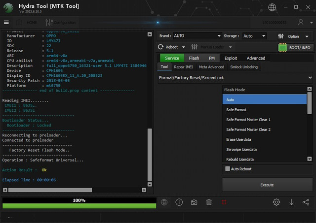

- Format/Factory Reset/ScreenLock
                      Service Function
                            Auto
  MTK Port Type   : Flashmode BROM
  FriendlyName    : MediaTek USB Port_V1632 (COM30)
  Device          : /7&d3e40fc&0&4
  SymbolicName    : \\?\usb#vid_0e8d&pid_0003#7&d3e40fc&0&4#{a5dcbf10-6530-11d2-901f-00c04fb951ed}
  Driver Ver      : 01/22/2015,3.0.1504.0
  Service         : wdm_usb
Openning Port [COM30] Ok
Reading Partition Table ..
  ERAM Size       : 0x0000000000038000-224 KB
  IRAM Size       : 0x00000000C0000000-3 GB
  EMMC RPMB Size  : 0x0000000000400000-4 MB
  EMMC USER Size  : 0x0000000747C00000-29.121 GB
  EMMC CID        : 90014A484247346132A455168A07B3CF - HBG4a2
  HW-CODE         : 0x6750
  HWSUB-CODE      : 0x8A00
  HW-VERSION      : 0xCB00
  SW-VERSION      : 0x1
  CHIP-EVOLUTION  : 0x0
  DA-VERSION      : 1.0
  Speed           : full-speed
Reconnecting to preloader...
Connected to preloader
Partition Count : 38
  Brand          : OPPO
  Vendor         : OPPO
  Model          : CPH1605
  Product        : oppo6750_16321
  Manufacturer   : OPPO
  SDK            : 22
  Release        : 5.1
  ABI            : arm64-v8a
  CPU abilist    : arm64-v8a,armeabi-v7a,armeabi
  Description    : full_oppo6750_16321-user 5.1 LMY47I 1584946680 release-keys
  Device         : CPH1605
  Display ID     : CPH1605EX_11_A.20_200323
  Security Patch : 2018-03-05
  Platform       : mt6750
Reading IMEI........
IMEI1 : 863526*********
IMEI2 : 863526*********
Bootloader Status...
  Bootloader : Locked
   Factory Reset Flash Mode..
Operation : Safeformat Universal...
Action Result :  Ok
Elapsed Time : 00:00:06

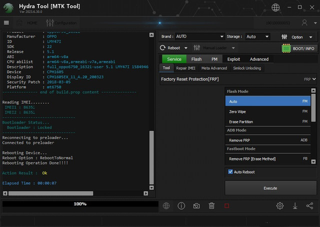

- Factory Reset Protection[FRP]
              Service Function
                            Auto
  Service         : wdm_usb
  HW-CODE         : 0x6750
  HWSUB-CODE      : 0x8A00
  HW-VERSION      : 0xCB00
  SW-VERSION      : 0x1
  DA-VERSION      : 1.0
  Speed           : full-speed
  Brand          : OPPO
  Vendor         : OPPO
  Model          : CPH1605
  Manufacturer   : OPPO
  SDK            : 22
  Release        : 5.1
  ABI            : arm64-v8a
  Device         : CPH1605
  Platform       : mt6750
  Bootloader : Locked
Rebooting Device...
Rebooting Operation Done!!!!
Action Result :  Ok
Elapsed Time : 00:00:07
