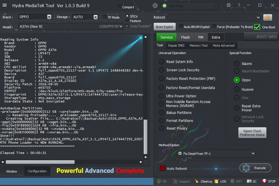

Oppo A37m Fixed from Dead by Hydra Tool
546
Brand : OPPO Model : A37m (Neo 9) Connection : Flash Mode
How To Boot : Power off phone
* BROM Mode : Press VOL + or Press VOL -+
FriendlyName :MediaTek USB Port_V1632 (COM13)
SymbolicName :\??\USB#VID_0E8D&PID_0003#5&18e4146f&0&2#{a5dcbf10-6530-11d2-901f-00c04fb951ed}
Handshaking...Ok
Identifying Hardware ID.....
BROM CPUID : 0326MT6750T[6755]
BROM HW_SW_VER : 8A00 CB00 0001 0000
FUSEID : 42040000
SECURE VERSION : 05
BL VERSION : FE
BR Secured : 00
NORMAL BOOT
Preparing Download Agent..
DA : 6755_SWSEC_2B23567CB4.bin
Ver : MTK_AllInOne_DA_v3.3001.00.00
Init : Loader [1]
Sending : Accepted
Identifying Protocol...
C0
Protocol : New
Synchronization...
SYNCSYNC
Mode : brom
Preloader Initialization...
Parsing preloader_oppo6750_15127.bin
Init : Accepted
Execute Secondary Loader
Init : Loader [2]
Executing : SYNC
UNIQUE ID : 96CED7258496456CCBC0433A1B4B47FA
IRAM Size : 0x0000000080000000 -2 GB
eMMC USER : 0x00000003AB400000 -14.676 GB
eMMC CID : 90014A484147346132A550DADAA043D1 - HAG4a2
DA Speed :
Change to HIGH SPEED...
Port Identification :DA_HIGHSPEED_VCOM
FriendlyName :MediaTek DA USB VCOM (Android) (COM44)
SymbolicName :\??\USB#VID_0E8D&PID_2001#5&18e4146f&0&2#{a5dcbf10-6530-11d2-901f-00c04fb951ed}
Reading System Info
Brand : OPPO
Vendor : OPPO
Model : OPPO A37m
SDK : 22
Release : 5.1
ABI : arm64-v8a
Description : full_oppo6750_15127-user 5.1 LMY47I 1488448383 dev-keys
Device : A37
Board : full_oppo6750_15127
Display ID : A37m_11_A.18_170302
Security Patch : 2016-09-05
Platform : mt6750
FRPPST : /dev/block/platform/mtk-msdc.0/by-name/frp
Fingerprint : OPPO/A37m/A37:5.1/LMY47I/1474447292:user/release-keys
StorageType : mtp,mass_storage
Autobackup Partitions
-> Renaming Preloader.... preloader_oppo6750_15127.bin
Creating Scatter file... C:\hydratool\\Backup\Auto\0326_OPPO_A37m_A37_5.1_LMY47I_1474447292_030721183809\MT6750T_Android_scatter.txt
-frp[0x03F88000]1024 KB ->frp.bin...Ok
-nvdata[0x04088000]32 MB ->nvdata.bin...Ok
-nvram[0x0CF00000]5 MB ->nvram.bin...Ok
Done!!!
Elapsed Time : 00:00:31
