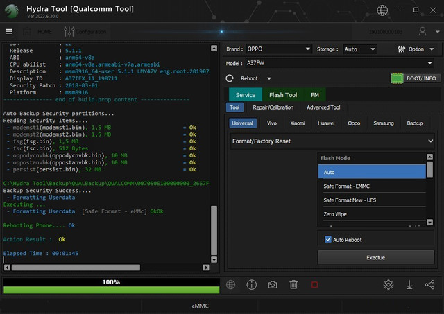

Oppo A37f Format/Factory Reset with Hydra Tool
                   Qualcomm Service Tool
                            Auto
PreOperation Configuration
Brand : OPPO Model : A37FW Storage : Auto
Loader: 007050E100000000_99c8c13e374c34d8_959439aa_QUALCOMM_LENOVO_peek_8916.fhprg
Port  : Auto
FriendlyName :Qualcomm HS-USB QDLoader 9008 (COM4)
SymbolicName :\\?\usb#vid_05c6&pid_9008#5&2551f1d&0&1#{a5dcbf10-6530-11d2-901f-00c04fb951ed}
Driver Ver   :08/02/2017,2.1.2.7
Getting device info. [Connected].....
Serial No.: 0x2667F4C1
HW_ID     : 007050E100000000
MSM ID    : 0x007050E1, MSM8916-Qualcomm Snapdragon 410 /HAAAANAZA
MODEL_ID  : 0x0000
OEM_ID    : 0x0000 - QUALCOMM
PBL Ver   : 00000000
PK HASH   : cc3153a80293939b90d02d3bf8b23e0292e452fef662c74998421adad42a380f
Firehose Loader[007050E100000000_99c8c13e374c34d8_959439aa_QUALCOMM_LENOVO_peek_8916.fhprg]
  Header Type    : OLD
  TargetMSM      : 8916
  Tag            : _peek
  Version        : 3
  Code_size      : 96
  Signature_size : 256
  fhVendor       : LENOVO
  Vendor         : QUALCOMM
  OEM_ID         : 0000
  MODEL_ID       : 0000
  SW_ID          : 0000000000000003
  APP_ID         :
  pk_hash        : 99c8c13e374c34d8f9afb065ea4c733e6b1b21cbc5a78705f041eb24acdd5fe5
  OEM_VERSION    :
  IMAGE_VARIANT  :
  QC_VERSION     :
SaharaBoot... Ok
Sending .....Ok
Connecting to Firehose...
Ping... Ok
Configuration[FHProt_Auto].......
Identifying Chip....
Ok
Chip Configuration :
MemoryName : eMMC
MaxXMLSizeInBytes : 4096
TargetName : 8916
Version : 1
Protocol : Universal
Running : Ok
Reading GPT[3]
          Drive [0] 40 Items
          Drive [1] 0 Items
          Drive [2] 4 Items
build.prop
  Brand          : OPPO
  Vendor         : OPPO
  Model          : A37f
  Product        : A37f
  Manufacturer   : OPPO
  SDK            : 22
  Release        : 5.1.1
  ABI            : arm64-v8a
  CPU abilist    : arm64-v8a,armeabi-v7a,armeabi
  Description    : msm8916_64-user 5.1.1 LMY47V eng.root.20190711.032745 release-keys
  Display ID     : A37fEX_11_190711
  Security Patch : 2018-03-01
  Platform       : msm8916
Auto Backup Security partitions...
Reading Security Items....
- modemst1(modemst1.bin), 1,5 MB                      = Ok
- modemst2(modemst2.bin), 1,5 MB                      = Ok
- fsg(fsg.bin), 1,5 MB                                = Ok
- fsc(fsc.bin), 512 Bytes                             = Ok
- oppodycnvbk(oppodycnvbk.bin), 10 MB                 = Ok
- oppostanvbk(oppostanvbk.bin), 10 MB                 = Ok
- persist(persist.bin), 32 MB                         = Ok
C:\Hydra Tool\Backup\QUALBackup\QUALCOMM\007050E100000000_2667F4C1\Auto_Backup\0707445594419
Backup Security Success....
- Formatting Userdata
Executing ...
- Formatting Userdata  [Safe Format - eMMc] OkOk
Rebooting Phone.... Ok
Action Result :  Ok
Elapsed Time : 00:01:45
