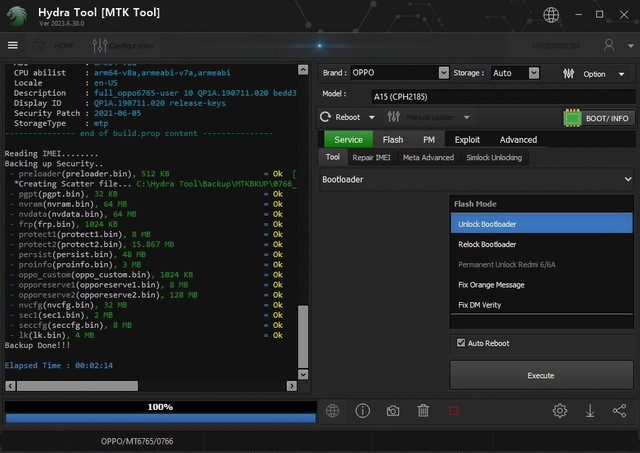

Reading Partition Table ..
Partition Count : 49
  Product        : oppo6765
  SDK            : 29
  Release        : 10
  ABI            : arm64-v8a
  CPU abilist    : arm64-v8a,armeabi-v7a,armeabi
  Locale         : en-US
  Description    : full_oppo6765-user 10 QP1A.190711.020 bedd37e98646d3a1 release-keys
  Display ID     : QP1A.190711.020 release-keys
  Security Patch : 2021-06-05
  StorageType    : mtp
Reading IMEI........
Backing up Security..
- preloader(preloader.bin), 512 KB                    = Ok  [preloader_oppo6765.bin]
  *Creating Scatter file... C:\Hydra Tool\Backup\MTKBKUP\0766_60D1A60F6D09849A41414127173\Auto\070723162558\6765_Android_scatter.txt
- pgpt(pgpt.bin), 32 KB                               = Ok
- nvram(nvram.bin), 64 MB                             = Ok
- nvdata(nvdata.bin), 64 MB                           = Ok
- frp(frp.bin), 1024 KB                               = Ok
- protect1(protect1.bin), 8 MB                        = Ok
- protect2(protect2.bin), 15.867 MB                   = Ok
- persist(persist.bin), 48 MB                         = Ok
- proinfo(proinfo.bin), 3 MB                          = Ok
- oppo_custom(oppo_custom.bin), 1024 KB               = Ok
- opporeserve1(opporeserve1.bin), 8 MB                = Ok
- opporeserve2(opporeserve2.bin), 128 MB              = Ok
- nvcfg(nvcfg.bin), 32 MB                             = Ok
- sec1(sec1.bin), 2 MB                                = Ok
- seccfg(seccfg.bin), 8 MB                            = Ok
- lk(lk.bin), 4 MB                                    = Ok
Backup Done!!!
Elapsed Time : 00:02:07

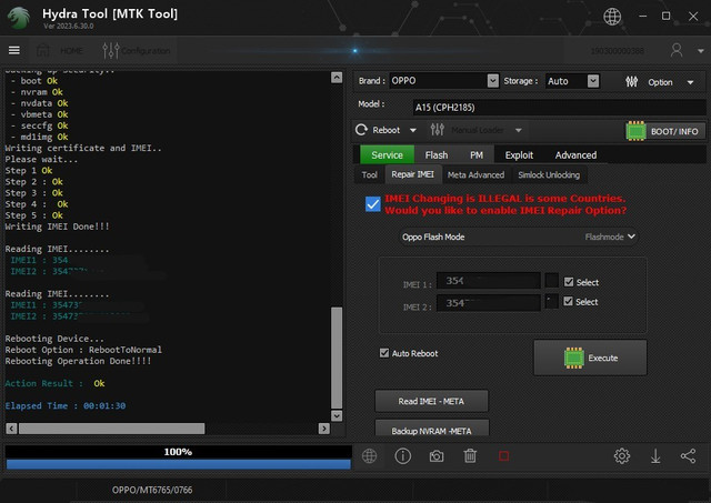

- Repair Phone Oppo Flash Mode
                ***IMEI REPAIR FUNCTION****
                      Oppo Flash Mode
  MTK Port Type   : Flashmode BROM
  FriendlyName    : MediaTek USB Port (COM139)
  Device          : /5&3a808860&0&6
  SymbolicName    : \\?\usb#vid_0e8d&pid_0003#5&3a808860&0&6#{a5dcbf10-6530-11d2-901f-00c04fb951ed}
  Driver Ver      : 07/22/2022,3.0.1511.0
  Service         : wdm_usb
Openning Port [COM139] Ok
  ERAM Size       : 0x000000000003A000-232 KB
  IRAM Size       : 0x0000000080000000-2 GB
  EMMC RPMB Size  : 0x0000000001000000-16 MB
  EMMC USER Size  : 0x0000000747C00000-29.121 GB
  EMMC CID        : 90014A68423861503E03001F0AD4B7A9 - hB8aP>
  HW-CODE         : 0x766
  HWSUB-CODE      : 0x8A00
  HW-VERSION      : 0xCA00
  SW-VERSION      : 0x0
  CHIP-EVOLUTION  : 0x0
  DA-VERSION      : 1.0
  Speed           : high-speed
  Product        : oppo6765
  SDK            : 29
  Release        : 10
  ABI            : arm64-v8a
  Locale         : en-US
  StorageType    : mtp
Oppo Flashmode IMEI Repair
Oppo Method 1
- boot Ok
- nvram Ok
- nvdata Ok
- vbmeta Ok
- seccfg Ok
- md1img Ok
Writing certificate and IMEI..
Please wait...
Step 1 Ok
Step 2 : Ok
Step 3 : Ok
Step 4 :  Ok
Step 5 : Ok
Writing IMEI Done!!!
IMEI1 : 3547************
IMEI2 : 3547***********
IMEI1 : 35473***********
IMEI2 : 35473***********
Rebooting Device...
Rebooting Operation Done!!!!
Action Result :  Ok
Elapsed Time : 00:01:30
