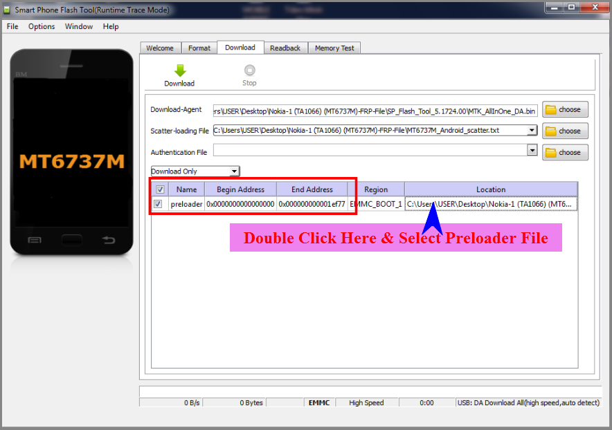

Step-1
Open SPFT & Select Scatter File
Select Preloader File

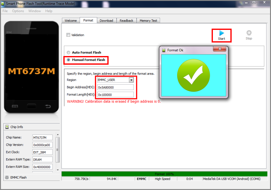

Step-2
Select Manuel Format
Put Address
Click On Start
FRP Reset Done
