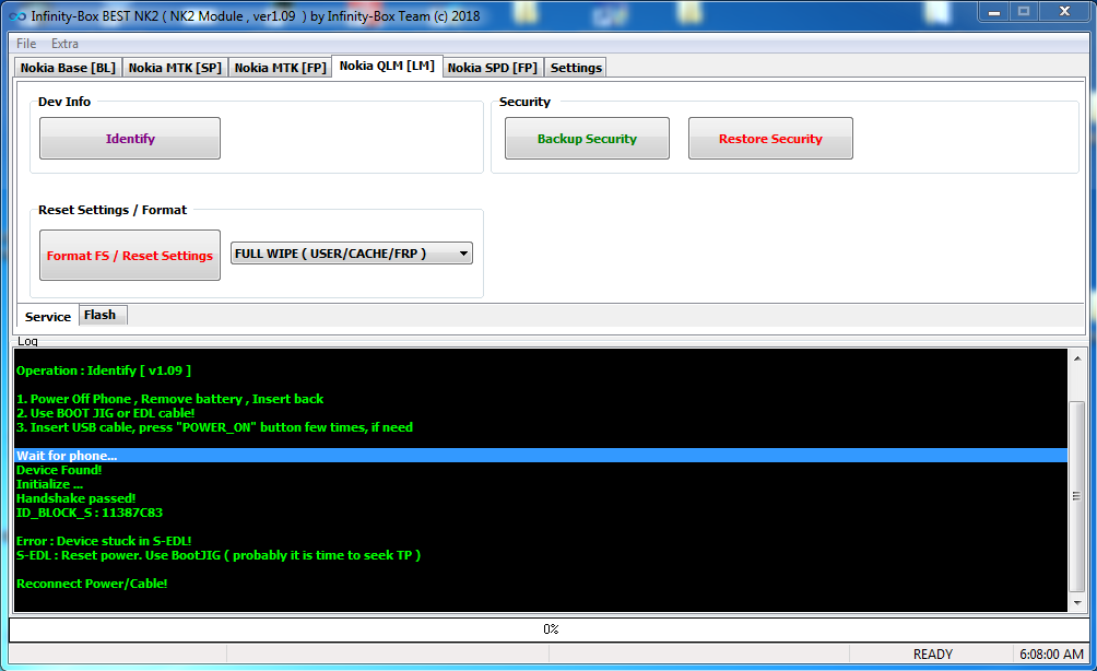

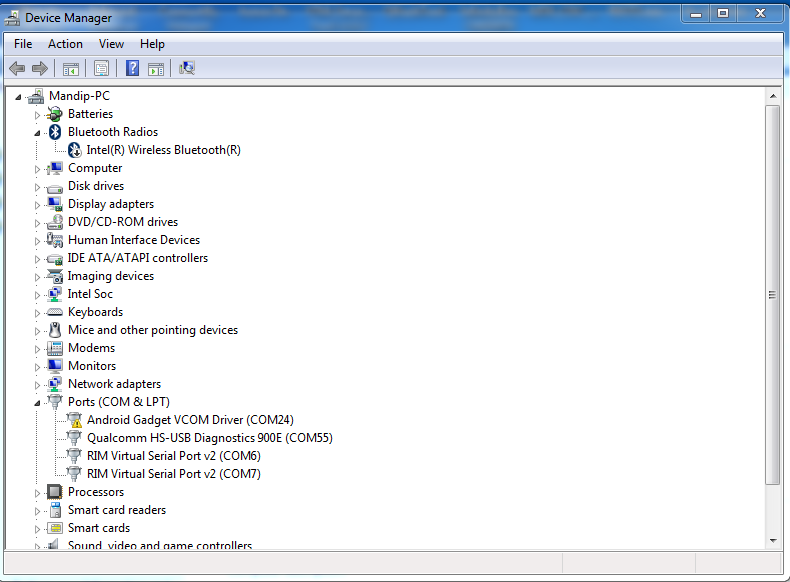

now i flash with Nokia__Dynamo_00WW__E1M__600WW Using Infinity best Nk2 device again won't turn on. please help me.
now device not connect in edl 9008 qdloader port. device connect in Diagnostic port 900E
How to recover Qualcomm qdloader 9008 port Again
Please Help me. it ll be humble Thanks.

you must check emmc health 99% its emmc issue
