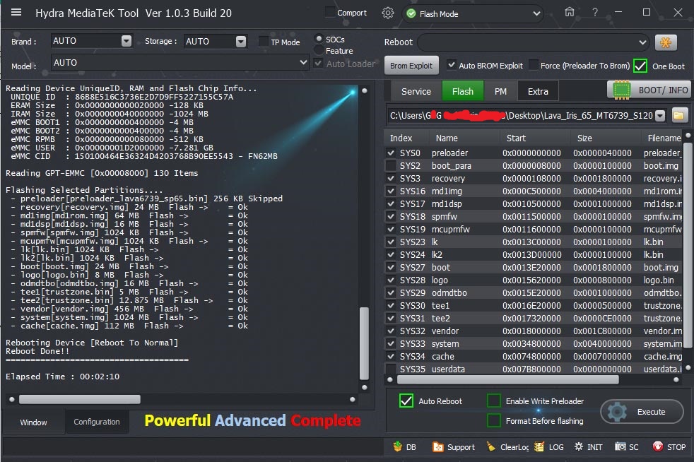

MTK Device Lava Iris 65 super fast and successfully Flashed by Hydra Tool
Hydra MediaTeK Tool Ver 1.0.3 Build 20
Windows 10 (Version 10.0, Build 19042, 32-bit Edition)
Intel(R) Core(TM)2 Duo CPU E7400 @ 2.80GHz
Intel(R) G41 Express Chipset (Microsoft Corporation - WDDM 1.1)
Ram Installed : 3 GB
Windows Access Right Admin
Software Run As Admnistrator
******* Dongle Info *******
Version : Hydra Tool v 1.2
Serial : *************
Initialize : OKAY
Status : Activated
Life : 0 [0-0-0-0-0]
Brand : AUTO Model : AUTO Connection : Flash Mode
How To Boot : Power off phone
* BROM Mode : Press VOL + or Press VOL -+
Port Identification :Flashmode Preloader
FriendlyName :MediaTek PreLoader USB VCOM_V1632 (Android) (COM70)
SymbolicName :\??\USB#VID_0E8D&PID_2000#5&a713703&2&3#{a5dcbf10-6530-11d2-901f-00c04fb951ed}
Handshaking...Ok
Identifying Hardware ID.....
BROM CPUID : 0699MT6739[6739]
FUSEID : 00000000
SECURE VERSION : 00
BL VERSION : 03
BR Secured : 00
Preparing Download Agent..
DA : 6739.bin
Ver : MTK_AllInOne_DA_v3.3001.2020-11-03.22:07_536568
Init : Loader [1]
Sending : Accepted
Identifying Protocol...
Protocol : New
Synchronization...SYNC
Mode : preloader
Execute Secondary Loader
Init : Loader [2]
Executing : SYNC
UNIQUE ID : 86B8E516C3736E2D7D9FF5227155C57A
ERAM Size : 0x0000000000020000 -128 KB
IRAM Size : 0x0000000040000000 -1024 MB
eMMC RPMB : 0x0000000000080000 -512 KB
eMMC USER : 0x00000001D2000000 -7.281 GB
eMMC CID : 150100464E36324D4203768B90EE5543 - FN62MB
DA Speed : high-speed
Reading System Info
Brand : LAVA
Vendor : LAVA
Model : iris65
SDK : 27
Release : 8.1.0
ABI : armeabi-v7a
Locale : en-US
Description : full_lava6739_sp65-user 8.1.0 O11019 1521873769 dev-keys
Device : iris65
Display ID : LAVA_iris65_TH_S105_18C24
Security Patch : 2018-03-05
Fingerprint : alps/full_lava6739_sp65/lava6739_sp65:8.1.0/O11019/1521873769:user/dev-keys
StorageType : mtp
Userdata State : Encrypted
Autobackup Partitions
-> Renaming Preloader.... preloader_lava6739_sp65.bin
Creating Scatter file... C:\Program Files\HydraTool\\Backup\Auto\0699_alps_full_lava6739_sp65_lava6739_sp65_8.1.0_O11019_1521873769_user_dev-keys_041421103855\MT6739_Android_scatter.txt
-frp[0x02D88000]1024 KB ->frp.bin...Ok
-nvdata[0x03688000]32 MB ->nvdata.bin...Ok
-nvram[0x10700000]5 MB ->nvram.bin...Ok
Done!!!
- preloader[preloader_lava6739_sp65.bin] 256 KB Skipped
- recovery[recovery.img] 24 MB Flash -> = Ok
- md1img[md1rom.img] 64 MB Flash -> = Ok
- md1dsp[md1dsp.img] 16 MB Flash -> = Ok
- spmfw[spmfw.img] 1024 KB Flash -> = Ok
- mcupmfw[mcupmfw.img] 1024 KB Flash -> = Ok
- lk[lk.bin] 1024 KB Flash -> = Ok
- lk2[lk.bin] 1024 KB Flash -> = Ok
- boot[boot.img] 24 MB Flash -> = Ok
- logo[logo.bin] 8 MB Flash -> = Ok
- odmdtbo[odmdtbo.img] 16 MB Flash -> = Ok
- tee1[trustzone.bin] 5 MB Flash -> = Ok
- tee2[trustzone.bin] 12.875 MB Flash -> = Ok
- vendor[vendor.img] 456 MB Flash -> = Ok
- system[system.img] 1024 MB Flash -> = Ok
- cache[cache.img] 112 MB Flash -> = Ok
Reboot Done!!
Elapsed Time : 00:02:10
