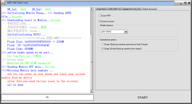

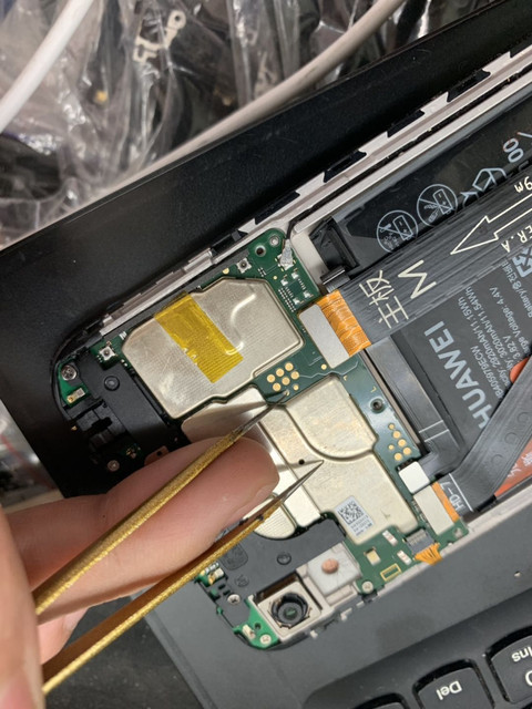

Step1 : Need to open a Mobile phones,and use TP to GND for boot Phone
Step 2: use mrt hw flash tool;backup oeminfo and remove Start Wizard

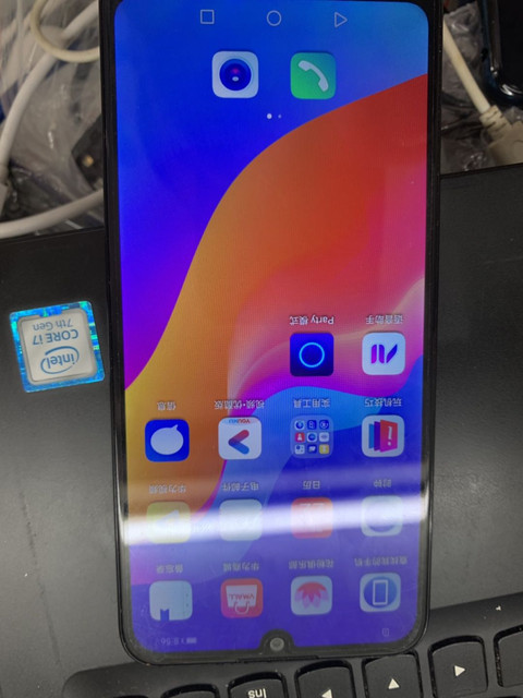

Step 3 : then power on mobile you will see a lot app lost in the mobile phones
then power off it,and do the step 4

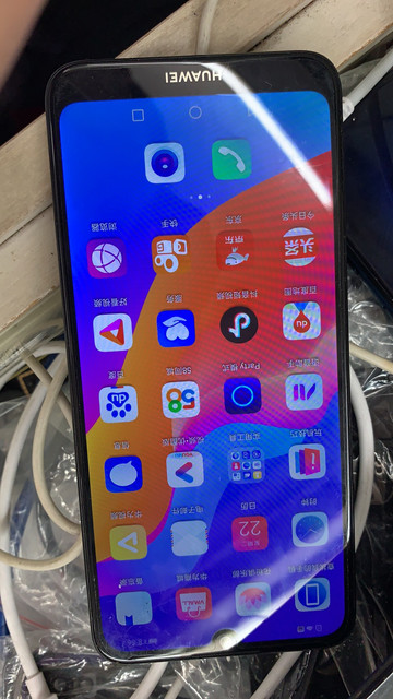

after done,power on your phone
all the lost app come back
and you can in the setting login your account enable find my device
