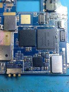

micromax d320
dead
no mtk port

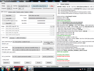

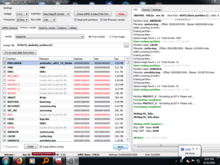

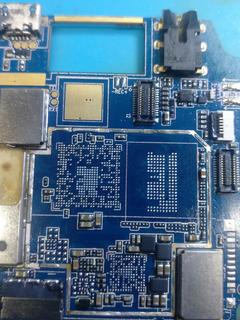

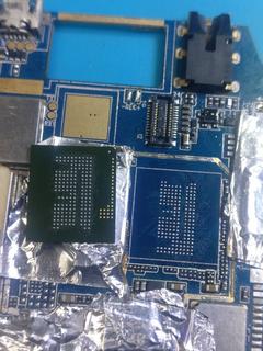

previous technician heat all power cpu and emmc

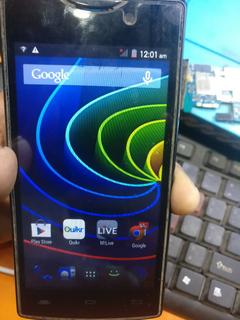

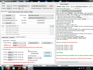

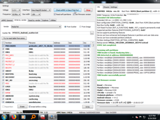

reboll all but not power on finally reprogramme emmc with easy jtag and job done.

dead
no mtk port
