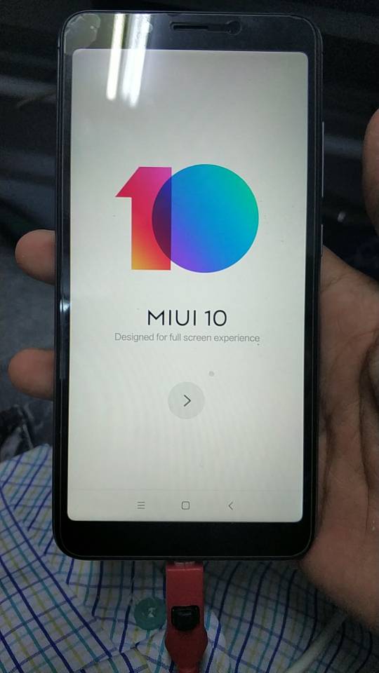

Mi 6x IMEI REPAIR DONE AND DEAD REPAIR DONE
1-BACKUP EFS
2- FULL ERASE INCLUDE WITH BOOT ON UFI SPECIAL TASK
3- FLASH MIUI 10.2.0 LATEST
4 - BOOTUP NO IMEI RESTORE EFS .
5 BYPASS ACCOUNT LOCK FROM ADB
Sent from my MI 6 using Tapatalk

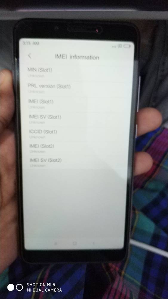

unsucess with mi max 3 nitrogen
can you help me another sulution
thank you

Do u backup original efs ? Also u can write qcn enable diag if diag fail root and open diag .

i used backup and erase nv&efs via ufi sucessful , imei and baseband unknown , restore backup file complete but baseband & imei not restore
qcn not active because diag unenable on max 3 lock boot
Uploads here your backup efs file
