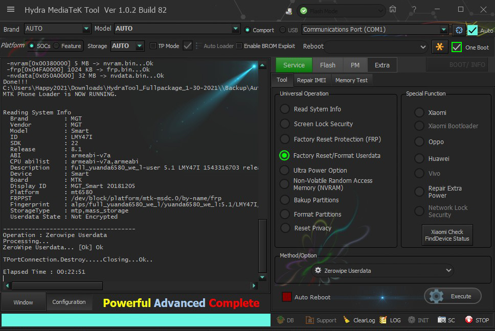

MGT Smart Zero wipe FRP successfully removed by Hydra Tool
Brand : AUTO Model : AUTO Connection : Flash Mode
Connection
-Please wait...
-Connect Phone...
-Found...
-PreLoader...[COM8]
TPortConnection.Create...(COM8)..Opening...Ok
Handshaking...Ok
Identifying Hardware ID.....
BROM CPUID : 6580MT6580[6580]
Handshaking...
FUSEID : 00000000
FUSEID : 00000000
SECURE VERSION : 00
BL VERSION : 00
BR Secured : 00
NORMAL BOOT
Preparing Download Agent..
DA : 6580.bin
Ver : MTK_AllInOne_DA_v3.3001.2020-11-03.22:07_536568
Init : Loader [1]
Sending : Accepted
Identifying Protocol...
Protocol : Old - eMMC
0000000000000000000000000000
PRMMCCID : 1501004B3758564D4201AE61D08012BF
Init Configuration
Running DA 4.2 on BBID : 0x9C Ok
Initializing Loader [2]
Sending Loader [2] Accepted
Reading Flashchip data....
eMMC RPMB : 0x0000000000080000 -512 KB
eMMC USER : 0x00000001D2000000 -7.281 GB
ERAM Size : 0x0000000040000000 -1024 MB
IRAM Size : 0x0000000000020000 -128 KB
UNICAL RID : 039EC4DBB04C89A87613282B633FBF49
eMMC CID : 4B0001154D56583761AE0142BF1280D0
Change to HIGH SPEED...
5A
Connection
-Please wait...
-Found...[COM14]
Reading Partition Table
SIZE[0x00000738] 21 Items > Done
Reading System Info
Brand : MGT
Vendor : MGT
Model : Smart
SDK : 22
Release : 8.1
ABI : armeabi-v7a
Description : full_yuanda6580_we_l-user 5.1 LMY47I 1543316703 release-keys
Device : Smart
Board : MTK
Display ID : MGT_Smart 20181205
Platform : mt6580
FRPPST : /dev/block/platform/mtk-msdc.0/by-name/frp
Fingerprint : alps/full_yuanda6580_we_l/yuanda6580_we_l:5.1/LMY47I/1543316703:user/release-keys
StorageType : mtp,mass_storage
Autobackup Partitions
-preloader[0x00000000] 512 KB -> preloader.bin...Ok
-> Renaming Preloader.... preloader_yuanda6580_we_l.bin
Creating Scatter file... C:\Users\DipendarPathak\Downloads\HydraTool_Fullpackage_1-30-2021\\Backup\Auto\MGT_Smart_6580-mt6580-8.1_MGT_Smart 20181205_180221200332\MT6580_Android_scatter.txt
-nvram[0x00380000] 5 MB -> nvram.bin...Ok
-frp[0x04FA0000] 1024 KB -> frp.bin...Ok
-nvdata[0x050A0000] 32 MB -> nvdata.bin...Ok
Done!!!
C:\Users\Happy2021\Downloads\HydraTool_Fullpackage_1-30-2021\\Backup\Auto\MGT_Smart_6580-mt6580-8.1_MGT_Smart 20181205_180221200332
Reading System Info
Brand : MGT
Vendor : MGT
Model : Smart
SDK : 22
Release : 8.1
ABI : armeabi-v7a
Device : Smart
Board : MTK
Platform : mt6580
Operation : Zerowipe Userdata
Processing...
ZeroWipe Userdata... [Ok] Ok
Elapsed Time : 00:22:51
