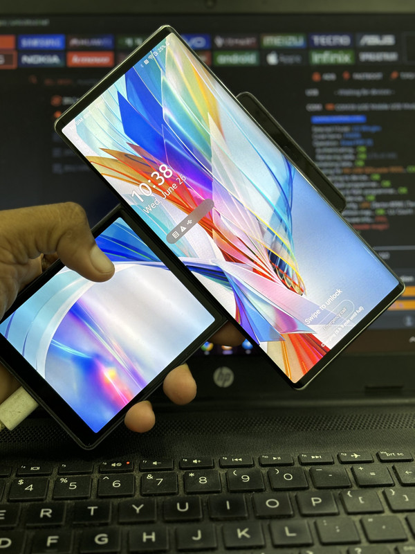

LG Wing LM-100EMW FRP Reset Done successfully

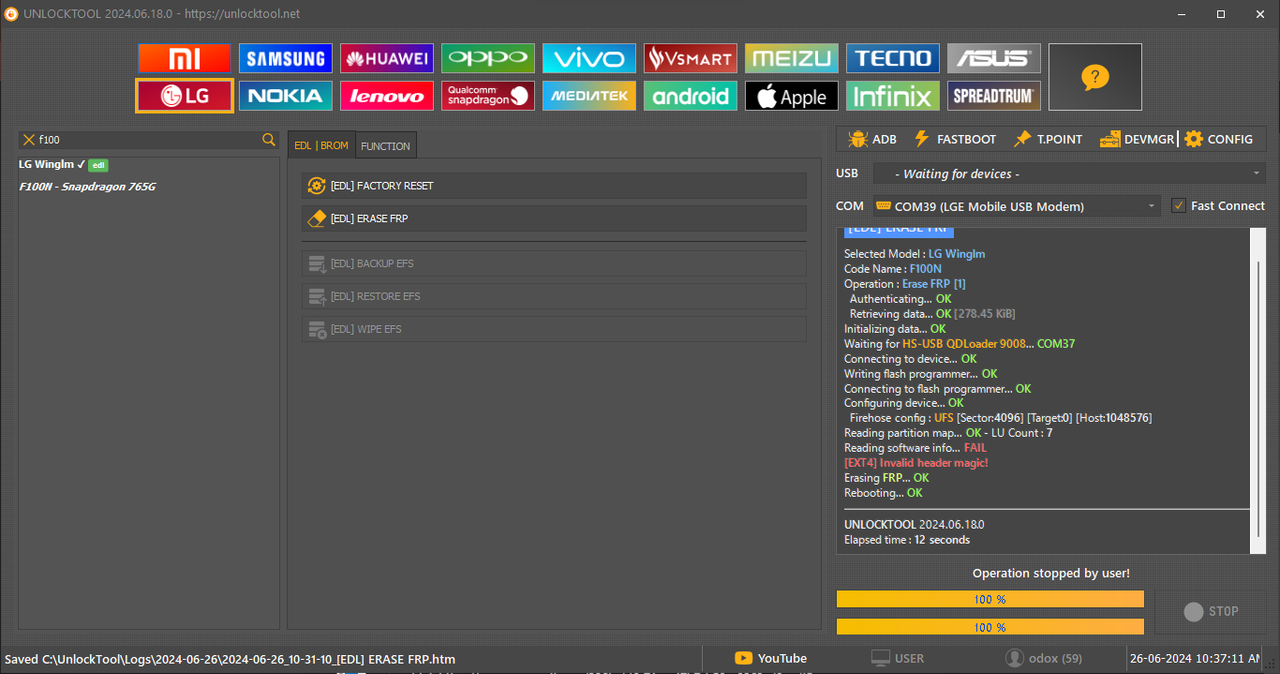

RESET FRP
>> Open Unlocktool
>> Select LG
>> Select model as LG winglm F100N
>> goto EDL tab
>> Click "[EDL] ERASE FRP"
LOG:

LOG:
[EDL] ERASE FRP Selected Model : LG Winglm
Code Name : F100N
Operation : Erase FRP [1]
Authenticating... OK
Retrieving data... OK [278.45 KiB]
Initializing data... OK
Waiting for HS-USB QDLoader 9008... COM37
Connecting to device... OK
Writing flash programmer... OK
Connecting to flash programmer... OK
Configuring device... OK
Firehose config : UFS [Sector:4096] [Target:0] [Host:1048576]
Reading partition map... OK - LU Count : 7
Reading software info... FAIL
[EXT4] Invalid header magic!
Erasing FRP... OK
Rebooting... OK
UNLOCKTOOL 2024.06.18.0
