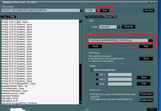

LG G3(D856) Hang Logo Fix With UMT King
Connect Phone With Download Mode, Volume UP Insert USB Cable , Scan Port,
and Select KDZ Firmware
Flash Log :
Port : COM319 : LGE Mobile USB Serial Port (COM319)
Baud Rate : 115200 - Auto
Device : LG Automatic
Operation : Write Firmware
Opening Port...OK
Reading Information...OK
Model : LG-D856
PID : SM03S150601003367
IMEI : 3xxxxxxxxxxxxxxx
Firmware : D85620b
Factory Ver. : LGD856AT-00-V20b-CIS-XX-NOV-20-2015-32G+0
LAF Ver. : 1.1
Chipset : msm8974
Operator : OPEN
Country : CIS
Memory ID : 032GE4
Capacity : 29.12 GB
Battery : 16%
Analyzing KDZ Firmware...
Loading DZ Firmware...Loaded 37 Partition(s)
Model : LG-D856
Version : D85630c
Sector Size : 0x0000
Reading Partition Table...OK
Setting Parameters...Done
Formatting [userdata]...Done
Formatting [encrypt]...Done
Writing 01 of 37 [PrimaryGPT]...Done
Writing 02 of 37 [modem]...Done
Writing 03 of 37 [sbl1]...Done
Writing 04 of 37 [dbi]...Done
Writing 05 of 37 [aboot]...Done
Writing 06 of 37 [rpm]...Done
Writing 07 of 37 [tz]...Done
Writing 08 of 37 [boot]...Done
Writing 09 of 37 [persist]...Done
Writing 10 of 37 [recovery]...Done
Writing 11 of 37 [rct]...Done
Writing 12 of 37 [laf]...Done
Writing 13 of 37 [factory]...Done
Writing 14 of 37 [system]...Done
Writing 15 of 37 [system]...Done
Writing 16 of 37 [system]...Done
Writing 17 of 37 [system]...Done
Writing 18 of 37 [system]...Done
Writing 19 of 37 [system]...Done
Writing 20 of 37 [system]...Done
Writing 21 of 37 [system]...Done
Writing 22 of 37 [system]...Done
Writing 23 of 37 [system]...Done
Writing 24 of 37 [system]...Done
Writing 25 of 37 [system]...Done
Writing 26 of 37 [system]...Done
Writing 27 of 37 [system]...Done
Writing 28 of 37 [system]...Done
Writing 29 of 37 [system]...Done
Writing 30 of 37 [system]...Done
Writing 31 of 37 [system]...Done
Writing 32 of 37 [system]...Done
Writing 33 of 37 [system]...Done
Writing 34 of 37 [system]...Done
Writing 35 of 37 [system]...Done
Writing 36 of 37 [system]...Done
Writing 37 of 37 [BackupGPT]...Done
Formatting [mpt]...Done
Finalizing Parameters...Done
Rebooting Device...Done
Operation Finished.
Time taken: 07:04
[UltimateLG v0.4]
Log Saved to Logs\200125_173848.log
