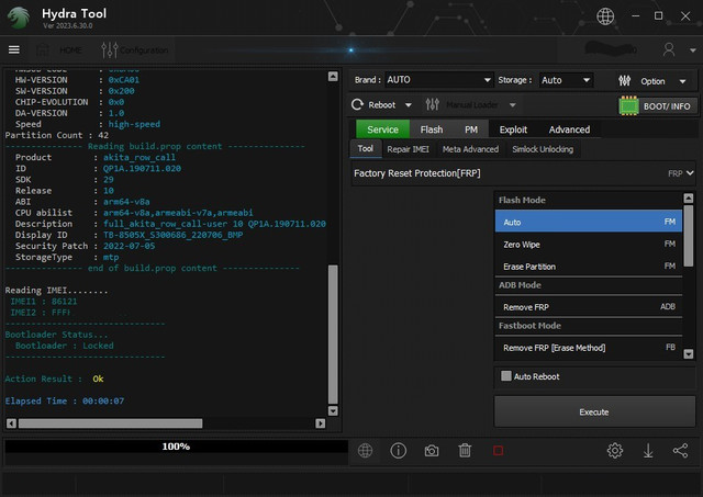

Lenovo TB-8505X FRP Lock Remove With Hydra Tool
- First Keep press boot info
To Enable BROM  Mode :
     Method 1    - Bootkey (Vol + - Power) or any combination
     Method 2    - Enable Preloader to brom(crashing Method)
     Method 3    - Test Point Data0 + ground
To Enable Preloader  Mode :
     Method 1    - Just Insert cable
  MTK Port Type   : Flashmode BROM
  FriendlyName    : MediaTek USB Port_V1632 (COM12)
  Device          : /6&2e01eb57&0&3
  SymbolicName    : \\?\usb#vid_0e8d&pid_0003#6&2e01eb57&0&3#{a5dcbf10-6530-11d2-901f-00c04fb951ed}
  Driver Ver      : 01/22/2015,3.0.1504.0
  Service         : wdm_usb
Openning Port [COM12] Ok
Handshaking...Ok
  HwCode          : 0717 {MT6761/MT6762/MT3369/MT8766B}
  Hwver           : 0000
  Target config   : E5
  SBC             : 01 (True)
  SLA             : 00 (False)
  DAA             : 04 (True)
  SWJTAG          : 04 (True)
  EPP             : 00 (False)
  CERT            : 00 (False)
  MEMREAD         : 20 (True)
  MEMWRITE        : 40 (True)
  CMD_C8          : 80 (True)
  Connection      : BROM
  HW Subcode      : 8A00
  HW Subcode      : CA01
  SW Ver          : 0200
  ME_ID           : 93D1A6B02D18898A1A09FC266ADD9D6D
  SOC_ID          : D3F6399C6DB30E02435157090A7871E263CC1276D3700D8BBFDC647E31E1A33E
Exploiting Device...
Successfully Exploited..
Handshaking...Ok
Starting to dump...
Prel Size : 0x00037F68
Successfully dump preloader..  [C:\Hydra Tool\Boot\PreloaderDump\preloader_akita_row_call.bin]
  Target config   : 00
  SBC             : 00 (False)
  SLA             : 00 (False)
  DAA             : 00 (False)
  SWJTAG          : 00 (False)
  EPP             : 00 (False)
  CERT            : 00 (False)
  MEMREAD         : 00 (False)
  MEMWRITE        : 00 (False)
  CMD_C8          : 00 (False)
  Connection      : BROM
Patching da2 ... Ok
Uploading Stage 1....
Jumping to 0x00200000 Ok 0xC0
Successfully received DA sync
  ONNECTION_AGENT : brom
  DRAM config needed for : 1501005158363341
Sending auto preloader from dump...  [preloader_akita_row_call.bin]
Sending emi data succeeded.
Uploading stage 2...
Successfully uploaded stage 2
  ERAM Size       : 0x000000000003A500-233.25 KB
  IRAM Size       : 0x0000000080000000-2 GB
  EMMC RPMB Size  : 0x0000000000400000-4 MB
  EMMC USER Size  : 0x0000000747C00000-29.121 GB
  EMMC CID        : 150100515836334142039863D41C28EB - QX63AB
  HW-CODE         : 0x717
  HWSUB-CODE      : 0x8A00
  HW-VERSION      : 0xCA01
  SW-VERSION      : 0x200
  CHIP-EVOLUTION  : 0x0
  DA-VERSION      : 1.0
  Speed           : high-speed
Reading Partition Table ..
Partition Count : 42
  Product        : akita_row_call
  SDK            : 29
  Release        : 10
  ABI            : arm64-v8a
  CPU abilist    : arm64-v8a,armeabi-v7a,armeabi
  Description    : full_akita_row_call-user 10 QP1A.190711.020 TB-8505X_U release-keys
  Display ID     : TB-8505X_S300686_220706_BMP
  Security Patch : 2022-07-05
  StorageType    : mtp
Reading IMEI........
IMEI1 : ************
IMEI2 : ************
Bootloader Status...
  Bootloader : Locked
Backing up Security..
- preloader(preloader.bin), 512 KB                    = Ok  [preloader_akita_row_call.bin]
  *Creating Scatter file... C:\Hydra Tool\Backup\MTKBKUP\0717_93D1A6B02DDSSWW33R8A1A09FC266ADD9D6D\Auto\072523093020\6761_Android_scatter.txt
- pgpt(pgpt.bin), 32 KB                               = Ok
- nvram(nvram.bin), 64 MB                             = Ok
- nvdata(nvdata.bin), 64 MB                           = Ok
- frp(frp.bin), 1024 KB                               = Ok
- protect1(protect1.bin), 8 MB                        = Ok
- protect2(protect2.bin), 9.469 MB                    = Ok
- persist(persist.bin), 48 MB                         = Ok
- proinfo(proinfo.bin), 3 MB                          = Ok
- nvcfg(nvcfg.bin), 32 MB                             = Ok
- sec1(sec1.bin), 2 MB                                = Ok
- seccfg(seccfg.bin), 8 MB                            = Ok
- lk(lk.bin), 1024 KB                                 = Ok
Backup Done!!!
Elapsed Time : 00:01:24
- Service Function
- Factory Reset Protection[FRP]
- Auto
                      Service Function
                            Auto
  Service         : wdm_usb
  HW-CODE         : 0x717
  HWSUB-CODE      : 0x8A00
  HW-VERSION      : 0xCA01
  SW-VERSION      : 0x200
  DA-VERSION      : 1.0
  Speed           : high-speed
  SDK            : 29
  Release        : 10
  ABI            : arm64-v8a
  StorageType    : mtp
IMEI1 : **************
IMEI2 : **************
  Bootloader : Locked
Action Result :  Ok
Elapsed Time : 00:00:07
