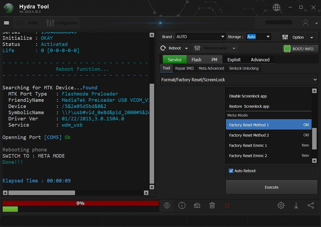

- Reboot Phone with MetaMode
                  Reboot Function...
  MTK Port Type   : Flashmode Preloader
  FriendlyName    : MediaTek PreLoader USB VCOM_V1632 (Android) (COM5)
  Device          : /5&2e05d5bd&0&2
  SymbolicName    : \\?\usb#vid_0e8d&pid_2000#5&2e05d5bd&0&2#{a5dcbf10-6530-11d2-901f-00c04fb951ed}
  Driver Ver      : 01/22/2015,3.0.1504.0
  Service         : wdm_usb
Openning Port [COM5] Ok
Rebooting phone
SWITCH TO : META MODE
Done!!!
Elapsed Time : 00:00:09

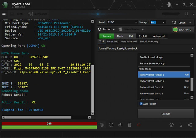

- Factory Reset Phone with MetaMode
                      Service Function
              Format/Factory Reset/ScreenLock
                  Factory Reset Method 1
  MTK Port Type   : METAMODE Preloader
  FriendlyName    : MediaTek ETS Port (COM64)
  Device          : VID_0E8D&PID_202D&MI_01/6&20ef02b4&0&0001
  Service         : wdm_usb
Openning Port [COM64] Ok
META Phone Info . . .
MCUID: 8U  `    mt6739,S01
ME_SO: S01
DATE : 2022    09    05  Z            19:56:10 CST
MODEL: Digit_M42456DG_B138_SPK_SW07_20220905_1953
ME_SWVER: alps-mp-m0.kaios.mp1-V1.2_fise6731.kaio.m_P11
IMEI 1 : 35187**********
IMEI 2 : 35187**********
Rebooting phone
Reboot Done!!!
Action Result :  Ok
Elapsed Time : 00:00:08
