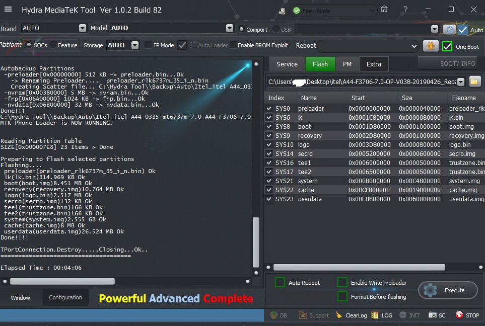

Hydra Itel A44 Successfully flashed selected partition by Hydra Tool
546
Brand : AUTO Model : AUTO Connection : Flash Mode
How To Boot : Power off phone
* BROM Mode : Press VOL + or Press VOL -+
Connection
-Please wait...
-Connect Phone...
-Found...
-PreLoader...[COM8]
TPortConnection.Create...(COM8)..Opening...Ok
Handshaking...Ok
Identifying Hardware ID.....
BROM CPUID : 0335MT6737[6735]
Handshaking...
FUSEID : 00000000
SECURE VERSION : 00
BL VERSION : 00
BR Secured : 00
NORMAL BOOT
Preparing Download Agent..
DA : 6735.bin
Ver : MTK_AllInOne_DA_v3.3001.2020-11-03.22:07_536568
Init : Loader [1]
Sending : Accepted
Identifying Protocol...
Protocol : Old - eMMC
00000000000000000000
PRMMCCID : 460001154D32364EE6BB03420F8D36D6
Init Configuration
Running DA 4.2 on BBID : 0x9B Ok
Initializing Loader [2]
Sending Loader [2] Accepted
Reading Flashchip data....
eMMC RPMB : 0x0000000000080000 -512 KB
eMMC USER : 0x00000001D2000000 -7.281 GB
ERAM Size : 0x0000000040000000 -1024 MB
IRAM Size : 0x0000000000020000 -128 KB
UNICAL RID : AA15CB8472A5CA79332218D1E8E06F68
eMMC CID : 460001154D32364EE6BB03420FC436D6
Change to HIGH SPEED...
5A
Connection
-Please wait...
-Found...[COM9]
Reading Partition Table
SIZE[0x000007E8] 23 Items > Done
Reading System Info
Brand : Itel
Vendor : itel
Model : itel A44
SDK : 24
Release : 7.0
ABI : armeabi-v7a
Locale : en-US
Description : A44-user 7.0 NRD90M 1565321702 release-keys
Device : itel-A44
Display ID : A44-F3706-7.0-OP-V042-20190809
Security Patch : 2019-08-05
Platform : mt6737m
FRPPST : /dev/block/platform/mtk-msdc.0/11230000.msdc0/by-name/frp
Fingerprint : Itel/F3706/itel-A44:7.0/NRD90M/A44-F3706-7.0-OP-V042-20190809:user/release-keys
StorageType : mtp
Autobackup Partitions
-preloader[0x00000000] 512 KB -> preloader.bin...Ok
-> Renaming Preloader.... preloader_rlk6737m_35_i_n.bin
Creating Scatter file... C:\Hydra Tool\\Backup\Auto\Itel_itel A44_0335-mt6737m-7.0_A44-F3706-7.0-OP-V042-20190809_210221154613\MT6737_Android_scatter.txt
-nvram[0x00380000] 5 MB -> nvram.bin...Ok
-frp[0x06A00000] 1024 KB -> frp.bin...Ok
-nvdata[0x06B00000] 32 MB -> nvdata.bin...Ok
Done!!!
Preparing to flash selected partitions
Flashing....
preloader(preloader_rlk6737m_35_i_n.bin) Ok
lk(lk.bin)314.969 KB Ok
boot(boot.img)8.451 MB Ok
recovery(recovery.img)10.764 MB Ok
logo(logo.bin)2.517 MB Ok
secro(secro.img)132 KB Ok
tee1(trustzone.bin)166 KB Ok
tee2(trustzone.bin)166 KB Ok
system(system.img)2.555 GB Ok
cache(cache.img)8 MB Ok
userdata(userdata.img)26.524 MB Ok
Done!!!!
Elapsed Time : 00:04:06
