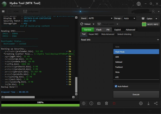

Reading IMEI........
IMEI1 : 35049**********
IMEI2 : 35049**********
Bootloader Status...
  Bootloader : Locked
Backing up Security..
- preloader(preloader.bin), 512 KB                    = Ok  [preloader_x687_h851.bin]
  *Creating Scatter file... C:\Hydra Tool\Backup\MTKBKUP\0813_059DFF8AD3dfff552C0A4771AD3D32A3\Auto\070823015908\6785_Android_scatter.txt
- pgpt(pgpt.bin), 32 KB                               = Ok
- nvram(nvram.bin), 64 MB                             = Ok
- nvdata(nvdata.bin), 64 MB                           = Ok
- frp(frp.bin), 1024 KB                               = Ok
- protect1(protect1.bin), 8 MB                        = Ok
- protect2(protect2.bin), 8 MB                        = Ok
- persist(persist.bin), 53.367 MB                     = Ok
- proinfo(proinfo.bin), 3 MB                          = Ok
- nvcfg(nvcfg.bin), 32 MB                             = Ok
- sec1(sec1.bin), 2 MB                                = Ok
- seccfg(seccfg.bin), 8 MB                            = Ok
- lk(lk.bin), 2 MB                                    = Ok
Backup Done!!!
Elapsed Time : 00:00:45

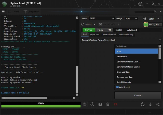

- Format/Factory Reset/ScreenLock
Auto
                      Service Function
                            Auto
  MTK Port Type   : Flashmode BROM
  FriendlyName    : MediaTek USB Port (COM35)
  Device          : /5&28a4d3d9&0&5
  SymbolicName    : \\?\usb#vid_0e8d&pid_0003#5&28a4d3d9&0&5#{a5dcbf10-6530-11d2-901f-00c04fb951ed}
  Driver Ver      : 01/22/2016,3.2
  Service         : wdm_usb
Openning Port [COM35] Ok
Reading Partition Table ..
  ERAM Size       : 0x0000000000080000-512 KB
  IRAM Size       : 0x0000000200000000-8 GB
  UFS MID         : 0x48
  UFS FWVer       : 0xA102
  UFS Blocksize   : 0x0000000000001000-4 KB
  UFS LU0 Size    : 0x0000000000400000-4 MB
  UFS LU1 Size    : 0x0000000000400000-4 MB
  UFS LU2 Size    : 0x0000001DCB000000-119.172 GB
  UFS ID          : H
  UFS CID         : 4839485131354146414D41444152000000000000
  HW-CODE         : 0x813
  HWSUB-CODE      : 0x8A00
  HW-VERSION      : 0xCA00
  SW-VERSION      : 0x0
  CHIP-EVOLUTION  : 0x0
  DA-VERSION      : 1.0
  Speed           : high-speed
Partition Count : 47
  Product        : tssi_64_infinix
  SDK            : 29
  Release        : 10
  ABI            : arm64-v8a
  CPU abilist    : arm64-v8a,armeabi-v7a,armeabi
  Locale         : en-US
  Description    : sys_tssi_64_infinix-user 10 QP1A.190711.020 36146 release-keys
  Display ID     : INFINIX-Q-64-220729V520
  Security Patch : 2022-07-05
  StorageType    : mtp
IMEI1 : 350496********
IMEI2 : 350496********
  Bootloader : Locked
   Factory Reset Flash Mode..
Operation : Safeformat Universal...
Rebooting Device...
Rebooting Operation Done!!!!
Action Result :  Ok
Elapsed Time : 00:00:12
