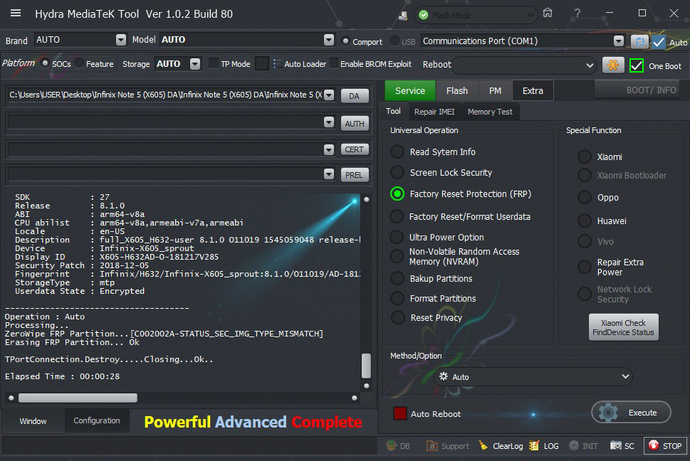

Infinix X605 FRP successfully Removed by Hydra Tool
Brand : AUTO Model : AUTO Connection : Flash Mode
Connection
-Please wait...
-Connect Phone...
-Found...
-PreLoader...[COM144]
TPortConnection.Create...(COM144)..Opening...Ok
Handshaking...Ok
Identifying Hardware ID.....
BROM CPUID : 0690MT6763T[6763]
BROM HW_SW_VER : 8A00 CA01 0001 0000
Handshaking...
SECURE VERSION : FF
BL VERSION : 03
BR Secured : 05
NORMAL BOOT
Preparing Download Agent..
DA : MTK_AllInOne_DA.bin
Agent: MTK_DOWNLOAD_AGENT
Ver : MTK_AllInOne_DA_v3.3001.2017/12/14.17:12_396299
Init : Loader [1]
Sending : Accepted
Identifying Protocol...
Protocol : New
Synchronization...SYNC
Mode : preloader
Execute Secondary Loader
Init : Loader [2]
Executing : SYNC
UNIQUE ID : F34204E19A4C7DDB3FE9D0DF9849E762
eMMC CID : 90014A484347386134A235D4006E54A5 - HCG8a4
DA Speed : high-speed
Reading System Info
Brand : Infinix
Vendor : INFINIX MOBILITY LIMITED
Model : Infinix X605
SDK : 27
Release : 8.1.0
ABI : arm64-v8a
Locale : en-US
Description : full_X605_H632-user 8.1.0 O11019 1545059048 release-keys
Device : Infinix-X605_sprout
Display ID : X605-H632AD-O-181217V285
Security Patch : 2018-12-05
Fingerprint : Infinix/H632/Infinix-X605_sprout:8.1.0/O11019/AD-181217V285:user/release-keys
StorageType : mtp
Userdata State : Encrypted
Autobackup Partitions
-> Renaming Preloader.... preloader_x605_h632.bin
Creating Scatter file... C:\Users\USER\Desktop\HydraTool_Fullpackage_01-25-2021\\Backup\Auto\Infinix_Infinix X605_0690--8.1.0_X605-H632AD-O-181217V285_100221110921\MT6763T_Android_scatter.txt
-frp[0x01588000]1024 KB ->frp.bin...Ok
-nvdata[0x03688000]64 MB ->nvdata.bin...Ok
-persist[0x0B000000]48 MB ->persist.bin...Ok
-nvram[0x0E500000]64 MB ->nvram.bin...Ok
Done!!!
Reading System Info
Brand : Infinix
SDK : 27
Release : 8.1.0
ABI : arm64-v8a
Locale : en-US
StorageType : mtp
Operation : Auto
Processing...
ZeroWipe FRP Partition...[C002002A-STATUS_SEC_IMG_TYPE_MISMATCH]
Erasing FRP Partition... Ok
Elapsed Time : 00:00:28
