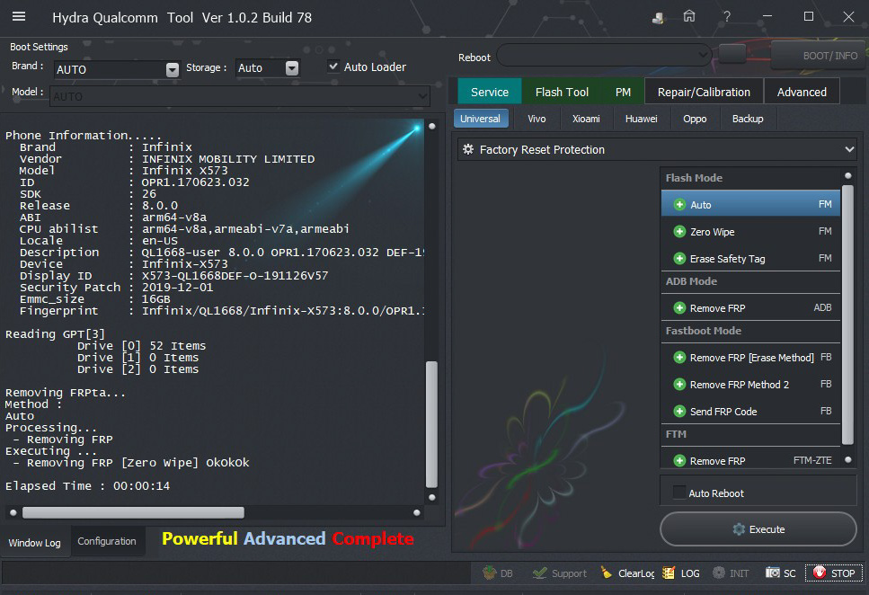

Infinix X573 FRP successfully removed by Hydra Tool
PreOperation Configuration
Brand : AUTO Model : AUTO Storage : Auto
Loader: Auto
Port : Auto
Connection :
FriendlyName :Qualcomm HS-USB QDLoader 9008 (COM4)
SymbolicName :\??\USB#VID_05C6&PID_9008#6&2e01eb57&0&3#{a5dcbf10-6530-11d2-901f-00c04fb951ed}
Getting device info..Ok
Device MODE : Firehose
Connecting to Firehose...
Ping.. Ok
Configuration......
Identifying Chip....
Ok
Chip Configuration :
MemoryName : eMMC
MaxXMLSizeInBytes : 4096
TargetName : 8937
Version : 1
*** STORAGE DEVICE INFO ***
Memory Type : eMMC
Block Size in Bytes : 512
Page Size : 512
Manufacturer ID : 144
Serial Number : 1471583748
Firmware Version : 165
Product Name : HBG4a2
Physical Partitions : 3
Total Logical Blocks:
Drive [0] 61071360[29.121 GB]
Drive [1] 8192[4 MB]
Drive [2] 8192[4 MB]
Protocol : Universal
Running : Ok
Phone Information.....
Brand : Infinix
Vendor : INFINIX MOBILITY LIMITED
Model : Infinix X573
SDK : 26
Release : 8.0.0
ABI : arm64-v8a
Locale : en-US
Description : QL1668-user 8.0.0 OPR1.170623.032 DEF-191126V57 release-keys
Device : Infinix-X573
Display ID : X573-QL1668DEF-O-191126V57
Security Patch : 2019-12-01
Emmc_size : 16GB
Fingerprint : Infinix/QL1668/Infinix-X573:8.0.0/OPR1.170623.032/DEF-191126V57:user/release-keys
Reading GPT[3]
Drive [0] 52 Items
Drive [1] 0 Items
Drive [2] 0 Items
Removing FRPta...
Method :
Auto
Processing...
- Removing FRP
Executing ...
- Removing FRP [Zero Wipe] OkOkOk
Elapsed Time : 00:00:14
