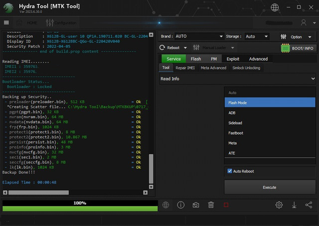

Backing up Security..
- preloader(preloader.bin), 512 KB                    = Ok  [preloader_infinix_x612b.bin]
  *Creating Scatter file... C:\Hydra Tool\Backup\MTKBKUP\0717_CCCCA36C85A439BDE0E62FD57A806F\Auto\072023080508\6761_Android_scatter.txt
- pgpt(pgpt.bin), 32 KB                               = Ok
- nvram(nvram.bin), 64 MB                             = Ok
- nvdata(nvdata.bin), 64 MB                           = Ok
- frp(frp.bin), 1024 KB                               = Ok
- protect1(protect1.bin), 8 MB                        = Ok
- protect2(protect2.bin), 10.867 MB                   = Ok
- persist(persist.bin), 48 MB                         = Ok
- proinfo(proinfo.bin), 3 MB                          = Ok
- nvcfg(nvcfg.bin), 32 MB                             = Ok
- sec1(sec1.bin), 2 MB                                = Ok
- seccfg(seccfg.bin), 8 MB                            = Ok
- lk(lk.bin), 1024 KB                                 = Ok
Backup Done!!!
Elapsed Time : 00:00:48

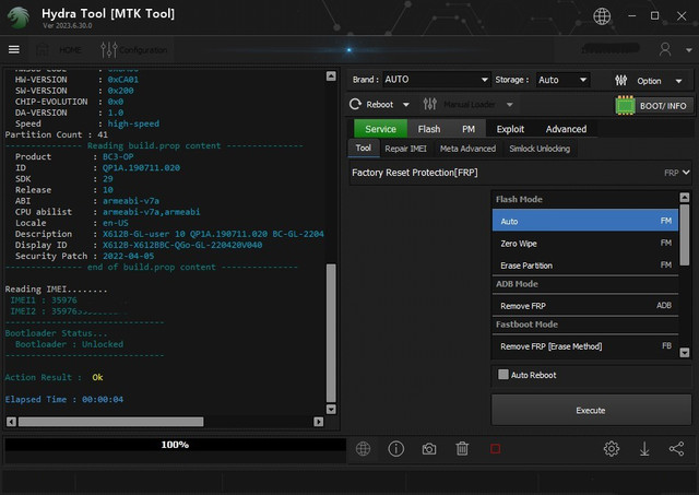

- select FRP lock remove and click execute
                      Service Function
               Factory Reset Protection[FRP]
                            Auto
  MTK Port Type   : Flashmode BROM
  FriendlyName    : MediaTek USB Port_V1633 (COM82)
  Device          : /5&fade7a0&0&4
  SymbolicName    : \\?\usb#vid_0e8d&pid_0003#5&fade7a0&0&4#{a5dcbf10-6530-11d2-901f-00c04fb951ed}
  Driver Ver      : 01/22/2015,3.0.1504.0
  Service         : wdm_usb
Openning Port [COM82] Ok
Reading Partition Table ..
  ERAM Size       : 0x000000000003A500-233.25 KB
  IRAM Size       : 0x0000000080000000-2 GB
  EMMC RPMB Size  : 0x0000000000400000-4 MB
  EMMC USER Size  : 0x0000000747C00000-29.121 GB
  EMMC CID        : 15010051583633414203FD49F4EB28E9 - QX63AB
  HW-CODE         : 0x717
  HWSUB-CODE      : 0x8A00
  HW-VERSION      : 0xCA01
  SW-VERSION      : 0x200
  CHIP-EVOLUTION  : 0x0
  DA-VERSION      : 1.0
  Speed           : high-speed
Partition Count : 41
  Product        : BC3-OP
  SDK            : 29
  Release        : 10
  ABI            : armeabi-v7a
  CPU abilist    : armeabi-v7a,armeabi
  Locale         : en-US
  Description    : X612B-GL-user 10 QP1A.190711.020 BC-GL-220420V040 release-keys
  Display ID     : X612B-X612BBC-QGo-GL-220420V040
  Security Patch : 2022-04-05
Reading IMEI........
IMEI1 : 359763*********
IMEI2 : 359763*********
Bootloader Status...
  Bootloader : Unlocked
Action Result :  Ok
Elapsed Time : 00:00:04
