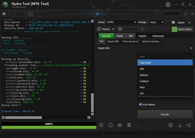

- first keep press boot info
To Enable BROM  Mode :
     Method 1    - Bootkey (Vol + - Power) or any combination
     Method 2    - Enable Preloader to brom(crashing Method)
     Method 3    - Test Point Data0 + ground
To Enable Preloader  Mode :
     Method 1    - Just Insert cable
  MTK Port Type   : Flashmode BROM
  FriendlyName    : MediaTek USB Port_V1632 (COM14)
  Device          : /6&2ac3e851&0&4
  SymbolicName    : \\?\usb#vid_0e8d&pid_0003#6&2ac3e851&0&4#{a5dcbf10-6530-11d2-901f-00c04fb951ed}
  Driver Ver      : 01/22/2015,3.0.1504.0
  Service         : wdm_usb
Openning Port [COM14] Ok
Handshaking...Ok
  HwCode          : 0717 {MT6761/MT6762/MT3369/MT8766B}
  Hwver           : 0000
  Target config   : E5
  SBC             : 01 (True)
  SLA             : 00 (False)
  DAA             : 04 (True)
  SWJTAG          : 04 (True)
  EPP             : 00 (False)
  CERT            : 00 (False)
  MEMREAD         : 20 (True)
  MEMWRITE        : 40 (True)
  CMD_C8          : 80 (True)
  Connection      : BROM
  HW Subcode      : 8A00
  HW Subcode      : CA01
  SW Ver          : 0200
  ME_ID           : 9A1737F1895EEFA82ED80AD8591F2DD7
  SOC_ID          : 698D2DED9984C8540215FAA5B2D6C509ABD6F02F666AA0FAFE0E64EE004B3366
Exploiting Device...
Successfully Exploited..
Handshaking...Ok
Starting to dump...
Prel Size : 0x00039310
Successfully dump preloader..  [C:\Hydra Tool\Boot\PreloaderDump\preloader_x657c_h6117.bin]
  Target config   : 00
  SBC             : 00 (False)
  SLA             : 00 (False)
  DAA             : 00 (False)
  SWJTAG          : 00 (False)
  EPP             : 00 (False)
  CERT            : 00 (False)
  MEMREAD         : 00 (False)
  MEMWRITE        : 00 (False)
  CMD_C8          : 00 (False)
  Connection      : BROM
Patching da2 ... Ok
Uploading Stage 1....
Jumping to 0x00200000 Ok 0xC0
Successfully received DA sync
  ONNECTION_AGENT : brom
  DRAM config needed for : 7001005441323833
Sending auto preloader from dump...  [preloader_x657c_h6117.bin]
Sending emi data succeeded.
Uploading stage 2...
Successfully uploaded stage 2
  ERAM Size       : 0x000000000003A500-233.25 KB
  IRAM Size       : 0x0000000080000000-2 GB
  EMMC RPMB Size  : 0x0000000000400000-4 MB
  EMMC USER Size  : 0x000000074A000000-29.156 GB
  EMMC CID        : 700100544132383332232587890E6873 - TA2832
  HW-CODE         : 0x717
  HWSUB-CODE      : 0x8A00
  HW-VERSION      : 0xCA01
  SW-VERSION      : 0x200
  CHIP-EVOLUTION  : 0x0
  DA-VERSION      : 1.0
  Speed           : high-speed
Reading Partition Table ..
Partition Count : 43
  Product        : x657c_h6117
  SDK            : 29
  Release        : 10
  ABI            : armeabi-v7a
  CPU abilist    : armeabi-v7a,armeabi
  Locale         : en-US
  Description    : full_x657c_h6117-user 10 QP1A.190711.020 319582 release-keys
  Display ID     : X657C-H6117GH-QGo-GL-220610V322
  Security Patch : 2022-06-05
Reading IMEI........
IMEI1 : 35991*********
IMEI2 : 35991*********
Bootloader Status...
  Bootloader : Locked
Backing up Security..
- preloader(preloader.bin), 512 KB                    = Ok  [preloader_x657c_h6117.bin]
  *Creating Scatter file... C:\Hydra Tool\Backup\MTKBKUP\0717_9A1737F18855FA82ED80AD8591F2DD7\Auto\072023095203\6761_Android_scatter.txt
- pgpt(pgpt.bin), 32 KB                               = Ok
- nvram(nvram.bin), 64 MB                             = Ok
- nvdata(nvdata.bin), 71.867 MB                       = Ok
- frp(frp.bin), 1024 KB                               = Ok
- protect1(protect1.bin), 8 MB                        = Ok
- protect2(protect2.bin), 8 MB                        = Ok
- persist(persist.bin), 48 MB                         = Ok
- proinfo(proinfo.bin), 3 MB                          = Ok
- nvcfg(nvcfg.bin), 32 MB                             = Ok
- sec1(sec1.bin), 2 MB                                = Ok
- seccfg(seccfg.bin), 8 MB                            = Ok
- lk(lk.bin), 1024 KB                                 = Ok
Backup Done!!!
Elapsed Time : 00:01:38

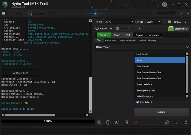

- select ultra power auto and click execute
                      Service Function
                        Ultra Power
                            Auto
  Service         : wdm_usb
  HW-CODE         : 0x717
  HWSUB-CODE      : 0x8A00
  HW-VERSION      : 0xCA01
  SW-VERSION      : 0x200
  DA-VERSION      : 1.0
  Speed           : high-speed
  SDK            : 29
  Release        : 10
  ABI            : armeabi-v7a
  Locale         : en-US
IMEI1 : 3599122********
IMEI2 : 3599122********
  Bootloader : Locked
        Ultra Power
Formatting Userdata :
Operation : Safeformat Universal... Ok
Removing FRP :  Ok
Rebooting Device...
Rebooting Operation Done!!!!
Action Result :  Ok
Elapsed Time : 00:00:10
