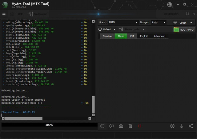

Hydra infinix hot 9 play X680B Flashing done with Hydra Tool
                  MTK Flash Function...
  MTK Port Type   : Flashmode BROM
  FriendlyName    : MediaTek USB Port_V1632 (COM26)
  Device          : /5&23bd4c4&0&4
  SymbolicName    : \\?\usb#vid_0e8d&pid_0003#5&23bd4c4&0&4#{a5dcbf10-6530-11d2-901f-00c04fb951ed}
  Driver Ver      : 01/22/2015,3.0.1504.0
  Service         : wdm_usb
Openning Port [COM26] Ok
Handshaking...Ok
  HwCode          : 0766 {MT6765/MT8768t}
  Hwver           : 0000
  Target config   : E5
  SBC             : 01 (True)
  SLA             : 00 (False)
  DAA             : 04 (True)
  SWJTAG          : 04 (True)
  EPP             : 00 (False)
  CERT            : 00 (False)
  MEMREAD         : 20 (True)
  MEMWRITE        : 40 (True)
  CMD_C8          : 80 (True)
  Connection      : BROM
  HW Subcode      : 8A00
  HW Subcode      : CA00
  SW Ver          : 0000
  ME_ID           : DA6359068E41ED0515570B3092BC6001
  SOC_ID          : 2388EAC1751D3283ED0278CA41CF79CBEEDCFE490C10C95216F88DFD40440A2C
Exploiting Device...
Successfully Exploited..
Handshaking...Ok
Starting to dump...
Prel Size : 0x0003CEEC
Successfully dump preloader..  [C:\Hydra Tool\Boot\PreloaderDump\preloader_x680b_h6215.bin]
  Target config   : 00
  SBC             : 00 (False)
  SLA             : 00 (False)
  DAA             : 00 (False)
  SWJTAG          : 00 (False)
  EPP             : 00 (False)
  CERT            : 00 (False)
  MEMREAD         : 00 (False)
  MEMWRITE        : 00 (False)
  CMD_C8          : 00 (False)
  Connection      : BROM
Patching da2 ... Ok
Uploading Stage 1....
Jumping to 0x00200000 Ok 0xC0
Successfully received DA sync
  ONNECTION_AGENT : brom
  DRAM config needed for : 1501004450364441
Sending auto preloader from dump...  [preloader_x680b_h6215.bin]
Sending emi data succeeded.
Uploading stage 2...
Successfully uploaded stage 2
  ERAM Size       : 0x000000000003A000-232 KB
  IRAM Size       : 0x0000000100000000-4 GB
  EMMC RPMB Size  : 0x0000000001000000-16 MB
  EMMC USER Size  : 0x0000000E8F800000-58.242 GB
  EMMC CID        : 15010044503644414203E81D68499769 - DP6DAB
  HW-CODE         : 0x766
  HWSUB-CODE      : 0x8A00
  HW-VERSION      : 0xCA00
  SW-VERSION      : 0x0
  CHIP-EVOLUTION  : 0x0
  DA-VERSION      : 1.0
  Speed           : high-speed
Reading Partition Table ..
Partition Count : 43
No or unknown super geometry !
Reading IMEI........
Bootloader Status...
  Bootloader : Locked
Backing up Security..
- preloader(preloader.bin), 512 KB                    = Ok  [preloader_x680b_h6215.bin]
  *Creating Scatter file... C:\Hydra Tool\Backup\MTKBKUP\0766_DA6359068E41ED0515570474747476001\Auto\070723110329\6765_Android_scatter.txt
- pgpt(pgpt.bin), 32 KB                               = Ok
- nvram(nvram.bin), 64 MB                             = Ok
- nvdata(nvdata.bin), 71.867 MB                       = Ok
- frp(frp.bin), 1024 KB                               = Ok
- protect1(protect1.bin), 8 MB                        = Ok
- protect2(protect2.bin), 8 MB                        = Ok
- persist(persist.bin), 48 MB                         = Ok
- proinfo(proinfo.bin), 3 MB                          = Ok
- nvcfg(nvcfg.bin), 32 MB                             = Ok
- sec1(sec1.bin), 2 MB                                = Ok
- seccfg(seccfg.bin), 8 MB                            = Ok
- lk(lk.bin), 1024 KB                                 = Ok
Backup Done!!!
Write Selected Partitions..
- preloader(preloader_x680b_h6215.bin), 243.73 KB[Erasing...Ok]  Status  :C0010001 Error= Failed
- proinfo(proinfo.img), 2.79 MB                       = Ok
- persist(persist.img), 4.309 MB                      = Ok
- tkv(tkv.img), 64 KB                                 = Ok
- recovery(recovery.img), 39 MB                       = Ok
- md1img(md1rom.img), 49.421 MB                       = Ok
- spmfw(spmfw.img), 62.578 KB                         = Ok
- scp1(tinysys-scp.bin), 545.609 KB                   = Ok
- scp2(tinysys-scp.bin), 545.609 KB                   = Ok
- sspm_1(sspm.img), 422.719 KB                        = Ok
- sspm_2(sspm.img), 422.719 KB                        = Ok
- nvram(nvram.bin), 63.875 MB                         = Ok
- lk(lk.bin), 884.188 KB                              = Ok
- lk2(lk.bin), 884.188 KB                             = Ok
- boot(boot.img), 32 MB                               = Ok
- logo(logo.bin), 1.422 MB                            = Ok
- dtbo(dtbo.img), 8 MB                                = Ok
- tee1(tz.img), 2.168 MB                              = Ok
- tee2(tz.img), 2.168 MB                              = Ok
- vbmeta(vbmeta.img), 3.719 KB                        = Ok
- vbmeta_system(vbmeta_system.img), 1.891 KB          = Ok
- vbmeta_vendor(vbmeta_vendor.img), 1.484 KB          = Ok
- super(super.img), 4.102 GB                          = Ok
- cache(cache.img), 212.145 KB                        = Ok
- tranfs(tranfs.img), 212.145 KB                      = Ok
- userdata(userdata.img), 80.191 KB                   = Ok
Rebooting Device...
Rebooting Device...
Rebooting Operation Done!!!!                           =  Ok
Elapsed Time : 00:03:19
