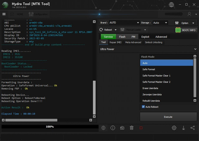

Infinix Hot 10 Play (X688B) Pattern and Frp Lock Remove with Hydra Tool
- Boot/info
To Enable BROM  Mode :
     Method 1    - Bootkey (Vol + - Power) or any combination
     Method 2    - Enable Preloader to brom(crashing Method)
     Method 3    - Test Point Data0 + ground
To Enable Preloader  Mode :
     Method 1    - Just Insert cable
  MTK Port Type   : Flashmode BROM
  FriendlyName    : MediaTek USB Port_V1632 (COM65)
  Device          : /5&2a6d7c22&0&1
  SymbolicName    : \\?\usb#vid_0e8d&pid_0003#5&2a6d7c22&0&1#{a5dcbf10-6530-11d2-901f-00c04fb951ed}
  Driver Ver      : 01/22/2015,3.0.1504.0
  Service         : wdm_usb
Openning Port [COM65] Ok
Handshaking...Ok
  HwCode          : 0766 {MT6765/MT8768t}
  Hwver           : 0000
  Target config   : E5
  SBC             : 01 (True)
  SLA             : 00 (False)
  DAA             : 04 (True)
  SWJTAG          : 04 (True)
  EPP             : 00 (False)
  CERT            : 00 (False)
  MEMREAD         : 20 (True)
  MEMWRITE        : 40 (True)
  CMD_C8          : 80 (True)
  Connection      : BROM
  HW Subcode      : 8A00
  HW Subcode      : CA00
  SW Ver          : 0000
  ME_ID           : 1F6004C573307C3EAE215CFC2013D4E9
  SOC_ID          : A72C7A167F484CBE7426148ADA035951982669C08918C41B5B2767028AEE3DEF
Exploiting Device...
Successfully Exploited..
Handshaking...Ok
Starting to dump...
Prel Size : 0x0003C170
Successfully dump preloader..  [C:\Hydra Tool\Boot\PreloaderDump\preloader_x688b_h659.bin]
  Target config   : 00
  SBC             : 00 (False)
  SLA             : 00 (False)
  DAA             : 00 (False)
  SWJTAG          : 00 (False)
  EPP             : 00 (False)
  CERT            : 00 (False)
  MEMREAD         : 00 (False)
  MEMWRITE        : 00 (False)
  CMD_C8          : 00 (False)
  Connection      : BROM
Patching da2 ... Ok
Uploading Stage 1....
Jumping to 0x00200000 Ok 0xC0
Successfully received DA sync
  ONNECTION_AGENT : brom
  DRAM config needed for : 90014A6843396150
Sending auto preloader from dump...  [preloader_x688b_h659.bin]
Sending emi data succeeded.
Uploading stage 2...
Successfully uploaded stage 2
  ERAM Size       : 0x000000000003A000-232 KB
  IRAM Size       : 0x0000000100000000-4 GB
  EMMC RPMB Size  : 0x0000000001000000-16 MB
  EMMC USER Size  : 0x0000000E8F800000-58.242 GB
  EMMC CID        : 90014A68433961503301004274BC6809 - hC9aP3
  HW-CODE         : 0x766
  HWSUB-CODE      : 0x8A00
  HW-VERSION      : 0xCA00
  SW-VERSION      : 0x0
  CHIP-EVOLUTION  : 0x0
  DA-VERSION      : 1.0
  Speed           : high-speed
Reading Partition Table ..
Partition Count : 43
  Product        : tssi_64_infinix_q_ota
  SDK            : 30
  Release        : 11
  ABI            : arm64-v8a
  CPU abilist    : arm64-v8a,armeabi-v7a,armeabi
  Locale         : en-US
  Description    : sys_tssi_64_infinix_q_ota-user 11 RP1A.200720.011 282776 release-keys
  Display ID     : INFINIX-R-64-230324V566
  Security Patch : 2023-03-05
  StorageType    : mtp
Reading IMEI........
IMEI1 : 353209********
IMEI2 : 353209********
Bootloader Status...
  Bootloader : Locked
Backing up Security..
- preloader(preloader.bin), 512 KB                    = Ok  [preloader_x688b_h659.bin]
  *Creating Scatter file... C:\Hydra Tool\Backup\MTKBKUP\0766_1F60044555555E215CFC2013D4E9\Auto\070723110755\6765_Android_scatter.txt
- pgpt(pgpt.bin), 32 KB                               = Ok
- nvram(nvram.bin), 64 MB                             = Ok
- nvdata(nvdata.bin), 71.867 MB                       = Ok
- frp(frp.bin), 1024 KB                               = Ok
- protect1(protect1.bin), 8 MB                        = Ok
- protect2(protect2.bin), 8 MB                        = Ok
- persist(persist.bin), 48 MB                         = Ok
- proinfo(proinfo.bin), 3 MB                          = Ok
- nvcfg(nvcfg.bin), 32 MB                             = Ok
- sec1(sec1.bin), 2 MB                                = Ok
- seccfg(seccfg.bin), 8 MB                            = Ok
- lk(lk.bin), 1024 KB                                 = Ok
Backup Done!!!
Elapsed Time : 00:01:57
go to
Ultra Power
Auto
                      Service Function
                        Ultra Power
                            Auto
  Service         : wdm_usb
  HW-CODE         : 0x766
  HWSUB-CODE      : 0x8A00
  HW-VERSION      : 0xCA00
  SW-VERSION      : 0x0
  DA-VERSION      : 1.0
  Speed           : high-speed
  SDK            : 30
  Release        : 11
  ABI            : arm64-v8a
  Locale         : en-US
  StorageType    : mtp
IMEI1 : 35320*********
IMEI2 : 35320*********
  Bootloader : Locked
        Ultra Power
Formatting Userdata :
Operation : Safeformat Universal... Ok
Removing FRP :  Ok
Rebooting Device...
Rebooting Operation Done!!!!
Action Result :  Ok
Elapsed Time : 00:00:10
