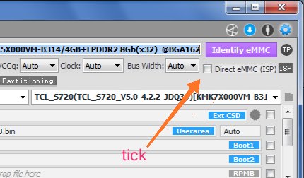

Tick
Reactions: kazgsm
iunlock
Jul 18, 2019
21
8
bro i am not a new bie in software i used RIff before as well just got ufi now i am in repairs since 2002 i know all settings ofcourse i ticked that direct emmc
