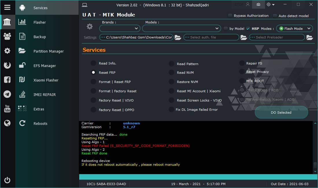

HUAWEI Y3II LUA-L22 FRP Reset Done
.:: UAT MTK ::.
Device found
MediaTek PreLoader USB VCOM (Android) (COM31)
Mode : PreLoader Port
Port : COM31
Preparing Download Agent..
DA : MTK_DOWNLOAD_AGENT - Custom
DA Version : MTK_AllInOne_DA_v3.3001.00.00
Drivers : MediaTek Inc.
Driver Version : 01/22/2015,3.0.1504.0
Handshaking... done
Connecting to Brom... done
Chip name :   [MT6582]
Sending DA download agent... Accepted
Identifying Hardware ID.....
ChipID         :    MT6582
Software Ver     :    0001
Hardware Ver     :    CA01
Secure Ver     :    FF
BootLdr Ver    :    01
Ext RAM        :    0x40000000
SRAM        :    0x00020000
Storage        :    0x01D2C00000
RAM Size    :    1.000 GB
SRAM Size    :    128.000 KB
Storage Size    :    7.293 GB
Storage Type    :    EMMC
Rebooting into Hi-Speed Mode...
Device found
MediaTek DA USB VCOM (Android) (COM9)
Mode : VCOM Port
Port : COM9
Changing normal mode into HiSpeed Mode... done
Getting partition details ...  done
Partition count : 23
Reading system Information...
Model              :    HUAWEI LUA-U22
Hardware           :    LUA-U22
Android Ver.       :    5.1
Android OS         :    Lollipop
CPU                :    armeabi-v7a
Platform           :    mt6582
Display id         :    LUA-U22C328B014
Build Date         :    Thu Dec 28 19:19:33 CST 2017
Build id           :    HUAWEILUA-U22
Security Patch     :    2017-12-05
Brand              :    HUAWEI
Manufacturer       :    HUAWEI
Product            :    HWLUA-U6582
Carrier            :    unknown
GsmVersion         :    5.1_r7
Searching FRP data...  done
Resetting FRP...
Using Algo - 1
Reset FRP Failed (S_SECURITY_SF_CODE_FORMAT_FORBIDDEN)
Using Algo - 2
Reset FRP done
Rebooting device
If it does not reboot automatically , please reboot manually
