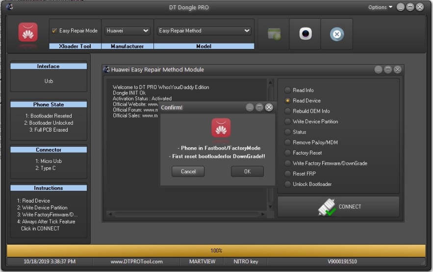

Huawei VKY-L09C DownGrade Success "Testing New Version from PERU"
LEOSERVICE
Aug 18, 2019
12
3

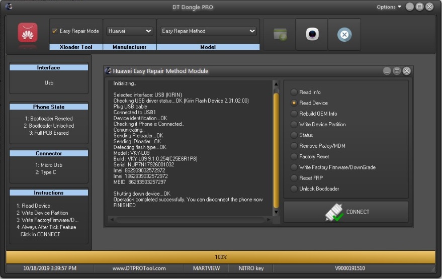

Initializing..
Selected interface: USB (KIRIN)
Checking USB driver status...OK (Kirin Flash Device 2.01.02.00)
Plug USB cable
Connected to USB1
Device identification...OK
Comunicating..
Sending Preloader...OK
Sending IDloader...OK
Detecting flash type...OK
Model : VKY-L09
Build : VKY-L09 9.1.0.254(C25E6R1P8)
Serial NUP7N17926001032
Imei 862939032572972
Imei 1862939032572972
MEID 86293903257297
Total Files to Process : 33
Writing Partition : ptable
Max Write Size : 471859200 bytes
Uploading : ptable [196 KB]
Verifying.. okay
Writing : ptable
Verifying.. okay
Done..
Writing Partition : xloader
Uploading : xloader [151 KB]
Verifying.. okay
Writing : xloader
Verifying.. okay
Done..
Writing Partition : fastboot
Uploading : fastboot [3634 KB]
Verifying.. okay
Writing : fastboot
Verifying.. okay
Done..
Writing Partition : vector
Uploading : vector [1181 KB]
Verifying.. okay
Writing : vector
Verifying.. okay
Done..
Writing Partition : boot
Uploading : boot [17704 KB]
Verifying.. okay
Writing : boot
Verifying.. okay
Done..
Writing Partition : recovery
Uploading : recovery [41004 KB]
Verifying.. okay
Writing : recovery
Verifying.. okay
Done..
Erasing : cust
Verifying.. okay
Done..
Erasing : misc
Verifying.. okay
Done..
Writing Partition : cache
Uploading : cache [6248 KB]
Verifying.. okay
Writing : cache
Verifying.. okay
Done..
Writing Partition : fw_lpm3
Uploading : fw_lpm3 [216 KB]
Verifying.. okay
Writing : fw_lpm3
Verifying.. okay
Done..
Writing Partition : fw_hifi
Uploading : fw_hifi [4965 KB]
Verifying.. okay
Writing : fw_hifi
Verifying.. okay
Done..
Writing Partition : teeos
Uploading : teeos [3949 KB]
Verifying.. okay
Writing : teeos
Verifying.. okay
Done..
Writing Partition : trustfirmware
Uploading : trustfirmware [161 KB]
Verifying.. okay
Writing : trustfirmware
Verifying.. okay
Done..
Writing Partition : sensorhub
Uploading : sensorhub [1184 KB]
Verifying.. okay
Writing : sensorhub
Verifying.. okay
Done..
Writing Partition : dts
Uploading : dts [8158 KB]
Verifying.. okay
Writing : dts
Verifying.. okay
Done..
Writing Partition : modem_fw
Uploading : modem_fw [57344 KB]
Verifying.. okay
Writing : modem_fw
Verifying.. okay
Done..
Writing Partition : modemnvm_update
Uploading : modemnvm_update [38319 KB]
Verifying.. okay
Writing : modemnvm_update
Verifying.. okay
Done..
Writing Partition : isp_firmware
Uploading : isp_firmware [5265 KB]
Verifying.. okay
Writing : isp_firmware
Verifying.. okay
Done..
Writing Partition : reserved4
Uploading : reserved4 [30460 KB]
Verifying.. okay
Writing : reserved4
Verifying.. okay
Done..
Writing Partition : system
Uploading : sparse [460816 KB]
Verifying.. okay
Writing : system
Verifying.. okay
Uploading : sparse [460357 KB]
Verifying.. okay
Writing : system
Verifying.. okay
Uploading : sparse [439247 KB]
Verifying.. okay
Writing : system
Verifying.. okay
Done..
Writing Partition : vendor
Uploading : sparse [460843 KB]
Verifying.. okay
Writing : vendor
Verifying.. okay
Uploading : sparse [276610 KB]
Verifying.. okay
Writing : vendor
Verifying.. okay
Done..
Erasing : product
Verifying.. okay
Done..
Writing Partition : product
Uploading : product [179899 KB]
Verifying.. okay
Writing : product
Verifying.. okay
Done..
Erasing : version
Verifying.. okay
Done..
Writing Partition : version
Uploading : version [5272 KB]
Verifying.. okay
Writing : version
Verifying.. okay
Done..
Erasing : userdata
Verifying.. okay
Done..
Writing Partition : userdata
Uploading : userdata [264193 KB]
Verifying.. okay
Writing : userdata
Verifying.. okay
Done..
Erasing : modemnvm_factory
Verifying.. okay
Done..
Configuring Oem Part..
Verifying.. okay
Done..
Verifying.. okay
Done..
Verifying.. okay
Done..
Verifying.. okay
Done..
Writing Partition : ufs_fw
Uploading : ufs_fw [5831 KB]
Verifying.. okay
Writing : ufs_fw
Verifying.. okay
Done..
Shutting down device...OK
Operation completed successfully. You can disconnect the phone now
FINISHED
