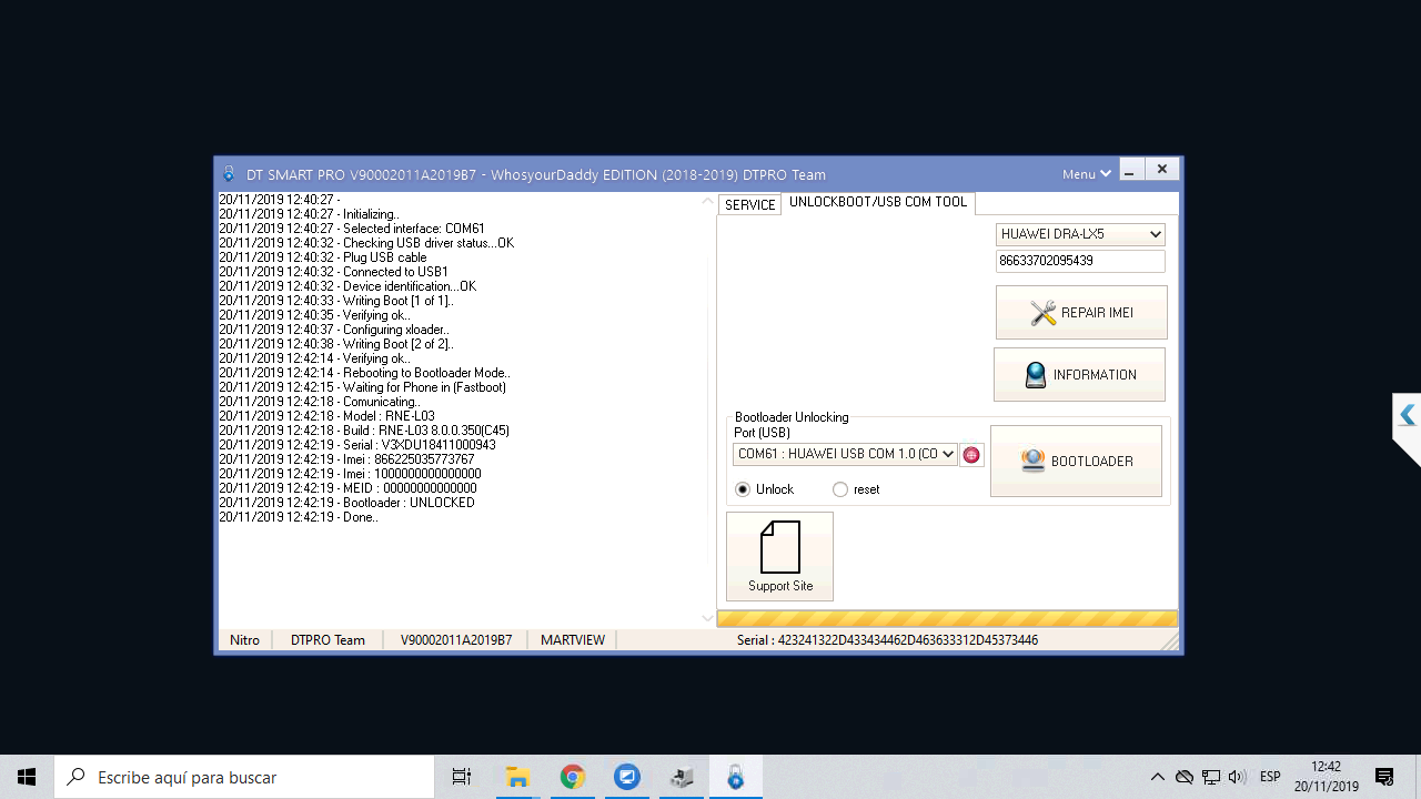

Huawei RNE-L03 8.0.0.350(C45) Unlocking Bootloader Success - Using Beta tool
njohanc72
Oct 30, 2019
10
5
20/11/2019 12:40:27 -
20/11/2019 12:40:27 - Initializing..
20/11/2019 12:40:27 - Selected interface: COM61
20/11/2019 12:40:32 - Checking USB driver status...OK
20/11/2019 12:40:32 - Plug USB cable
20/11/2019 12:40:32 - Connected to USB1
20/11/2019 12:40:32 - Device identification...OK
20/11/2019 12:40:33 - Writing Boot [1 of 1]..
20/11/2019 12:40:35 - Verifying ok..
20/11/2019 12:40:37 - Configuring xloader..
20/11/2019 12:40:38 - Writing Boot [2 of 2]..
20/11/2019 12:42:14 - Verifying ok..
20/11/2019 12:42:14 - Rebooting to Bootloader Mode..
20/11/2019 12:42:15 - Waiting for Phone in (Fastboot)
20/11/2019 12:42:18 - Comunicating..
20/11/2019 12:42:18 - Model : RNE-L03
20/11/2019 12:42:18 - Build : RNE-L03 8.0.0.350(C45)
20/11/2019 12:42:19 - Serial : V3XDU18411000943
20/11/2019 12:42:19 - Imei : 866225035773767
20/11/2019 12:42:19 - Imei : 1000000000000000
20/11/2019 12:42:19 - MEID : 00000000000000
20/11/2019 12:42:19 - Bootloader : UNLOCKED
20/11/2019 12:42:19 - Done..
