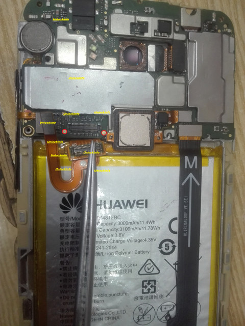

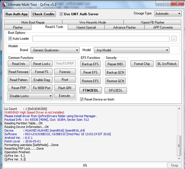

HUAWEI RIO-L01 (G8) Format/FRP Reset Done With UMT King
Test Point :
Read Info :
Operation : Read Information
Port : Qualcomm HS-USB QDLoader 9008 (COM150)
Driver Info : Qualcomm Incorporated, qcusbser.sys, 2.1.2.2
Opening Port...OK
Init Handshake Sequence...OK
Hardware ID : E1B09000 [8936] 00000000
OPK_DATA : 9CBA94693C2333A562BCF0E0E981C558748817D002F543B2A26AB1B4B3F1CF9E
Initializing Protocol...OK
Using Auto Loader Selection [2]
Preparing Loader...Done
Sending Loader [8936_036]...Done
Executing Loader...OK
Detecting Chip Type...OK
Hardware : 8936, eMMC, 16 GB
LU Count : 1 [0x01D5C000]
Payload Info : In: 65536 [4096], Out: 16384, Sector Size: 512
Reading Partition Table...OK
Device : HUAWEI HUAWEI [msm8916] [msm8916_64]
Software : RIO-L01C636B310, C636B310 [Wed May 18 13:02:24 IST 2016]
Android Ver. : 6.0.1
Patch Level : 2016-05-01
USERDATA : Normal
You can use RESET LOCKS to remove Pin/Pattern/Password WITHOUT Data Loss.
Operation Finished.
