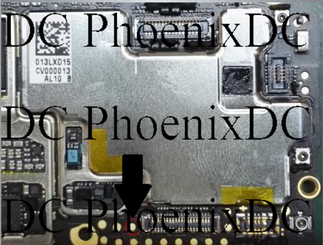

Connect Testpoint

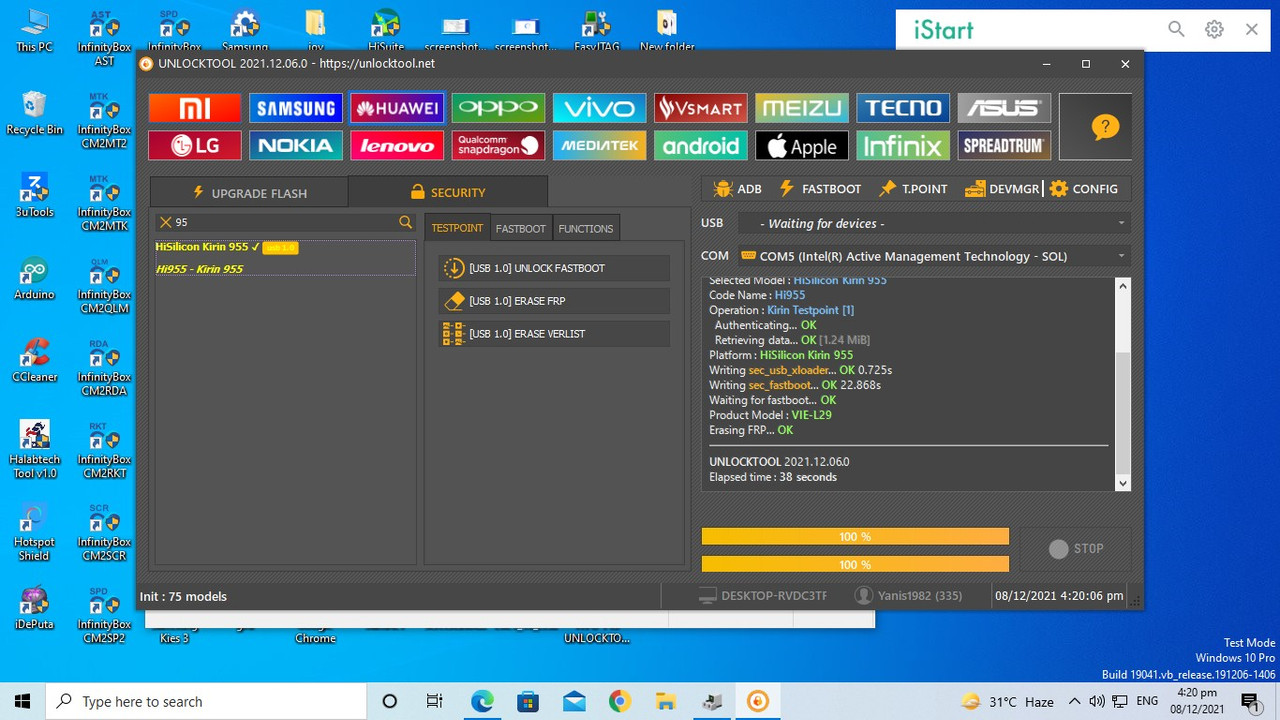

Open UT
Select Hisilicon Kirin 955
Click Erase Frp
Done.
