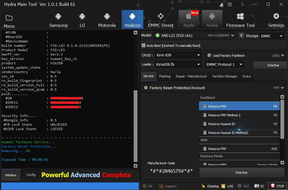

Huawei P20 Lite (ANE-L22) FRP successfully removed by Hydra Tool
1. Run Hydra Main Tool.
2. Choose "Hisilicon" Tab.
3. Choose "Module"
4. UNTick "Auto Boot"
Choose "Kirin 659"
Loader "kirin659.fb"
5. Choose "Service" Tab
6. Choose "Factory Reset Protection / Account" from drop down menu.
7. Choose "Remove FRP"
8. Click on "Execute"
9. Connect the device to the compute with the help of Data Cable.
10. Wait until the operation is completed.
3. Choose "Module"
Choose "Kirin 659"
