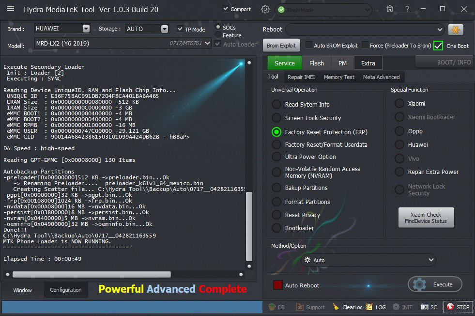

Huawei MRD-LX2 (Y6 2019) FRP successfully removed by Hydra Tool
1. Run MTK tool of Hydra Dongle.
2. Choose Correct Module and Brand.
3. Go to "Service" -- > "Tool"
4. choose "Factory Reset Protection (FRP)".
5. Choose "Auto" from "Method / Option" drop down menu.
6. Click on "Execute" and connect device with computer using USB cable.
7. Wait until the process is completed.

BRBrand : HUAWEI Model : MRD-LX2 (Y6 2019) Connection : Flash Mode
How To Boot : Remove Batt if possible
* TP Ground Must be near cpu..
* Remove ground upon popup of the message dialog.
FriendlyName :MediaTek USB Port_V1632 (COM8)
SymbolicName :\??\USB#VID_0E8D&PID_0003#5&3a33fe6e&0&1#{a5dcbf10-6530-11d2-901f-00c04fb951ed}
Handshaking...Ok
Identifying Hardware ID.....
BROM CPUID : 0717MT6761[6761]
BROM HW_SW_VER : 8A00 CA01 0200 0000
FUSEID : 00000000
SECURE VERSION : 05
BL VERSION : FE
BR Secured : E5[SBC+SDA+SEL]
Security Authorization....
Sending[Huawei_y9pro_auth_sv5.auth] Accepted
Preparing Download Agent..
DA : Huawei_Y9Pro_6761_DA.bin
Ver : MTK_AllInOne_DA_v3.3001.2018/10/18.17:38_452898
Init : Loader [1]
Sending : Accepted
Identifying Protocol...
Protocol : New
Synchronization...[ERROR]- NOT SYNC
Reasons why it fails due to the following"
1. Harware problem/issues
2. If you did Testpoint Kindly check the parts you Touch/TP
3. Powershortage, try to connect Battery
4. Check or replace usb cable and plug directly to your pc usb port.
SYNC
Mode : brom
Preloader Initialization...
Parsing preloader_k61v1_64_mexico.bin
Init : Accepted
Execute Secondary Loader
Init : Loader [2]
Executing : SYNC
UNIQUE ID : E36F75BAC991DB7204FBCA401BA6A465
eMMC CID : 90014A68423861503E01099A424DB62B - hB8aP>
DA Speed : high-speed
Autobackup Partitions
-> Renaming Preloader.... preloader_k61v1_64_mexico.bin
Creating Scatter file... C:\Hydra Tool\\Backup\Auto\0717__042821163559\MT6761_Android_scatter.txt
-frp[0x00108000]1024 KB ->frp.bin...Ok
-nvdata[0x00A08000]16 MB ->nvdata.bin...Ok
-persist[0x03800000]8 MB ->persist.bin...Ok
-nvram[0x04400000]5 MB ->nvram.bin...Ok
-oeminfo[0x04900000]32 MB ->oeminfo.bin...Ok
Done!!!
Elapsed Time : 00:00:49
