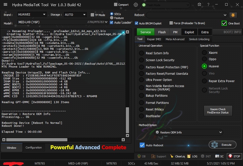

Huawei MED-L49 (Y6P) restore OEM info successfully done by Hydra Tool
1. Run MTK Hydra Tool.
2. Choose "Brand" and "Module".
3. Go to "Service"--> "Tool"
4. Choose "Huawei"
5. Chose "Restore OEM Info" from "Method/ Option" drop down option.
6. Click "Execute".
7. Connect Device to computer using USB Data Cable.
8. Wait until the operation is completed.
4. Choose "Huawei"
6. Click "Execute".
Logs
FriendlyName :MediaTek USB Port_V1632 (COM71)
Device :5&dc4a972&0&9
SymbolicName :\??\USB#VID_0E8D&PID_0003#5&dc4a972&0&9#{a5dcbf10-6530-11d2-901f-00c04fb951ed}
Handshaking...Ok
Identifying Hardware ID.....
Reading Device hardware info..
hw code : 0766MT6765 [6765]
hw subcode : 8A00
hw version : CA00
sw version : 0000
Target config : E5
SB : 01 (True)
SLA : 00 (False)
DAA : 04 (True)
Exploiting Device...
Exploit Sent..
Successfully Exploited...
Handshaking...Ok
hw subcode : 8A00
hw version : CA00
sw version : 0000
Target config : 00
SB : 00 (False)
SLA : 00 (False)
DAA : 00 (False)
FUSEID : 00000000
SECURE VERSION : 00
BL VERSION : FE
NORMAL BOOT
Preparing Download Agent..
DA : MT6765_Huawei_MED.bin
Ver : MTK_AllInOne_DA_v3.3001.2018/10/18.17:38_452898
Init : Loader [1]
Sending : Accepted
Identifying Protocol...
Protocol : New
Synchronization...[ERROR]- NOT SYNC
Reasons why it fails due to the following"
1. Harware problem/issues
2. If you did Testpoint Kindly check the parts you Touch/TP
3. Powershortage, try to connect Battery
4. Check or replace usb cable and plug directly to your pc usb port.
SYNC
Mode : brom
Preloader Initialization...
Parsing preloader_k62v1_64_mexico.bin
Init : Accepted
Execute Secondary Loader
Init : Loader [2]
Executing : SYNC
UNIQUE ID : F25DE6B194AFA41F929758AE0466F85F
eMMC CID : 150100525036344D4201A15597BE87C3 - RP64MB
DA Speed : high-speed
Autobackup Partitions
-> Renaming Preloader.... preloader_k62v1_64_mex_a32.bin
Creating Scatter file... D:\hydra tool\HydraTool_Fullpackage_05-06-2021\\Backup\Auto\0766__052121130235\MT6765_Android_scatter.txt
-frp[0x00108000]1024 KB ->frp.bin...Ok
-nvdata[0x00A08000]16 MB ->nvdata.bin...Ok
-protect1[0x01A08000]8 MB ->protect1.bin...Ok
-protect2[0x02208000]13.969 MB ->protect2.bin...Ok
-persist[0x03800000]8 MB ->persist.bin...Ok
-nvram[0x04400000]5 MB ->nvram.bin...Ok
-oeminfo[0x04900000]32 MB ->oeminfo.bin...Ok
Done!!!
Operation : Restore OEM Info
Processing... Ok
Reboot Done!!
Elapsed Time : 00:03:00
