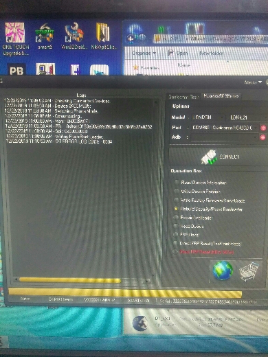

same condition i think not drivers problem as software connect and read ( Msm : 0x0009A0E1 )
12/22/2019 12:48:22 PM - Checking Connected Devices..
12/22/2019 12:48:22 PM - Device @COM985;
12/22/2019 12:48:22 PM - Switching Phone Mode..
12/22/2019 12:48:22 PM - Comunicating..
12/22/2019 12:48:22 PM - Msm : 0x0009A0E1
12/22/2019 12:48:22 PM - PBL : 0x0xcc3153a80293939b90d02d3bf8b23e0292e452fef662c7499
12/22/2019 12:48:22 PM - Sbl : 0x00000000
12/22/2019 12:48:23 PM - Writing Flash-Boot Loader..
12/22/2019 12:51:07 PM - DT ERROR LOG CODE - 0004
Habib Tech
Sep 11, 2019
147
26
Sudan
maybe try set com port to lower one, maybe software get mad in com985
12/22/2019 2:43:33 PM - Checking Connected Devices..
12/22/2019 2:43:33 PM - Device @COM91;
12/22/2019 2:43:33 PM - Switching Phone Mode..
12/22/2019 2:43:33 PM - Comunicating..
12/22/2019 2:43:33 PM - Msm : 0x0009A0E1
12/22/2019 2:43:33 PM - PBL : 0x0xcc3153a80293939b90d02d3bf8b23e0292e452fef662c7499
12/22/2019 2:43:33 PM - Sbl : 0x00000000
12/22/2019 2:43:33 PM - Writing Flash-Boot Loader..
12/22/2019 2:46:18 PM - DT ERROR LOG CODE - 0004
