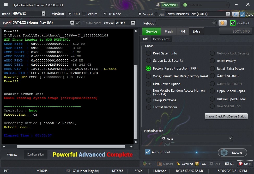

Huawei Honor Play 8A Google account remove with test point by hydra dongle
Brand : HUAWEI Model : JAT-LX3 (Honor Play 8A) Connection : Flash Mode
How To Boot : Remove Batt if possible
* TP Ground Must be near cpu..
* Remove ground upon popup of the message dialog.
Connection[WAITING]Found[COM7] Status[Opened]
Identifying Hardware ID
BROM CPUID : 0766 (0000)MT6765[6765]
FUSEID : 00000001
SECURE VERSION : 05
BL VERSION : FE
BR Secured : E5[SBC+SDA+SEL]
Security Authorization....
Sending[huawei_auth_sv5_.auth] Accepted
Preparing Download Agent..
Download Agent : Huawei__6765_8A00CA0000000000_00001000_00030000.bin
MTK_DOWNLOAD_AGENT -HYDRA
MTK_AllInOne_DA_v3.3001.2018/10/18.17:38_452898
Initializing Loader [1]
Sending Loader [1] Accepted
PROTOCOL[NEW] - eMMC
PHONE SYNC[Accepted]
DA Mode : brom
Preloader Initialization....
Parsing preloader_k62v1_64_mexico.bin
Sending FlashInit Accepted
Initializing Loader [2]
Sending Loader [2] Accepted
eMMC CID : 150100475036424D4201734197505613 - GP6BMB
UNICAL RID : ECC781A360AEBDDCC79F2D0B41821CFB
DA Speed : high-speed
Done!!!
Reading System Info
ERROR reading system image [corrupted/erased]
Autobackup Partitions
preloader[0x00000000-0x00080000]512 KB ->preloader.bin... Done
-> Renaming Preloader.... preloader_k62v1_64_mexico.bin
Creating Scatter file... C:\Hydra Tool\\Backup\Auto\__0766--()_150620152109\MT6765_Android_scatter.txt
pgpt[0x00000000-0x00008000]32 KB ->pgpt.bin... Done
frp[0x00108000-0x00208000]1024 KB ->frp.bin... Done
nvdata[0x00A08000-0x01A08000]16 MB ->nvdata.bin... Done
nvram[0x04400000-0x04900000]5 MB ->nvram.bin... Done
Done!!!
Done!!!
Reading System Info
Operation : Auto
Processing... Ok
Reboot Done!!
Elapsed Time : 00:00:37
