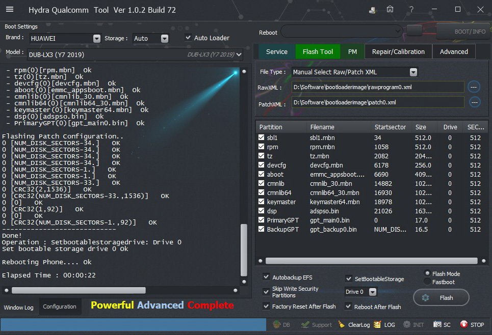

Hydra Huawei DUB-LX3 (Y7 2019) Successfully flashed by Hydra Tool
546
FriendlyName :Qualcomm HS-USB QDLoader 9008 (COM10)
SymbolicName :\??\USB#VID_05C6&PID_9008#5&111a2a81&0&2#{a5dcbf10-6530-11d2-901f-00c04fb951ed}
Driver Ver :03/19/2014,2.1.1.2
Getting device info......
Serial No.: 0xC9F01815
MSM ID : 0x0009A0E1, SDM450-Qualcomm Snapdragon 450
PBL Ver : 00000000
PK HASH : 6BC369511DA9CADB3A7AF61574F89DB3
85003D6241BDD1FF573DBA61BF6AE119
Firehose Loader[DUB-LX1_Loader_T-Tool-Team_1.mbn]
SaharaBoot... Ok
Sending .............Ok
Connecting to Firehose...
Ping... Ok
Configuration.......
Identifying Chip....
Ok
Chip Configuration :
MemoryName : eMMC
MaxXMLSizeInBytes : 4096
TargetName : 8953
Version : 1
*** STORAGE DEVICE INFO ***
Memory Type : eMMC
Block Size in Bytes : 512
Page Size : 512
Manufacturer ID : 144
Serial Number : 1018217474
Firmware Version : 0
Product Name : hB8aP>
Physical Partitions : 3
Total Logical Blocks:
Drive [0] 61071360[29,121 GB]
Drive [1] 8192[4 MB]
Drive [2] 8192[4 MB]
Protocol : Universal
Running : Ok
Phone Information.....
Vendor : unknown
SDK : 27
Release : 8.1.0
ABI : arm64-v8a
Locale : en-US
Description : generic_a53-user 8.1.0 OPM1.171019.011 eng.jenkin.20200730.185300 test-keys
Display ID : System 8.2.0.036(0F4J)
Security Patch : 2020-07-01
Reading GPT[3]
Drive [0] 60 Items
Drive [1] 0 Items
Drive [2] 0 Items
Backup Security partitions...
Reading Security Items....
> modemst1
> modemst2
> fsg
D:\HydraTool_Fullpackage_02-20-2021\Backup\Security_Backup\__8.1.0_Security_031721224648.sec
Backup Security Success....
- RPM(0)[RPM.img] Ok
- TZ(0)[TZ.img] Ok
- SBL1(0)[SBL1.img] Ok
- APDP(0)[APDP.img] Ok
- MSADP(0)[MSADP.img] Ok
- KEYMASTER(0)[KEYMASTER.img] Ok
- DEVCFG(0)[DEVCFG.img] Ok
- ABOOT(0)[ABOOT.img] Ok
- MODEM(0)[MODEM.img] Ok
- KERNEL(0)[KERNEL.img] Ok
- RAMDISK(0)[RAMDISK.img] Ok
- RECOVERY_RAMDISK(0)[RECOVERY_RAMDISK.img] Ok
- RECOVERY_VENDOR(0)[RECOVERY_VENDOR.img] Ok
- ERECOVERY_KERNEL(0)[ERECOVERY_KERNEL.img] Ok
- ERECOVERY_RAMDISK(0)[ERECOVERY_RAMDISK.img] Ok
- ERECOVERY_VENDOR(0)[ERECOVERY_VENDOR.img] Ok
- SYSTEM(0)[SYSTEM.img] Ok
- CACHE(0)[CACHE.img] Ok
- ODM(0)[ODM.img] Ok
- VENDOR(0)[VENDOR.img] Ok
- PRODUCT(0)[PRODUCT.img] Ok
- USERDATA(0)[USERDATA.img] Ok
0 [NUM_DISK_SECTORS-34.] OK
0 [NUM_DISK_SECTORS-1.] OK
0 [NUM_DISK_SECTORS-33.] OK
0 [CRC32(2,7168)] OK
0 [CRC32(NUM_DISK_SECTORS-33.,7168)] OK
0 [0] OK
0 [CRC32(1,92)] OK
0 [0] OK
Done!
Rebooting Phone.... Ok
Elapsed Time : 00:16:34
