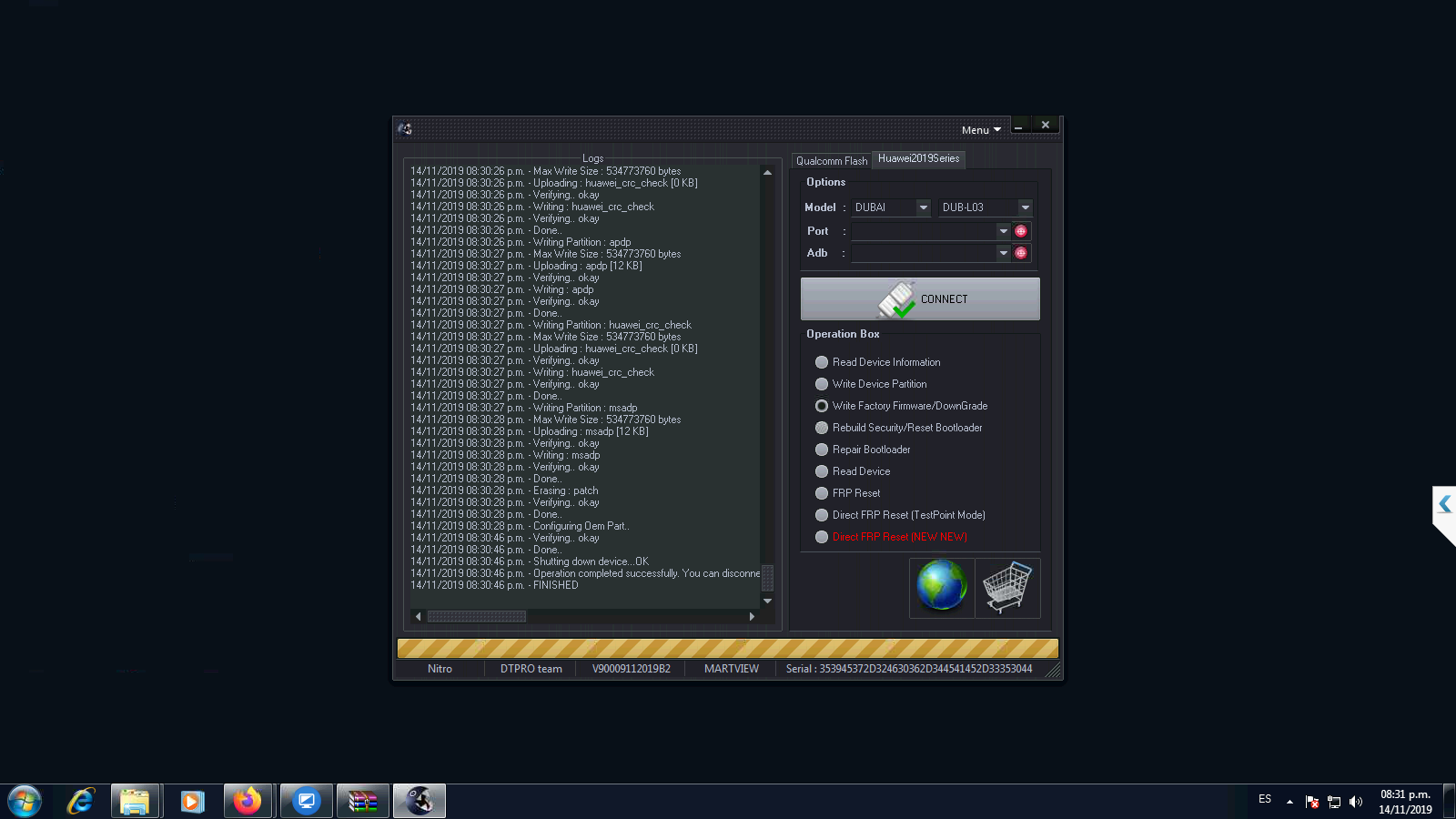

Huawei DUB-L03 Writing Factory Firmware Success!! - DTPRO Tool "Test report form PERU"
timperu
Oct 9, 2019
4
1
14/11/2019 08:26:56 p.m. - Initializing..
14/11/2019 08:26:56 p.m. - 1. Select "Xloader" option.
14/11/2019 08:26:56 p.m. - 2. Then select proper Xloader (*.xml or .DT) file.
14/11/2019 08:26:56 p.m. - 3. Perform "DownGradePRO" operation (All Security of Phone will be Disabled)
14/11/2019 08:26:56 p.m. - Selected interface: USB (KIRIN)
14/11/2019 08:26:56 p.m. - Checking USB driver status...OK (Kirin Flash Device 2.01.02.00)
14/11/2019 08:26:56 p.m. - Plug USB cable
14/11/2019 08:26:56 p.m. - Connected to USB1
14/11/2019 08:26:56 p.m. - Device identification...OK
14/11/2019 08:26:56 p.m. - Waiting for Device..
14/11/2019 08:26:56 p.m. - Comunicating..
14/11/2019 08:26:57 p.m. - NULL
NULL
NULL
14/11/2019 08:26:57 p.m. - Bootloader : IMAGE IS ORIGIN VERIFY MODE IS ENFORCING CHECK ROOT INFO IS SAFE LOCK STATE IS LOCK ROOT STATE UNROOT
14/11/2019 08:26:57 p.m. - Total Files to Process : 72
14/11/2019 08:26:57 p.m. - Writing Partition : huawei_crc_check
14/11/2019 08:26:57 p.m. - Max Write Size : 534773760 bytes
14/11/2019 08:26:57 p.m. - Uploading : huawei_crc_check [0 KB]
14/11/2019 08:26:57 p.m. - Verifying.. okay
14/11/2019 08:26:57 p.m. - Writing : huawei_crc_check
14/11/2019 08:26:57 p.m. - Done..
14/11/2019 08:26:57 p.m. - Writing Partition : partition
14/11/2019 08:26:57 p.m. - Uploading : partition [33 KB]
14/11/2019 08:26:57 p.m. - Writing : partition
14/11/2019 08:26:58 p.m. - Done..
14/11/2019 08:26:58 p.m. - Writing Partition : huawei_crc_check
14/11/2019 08:26:58 p.m. - Max Write Size : 534773760 bytes
14/11/2019 08:26:58 p.m. - Uploading : huawei_crc_check [0 KB]
14/11/2019 08:26:58 p.m. - Verifying.. okay
14/11/2019 08:26:58 p.m. - Writing : huawei_crc_check
14/11/2019 08:26:58 p.m. - Writing Partition : rpm
14/11/2019 08:26:58 p.m. - Uploading : rpm [170 KB]
14/11/2019 08:26:58 p.m. - Writing : rpm
14/11/2019 08:26:59 p.m. - Max Write Size : 534773760 bytes
14/11/2019 08:26:59 p.m. - Uploading : huawei_crc_check [0 KB]
14/11/2019 08:26:59 p.m. - Verifying.. okay
14/11/2019 08:26:59 p.m. - Writing : huawei_crc_check
14/11/2019 08:26:59 p.m. - Done..
14/11/2019 08:26:59 p.m. - Writing Partition : tz
14/11/2019 08:26:59 p.m. - Uploading : tz [1523 KB]
14/11/2019 08:26:59 p.m. - Writing : tz
14/11/2019 08:26:59 p.m. - Writing Partition : huawei_crc_check
14/11/2019 08:26:59 p.m. - Writing Partition : aboot
14/11/2019 08:27:00 p.m. - Max Write Size : 534773760 bytes
14/11/2019 08:27:00 p.m. - Uploading : aboot [2480 KB]
14/11/2019 08:27:00 p.m. - Verifying.. okay
14/11/2019 08:27:00 p.m. - Writing : aboot
14/11/2019 08:27:00 p.m. - Done..
14/11/2019 08:27:00 p.m. - Writing Partition : huawei_crc_check
14/11/2019 08:27:00 p.m. - Uploading : huawei_crc_check [0 KB]
14/11/2019 08:27:00 p.m. - Writing : huawei_crc_check
14/11/2019 08:27:00 p.m. - Writing Partition : ramdisk
14/11/2019 08:27:01 p.m. - Max Write Size : 534773760 bytes
14/11/2019 08:27:01 p.m. - Uploading : ramdisk [6887 KB]
14/11/2019 08:27:01 p.m. - Verifying.. okay
14/11/2019 08:27:01 p.m. - Writing : ramdisk
14/11/2019 08:27:01 p.m. - Done..
14/11/2019 08:27:01 p.m. - Writing Partition : huawei_crc_check
14/11/2019 08:27:01 p.m. - Uploading : huawei_crc_check [1 KB]
14/11/2019 08:27:01 p.m. - Writing : huawei_crc_check
14/11/2019 08:27:01 p.m. - Writing Partition : kernel
14/11/2019 08:27:03 p.m. - Max Write Size : 534773760 bytes
14/11/2019 08:27:03 p.m. - Uploading : kernel [24667 KB]
14/11/2019 08:27:03 p.m. - Verifying.. okay
14/11/2019 08:27:03 p.m. - Writing : kernel
14/11/2019 08:27:03 p.m. - Done..
14/11/2019 08:27:03 p.m. - Writing Partition : huawei_crc_check
14/11/2019 08:27:03 p.m. - Uploading : huawei_crc_check [1 KB]
14/11/2019 08:27:03 p.m. - Writing : huawei_crc_check
14/11/2019 08:27:03 p.m. - Writing Partition : recovery_ramdisk
14/11/2019 08:27:05 p.m. - Max Write Size : 534773760 bytes
14/11/2019 08:27:05 p.m. - Uploading : recovery_ramdisk [27877 KB]
14/11/2019 08:27:05 p.m. - Verifying.. okay
14/11/2019 08:27:05 p.m. - Writing : recovery_ramdisk
14/11/2019 08:27:05 p.m. - Done..
14/11/2019 08:27:05 p.m. - Writing Partition : huawei_crc_check
14/11/2019 08:27:06 p.m. - Max Write Size : 534773760 bytes
14/11/2019 08:27:06 p.m. - Uploading : huawei_crc_check [0 KB]
14/11/2019 08:27:06 p.m. - Verifying.. okay
14/11/2019 08:27:06 p.m. - Writing : huawei_crc_check
14/11/2019 08:27:06 p.m. - Done..
14/11/2019 08:27:06 p.m. - Writing Partition : recovery_vendor
14/11/2019 08:27:06 p.m. - Uploading : recovery_vendor [2545 KB]
14/11/2019 08:27:06 p.m. - Writing : recovery_vendor
14/11/2019 08:27:06 p.m. - Writing Partition : huawei_crc_check
14/11/2019 08:27:06 p.m. - Uploading : huawei_crc_check [1 KB]
14/11/2019 08:27:07 p.m. - Writing Partition : erecovery_kernel
14/11/2019 08:27:08 p.m. - Max Write Size : 534773760 bytes
14/11/2019 08:27:08 p.m. - Uploading : erecovery_kernel [24667 KB]
14/11/2019 08:27:08 p.m. - Verifying.. okay
14/11/2019 08:27:08 p.m. - Writing : erecovery_kernel
14/11/2019 08:27:08 p.m. - Done..
14/11/2019 08:27:08 p.m. - Writing Partition : huawei_crc_check
14/11/2019 08:27:09 p.m. - Max Write Size : 534773760 bytes
14/11/2019 08:27:09 p.m. - Uploading : huawei_crc_check [1 KB]
14/11/2019 08:27:09 p.m. - Verifying.. okay
14/11/2019 08:27:09 p.m. - Writing : huawei_crc_check
14/11/2019 08:27:09 p.m. - Done..
14/11/2019 08:27:09 p.m. - Writing Partition : erecovery_ramdisk
14/11/2019 08:27:10 p.m. - Max Write Size : 534773760 bytes
14/11/2019 08:27:10 p.m. - Uploading : erecovery_ramdisk [27877 KB]
14/11/2019 08:27:10 p.m. - Verifying.. okay
14/11/2019 08:27:10 p.m. - Writing : erecovery_ramdisk
14/11/2019 08:27:10 p.m. - Done..
14/11/2019 08:27:11 p.m. - Writing Partition : huawei_crc_check
14/11/2019 08:27:11 p.m. - Max Write Size : 534773760 bytes
14/11/2019 08:27:11 p.m. - Uploading : huawei_crc_check [0 KB]
14/11/2019 08:27:11 p.m. - Verifying.. okay
14/11/2019 08:27:11 p.m. - Writing : huawei_crc_check
14/11/2019 08:27:11 p.m. - Done..
14/11/2019 08:27:11 p.m. - Writing Partition : erecovery_vendor
14/11/2019 08:27:11 p.m. - Uploading : erecovery_vendor [2545 KB]
14/11/2019 08:27:11 p.m. - Writing : erecovery_vendor
14/11/2019 08:27:12 p.m. - Max Write Size : 534773760 bytes
14/11/2019 08:27:12 p.m. - Uploading : huawei_crc_check [7 KB]
14/11/2019 08:27:12 p.m. - Verifying.. okay
14/11/2019 08:27:12 p.m. - Writing : huawei_crc_check
14/11/2019 08:27:12 p.m. - Done..
14/11/2019 08:27:12 p.m. - Writing Partition : modem
14/11/2019 08:27:19 p.m. - Max Write Size : 534773760 bytes
14/11/2019 08:27:19 p.m. - Uploading : modem [122880 KB]
14/11/2019 08:27:19 p.m. - Verifying.. okay
14/11/2019 08:27:19 p.m. - Writing : modem
14/11/2019 08:27:19 p.m. - Done..
14/11/2019 08:27:19 p.m. - Erasing : cust
14/11/2019 08:27:19 p.m. - Erasing : misc
14/11/2019 08:27:20 p.m. - Done..
14/11/2019 08:27:20 p.m. - Erasing : bootfail_info
14/11/2019 08:27:20 p.m. - Verifying.. okay
14/11/2019 08:27:20 p.m. - Erasing : rrecord
14/11/2019 08:27:20 p.m. - Erasing : devinfo
14/11/2019 08:27:20 p.m. - Writing Partition : huawei_crc_check
14/11/2019 08:27:21 p.m. - Max Write Size : 534773760 bytes
14/11/2019 08:27:21 p.m. - Uploading : huawei_crc_check [174 KB]
14/11/2019 08:27:21 p.m. - Verifying.. okay
14/11/2019 08:27:21 p.m. - Writing : huawei_crc_check
14/11/2019 08:27:21 p.m. - Done..
14/11/2019 08:27:21 p.m. - Writing Partition : system
14/11/2019 08:29:17 p.m. - Max Write Size : 534773760 bytes
14/11/2019 08:29:17 p.m. - Uploading : sparse [521880 KB]
14/11/2019 08:29:17 p.m. - Verifying.. okay
14/11/2019 08:29:17 p.m. - Writing : system
14/11/2019 08:29:17 p.m. - Uploading : sparse [521522 KB]
14/11/2019 08:29:17 p.m. - Uploading : sparse [515125 KB]
14/11/2019 08:29:17 p.m. - Uploading : sparse [250558 KB]
14/11/2019 08:29:17 p.m. - Done..
14/11/2019 08:29:18 p.m. - Erasing : userdata
14/11/2019 08:29:18 p.m. - Verifying.. okay
14/11/2019 08:29:18 p.m. - Done..
14/11/2019 08:29:18 p.m. - Writing Partition : huawei_crc_check
14/11/2019 08:29:18 p.m. - Max Write Size : 534773760 bytes
14/11/2019 08:29:18 p.m. - Uploading : huawei_crc_check [256 KB]
14/11/2019 08:29:18 p.m. - Writing : huawei_crc_check
14/11/2019 08:29:18 p.m. - Writing Partition : userdata
14/11/2019 08:29:26 p.m. - Max Write Size : 534773760 bytes
14/11/2019 08:29:26 p.m. - Uploading : userdata [126976 KB]
14/11/2019 08:29:26 p.m. - Verifying.. okay
14/11/2019 08:29:26 p.m. - Writing : userdata
14/11/2019 08:29:26 p.m. - Done..
14/11/2019 08:29:26 p.m. - Writing Partition : huawei_crc_check
14/11/2019 08:29:26 p.m. - Uploading : huawei_crc_check [6 KB]
14/11/2019 08:29:26 p.m. - Writing : huawei_crc_check
14/11/2019 08:29:26 p.m. - Writing Partition : cache
14/11/2019 08:29:27 p.m. - Max Write Size : 534773760 bytes
14/11/2019 08:29:27 p.m. - Uploading : cache [5816 KB]
14/11/2019 08:29:27 p.m. - Verifying.. okay
14/11/2019 08:29:27 p.m. - Writing : cache
14/11/2019 08:29:27 p.m. - Done..
14/11/2019 08:29:27 p.m. - Writing Partition : huawei_crc_check
14/11/2019 08:29:27 p.m. - Uploading : huawei_crc_check [1 KB]
14/11/2019 08:29:27 p.m. - Writing : huawei_crc_check
14/11/2019 08:29:27 p.m. - Writing Partition : dsp
14/11/2019 08:29:28 p.m. - Max Write Size : 534773760 bytes
14/11/2019 08:29:28 p.m. - Uploading : dsp [16384 KB]
14/11/2019 08:29:28 p.m. - Verifying.. okay
14/11/2019 08:29:28 p.m. - Writing : dsp
14/11/2019 08:29:28 p.m. - Done..
14/11/2019 08:29:28 p.m. - Writing Partition : huawei_crc_check
14/11/2019 08:29:29 p.m. - Max Write Size : 534773760 bytes
14/11/2019 08:29:29 p.m. - Uploading : huawei_crc_check [0 KB]
14/11/2019 08:29:29 p.m. - Verifying.. okay
14/11/2019 08:29:29 p.m. - Writing : huawei_crc_check
14/11/2019 08:29:29 p.m. - Done..
14/11/2019 08:29:29 p.m. - Writing Partition : cmnlib
14/11/2019 08:29:29 p.m. - Uploading : cmnlib [208 KB]
14/11/2019 08:29:29 p.m. - Writing : cmnlib
14/11/2019 08:29:29 p.m. - Writing Partition : huawei_crc_check
14/11/2019 08:29:30 p.m. - Max Write Size : 534773760 bytes
14/11/2019 08:29:30 p.m. - Uploading : huawei_crc_check [0 KB]
14/11/2019 08:29:30 p.m. - Verifying.. okay
14/11/2019 08:29:30 p.m. - Writing : huawei_crc_check
14/11/2019 08:29:30 p.m. - Done..
14/11/2019 08:29:30 p.m. - Writing Partition : cmnlib64
14/11/2019 08:29:30 p.m. - Uploading : cmnlib64 [262 KB]
14/11/2019 08:29:30 p.m. - Writing : cmnlib64
14/11/2019 08:29:30 p.m. - Writing Partition : huawei_crc_check
14/11/2019 08:29:31 p.m. - Max Write Size : 534773760 bytes
14/11/2019 08:29:31 p.m. - Uploading : huawei_crc_check [0 KB]
14/11/2019 08:29:31 p.m. - Verifying.. okay
14/11/2019 08:29:31 p.m. - Writing : huawei_crc_check
14/11/2019 08:29:31 p.m. - Done..
14/11/2019 08:29:31 p.m. - Writing Partition : devcfg
14/11/2019 08:29:31 p.m. - Uploading : devcfg [38 KB]
14/11/2019 08:29:31 p.m. - Writing : devcfg
14/11/2019 08:29:31 p.m. - Writing Partition : huawei_crc_check
14/11/2019 08:29:32 p.m. - Max Write Size : 534773760 bytes
14/11/2019 08:29:32 p.m. - Uploading : huawei_crc_check [0 KB]
14/11/2019 08:29:32 p.m. - Verifying.. okay
14/11/2019 08:29:32 p.m. - Writing : huawei_crc_check
14/11/2019 08:29:32 p.m. - Done..
14/11/2019 08:29:32 p.m. - Writing Partition : keymaster
14/11/2019 08:29:32 p.m. - Uploading : keymaster [265 KB]
14/11/2019 08:29:32 p.m. - Writing : keymaster
14/11/2019 08:29:32 p.m. - Writing Partition : huawei_crc_check
14/11/2019 08:29:33 p.m. - Max Write Size : 534773760 bytes
14/11/2019 08:29:33 p.m. - Uploading : huawei_crc_check [0 KB]
14/11/2019 08:29:33 p.m. - Verifying.. okay
14/11/2019 08:29:33 p.m. - Writing : huawei_crc_check
14/11/2019 08:29:33 p.m. - Done..
14/11/2019 08:29:33 p.m. - Writing Partition : modemst1
14/11/2019 08:29:33 p.m. - Uploading : modemst1 [4096 KB]
14/11/2019 08:29:33 p.m. - Writing : modemst1
14/11/2019 08:29:33 p.m. - Writing Partition : huawei_crc_check
14/11/2019 08:29:34 p.m. - Max Write Size : 534773760 bytes
14/11/2019 08:29:34 p.m. - Uploading : huawei_crc_check [0 KB]
14/11/2019 08:29:34 p.m. - Verifying.. okay
14/11/2019 08:29:34 p.m. - Writing : huawei_crc_check
14/11/2019 08:29:34 p.m. - Done..
14/11/2019 08:29:34 p.m. - Writing Partition : modemst2
14/11/2019 08:29:34 p.m. - Uploading : modemst2 [4096 KB]
14/11/2019 08:29:34 p.m. - Writing : modemst2
14/11/2019 08:29:35 p.m. - Verifying.. okay
14/11/2019 08:29:35 p.m. - Done..
14/11/2019 08:29:35 p.m. - Erasing : product
14/11/2019 08:29:35 p.m. - Writing Partition : huawei_crc_check
14/11/2019 08:29:35 p.m. - Max Write Size : 534773760 bytes
14/11/2019 08:29:35 p.m. - Uploading : huawei_crc_check [12 KB]
14/11/2019 08:29:35 p.m. - Writing : huawei_crc_check
14/11/2019 08:29:35 p.m. - Writing Partition : product
14/11/2019 08:29:43 p.m. - Max Write Size : 534773760 bytes
14/11/2019 08:29:43 p.m. - Erasing : product
14/11/2019 08:29:43 p.m. - Verifying.. okay
14/11/2019 08:29:43 p.m. - Uploading : product [133016 KB]
14/11/2019 08:29:43 p.m. - Writing : product
14/11/2019 08:29:43 p.m. - Done..
14/11/2019 08:29:43 p.m. - Writing Partition : huawei_crc_check
14/11/2019 08:29:44 p.m. - Max Write Size : 534773760 bytes
14/11/2019 08:29:44 p.m. - Uploading : huawei_crc_check [34 KB]
14/11/2019 08:29:44 p.m. - Verifying.. okay
14/11/2019 08:29:44 p.m. - Writing : huawei_crc_check
14/11/2019 08:29:44 p.m. - Done..
14/11/2019 08:29:44 p.m. - Writing Partition : vendor
14/11/2019 08:30:12 p.m. - Max Write Size : 534773760 bytes
14/11/2019 08:30:12 p.m. - Erasing : vendor
14/11/2019 08:30:12 p.m. - Verifying.. okay
14/11/2019 08:30:12 p.m. - Uploading : vendor [456006 KB]
14/11/2019 08:30:12 p.m. - Writing : vendor
14/11/2019 08:30:12 p.m. - Done..
14/11/2019 08:30:12 p.m. - Erasing : version
14/11/2019 08:30:12 p.m. - Writing Partition : huawei_crc_check
14/11/2019 08:30:13 p.m. - Max Write Size : 534773760 bytes
14/11/2019 08:30:13 p.m. - Uploading : huawei_crc_check [2 KB]
14/11/2019 08:30:13 p.m. - Verifying.. okay
14/11/2019 08:30:13 p.m. - Writing : huawei_crc_check
14/11/2019 08:30:13 p.m. - Done..
14/11/2019 08:30:13 p.m. - Writing Partition : version
14/11/2019 08:30:14 p.m. - Max Write Size : 534773760 bytes
14/11/2019 08:30:14 p.m. - Erasing : version
14/11/2019 08:30:14 p.m. - Verifying.. okay
14/11/2019 08:30:14 p.m. - Uploading : version [6216 KB]
14/11/2019 08:30:14 p.m. - Writing : version
14/11/2019 08:30:14 p.m. - Done..
14/11/2019 08:30:14 p.m. - Writing Partition : huawei_crc_check
14/11/2019 08:30:14 p.m. - Uploading : huawei_crc_check [5 KB]
14/11/2019 08:30:14 p.m. - Writing : huawei_crc_check
14/11/2019 08:30:14 p.m. - Writing Partition : odm
14/11/2019 08:30:21 p.m. - Max Write Size : 534773760 bytes
14/11/2019 08:30:21 p.m. - Erasing : odm
14/11/2019 08:30:21 p.m. - Verifying.. okay
14/11/2019 08:30:21 p.m. - Uploading : odm [50614 KB]
14/11/2019 08:30:21 p.m. - Writing : odm
14/11/2019 08:30:21 p.m. - Done..
14/11/2019 08:30:21 p.m. - Writing Partition : huawei_crc_check
14/11/2019 08:30:22 p.m. - Max Write Size : 534773760 bytes
14/11/2019 08:30:22 p.m. - Uploading : huawei_crc_check [2 KB]
14/11/2019 08:30:22 p.m. - Verifying.. okay
14/11/2019 08:30:22 p.m. - Writing : huawei_crc_check
14/11/2019 08:30:22 p.m. - Done..
14/11/2019 08:30:22 p.m. - Writing Partition : log
14/11/2019 08:30:24 p.m. - Max Write Size : 534773760 bytes
14/11/2019 08:30:24 p.m. - Uploading : log [32768 KB]
14/11/2019 08:30:24 p.m. - Verifying.. okay
14/11/2019 08:30:24 p.m. - Writing : log
14/11/2019 08:30:24 p.m. - Done..
14/11/2019 08:30:24 p.m. - Writing Partition : huawei_crc_check
14/11/2019 08:30:24 p.m. - Uploading : huawei_crc_check [0 KB]
14/11/2019 08:30:24 p.m. - Writing : huawei_crc_check
14/11/2019 08:30:24 p.m. - Writing Partition : sbl1
14/11/2019 08:30:25 p.m. - Max Write Size : 534773760 bytes
14/11/2019 08:30:25 p.m. - Uploading : sbl1 [440 KB]
14/11/2019 08:30:25 p.m. - Verifying.. okay
14/11/2019 08:30:25 p.m. - Writing : sbl1
14/11/2019 08:30:25 p.m. - Done..
14/11/2019 08:30:25 p.m. - Writing Partition : huawei_crc_check
14/11/2019 08:30:25 p.m. - Uploading : huawei_crc_check [0 KB]
14/11/2019 08:30:25 p.m. - Writing : huawei_crc_check
14/11/2019 08:30:25 p.m. - Writing Partition : sec
14/11/2019 08:30:26 p.m. - Max Write Size : 534773760 bytes
14/11/2019 08:30:26 p.m. - Uploading : sec [0 KB]
14/11/2019 08:30:26 p.m. - Verifying.. okay
14/11/2019 08:30:26 p.m. - Writing : sec
14/11/2019 08:30:26 p.m. - Done..
14/11/2019 08:30:26 p.m. - Writing Partition : huawei_crc_check
14/11/2019 08:30:26 p.m. - Uploading : huawei_crc_check [0 KB]
14/11/2019 08:30:26 p.m. - Writing : huawei_crc_check
14/11/2019 08:30:26 p.m. - Writing Partition : apdp
14/11/2019 08:30:27 p.m. - Max Write Size : 534773760 bytes
14/11/2019 08:30:27 p.m. - Uploading : apdp [12 KB]
14/11/2019 08:30:27 p.m. - Verifying.. okay
14/11/2019 08:30:27 p.m. - Writing : apdp
14/11/2019 08:30:27 p.m. - Done..
14/11/2019 08:30:27 p.m. - Writing Partition : huawei_crc_check
14/11/2019 08:30:27 p.m. - Uploading : huawei_crc_check [0 KB]
14/11/2019 08:30:27 p.m. - Writing : huawei_crc_check
14/11/2019 08:30:27 p.m. - Writing Partition : msadp
14/11/2019 08:30:28 p.m. - Max Write Size : 534773760 bytes
14/11/2019 08:30:28 p.m. - Uploading : msadp [12 KB]
14/11/2019 08:30:28 p.m. - Verifying.. okay
14/11/2019 08:30:28 p.m. - Writing : msadp
14/11/2019 08:30:28 p.m. - Done..
14/11/2019 08:30:28 p.m. - Erasing : patch
14/11/2019 08:30:28 p.m. - Configuring Oem Part..
14/11/2019 08:30:46 p.m. - Verifying.. okay
14/11/2019 08:30:46 p.m. - Done..
14/11/2019 08:30:46 p.m. - Shutting down device...OK
14/11/2019 08:30:46 p.m. - Operation completed successfully. You can disconnect the phone now
14/11/2019 08:30:46 p.m. - FINISHED
