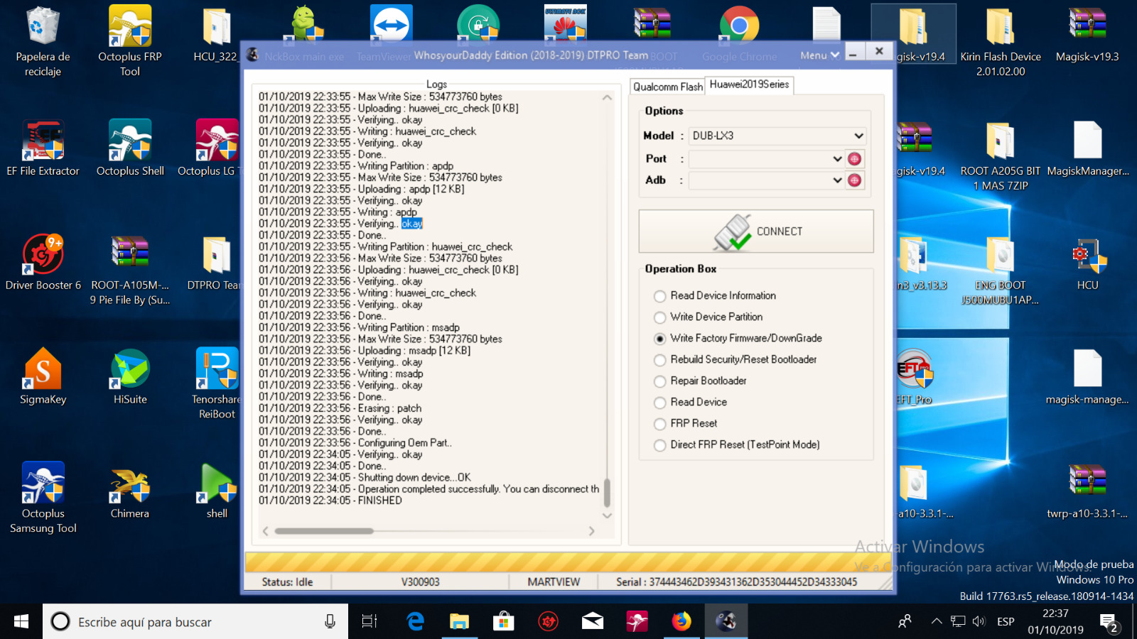

Huawei DUB-L03 DownGrade Success (test report) from Uruguay
Oct 2, 2019
8
1
01/10/2019 22:31:11 - 1. Select "Xloader" option.
01/10/2019 22:31:11 - 2. Then select proper Xloader (*.xml or .DT) file.
01/10/2019 22:31:11 - 3. Perform "DownGradePRO" operation (All Security of Phone will be Disabled)
01/10/2019 22:31:11 - Selected interface: USB (KIRIN)
01/10/2019 22:31:11 - Checking USB driver status...OK (Kirin Flash Device 2.01.02.00)
01/10/2019 22:31:11 - Plug USB cable
01/10/2019 22:31:11 - Connected to USB1
01/10/2019 22:31:11 - Device identification...OK
01/10/2019 22:31:11 - Waiting for Device..
01/10/2019 22:31:12 - Comunicating..
01/10/2019 22:31:12 - NULL
NULL
NULL
01/10/2019 22:31:13 - Bootloader : IMAGE IS ORIGIN VERIFY MODE IS ENFORCING CHECK ROOT INFO IS SAFE LOCK STATE IS LOCK ROOT STATE UNROOT
01/10/2019 22:31:13 - Total Files to Process : 72
01/10/2019 22:31:13 - Writing Partition : huawei_crc_check
01/10/2019 22:31:13 - Writing Partition : partition
01/10/2019 22:31:13 - Max Write Size : 534773760 bytes
01/10/2019 22:31:13 - Uploading : partition [33 KB]
01/10/2019 22:31:13 - Verifying.. okay
01/10/2019 22:31:13 - Writing : partition
01/10/2019 22:31:13 - Done..
01/10/2019 22:31:14 - Max Write Size : 534773760 bytes
01/10/2019 22:31:14 - Uploading : huawei_crc_check [0 KB]
01/10/2019 22:31:14 - Verifying.. okay
01/10/2019 22:31:14 - Writing : huawei_crc_check
01/10/2019 22:31:14 - Done..
01/10/2019 22:31:14 - Writing Partition : rpm
01/10/2019 22:31:14 - Uploading : rpm [170 KB]
01/10/2019 22:31:14 - Writing : rpm
01/10/2019 22:31:14 - Writing Partition : huawei_crc_check
01/10/2019 22:31:14 - Writing Partition : tz
01/10/2019 22:31:15 - Max Write Size : 534773760 bytes
01/10/2019 22:31:15 - Uploading : tz [1523 KB]
01/10/2019 22:31:15 - Verifying.. okay
01/10/2019 22:31:15 - Writing : tz
01/10/2019 22:31:15 - Done..
01/10/2019 22:31:15 - Writing Partition : huawei_crc_check
01/10/2019 22:31:15 - Uploading : huawei_crc_check [0 KB]
01/10/2019 22:31:15 - Writing : huawei_crc_check
01/10/2019 22:31:15 - Writing Partition : aboot
01/10/2019 22:31:16 - Max Write Size : 534773760 bytes
01/10/2019 22:31:16 - Uploading : aboot [2480 KB]
01/10/2019 22:31:16 - Verifying.. okay
01/10/2019 22:31:16 - Writing : aboot
01/10/2019 22:31:16 - Done..
01/10/2019 22:31:16 - Writing Partition : huawei_crc_check
01/10/2019 22:31:16 - Uploading : huawei_crc_check [0 KB]
01/10/2019 22:31:16 - Writing : huawei_crc_check
01/10/2019 22:31:16 - Writing Partition : ramdisk
01/10/2019 22:31:17 - Max Write Size : 534773760 bytes
01/10/2019 22:31:17 - Uploading : ramdisk [6887 KB]
01/10/2019 22:31:17 - Verifying.. okay
01/10/2019 22:31:17 - Writing : ramdisk
01/10/2019 22:31:17 - Done..
01/10/2019 22:31:17 - Writing Partition : huawei_crc_check
01/10/2019 22:31:17 - Uploading : huawei_crc_check [1 KB]
01/10/2019 22:31:17 - Writing : huawei_crc_check
01/10/2019 22:31:17 - Writing Partition : kernel
01/10/2019 22:31:19 - Max Write Size : 534773760 bytes
01/10/2019 22:31:19 - Uploading : kernel [24667 KB]
01/10/2019 22:31:19 - Verifying.. okay
01/10/2019 22:31:19 - Writing : kernel
01/10/2019 22:31:19 - Done..
01/10/2019 22:31:19 - Writing Partition : huawei_crc_check
01/10/2019 22:31:19 - Uploading : huawei_crc_check [1 KB]
01/10/2019 22:31:19 - Writing : huawei_crc_check
01/10/2019 22:31:19 - Writing Partition : recovery_ramdisk
01/10/2019 22:31:21 - Max Write Size : 534773760 bytes
01/10/2019 22:31:21 - Uploading : recovery_ramdisk [27877 KB]
01/10/2019 22:31:21 - Verifying.. okay
01/10/2019 22:31:21 - Writing : recovery_ramdisk
01/10/2019 22:31:21 - Done..
01/10/2019 22:31:21 - Writing Partition : huawei_crc_check
01/10/2019 22:31:21 - Uploading : huawei_crc_check [0 KB]
01/10/2019 22:31:21 - Writing : huawei_crc_check
01/10/2019 22:31:21 - Writing Partition : recovery_vendor
01/10/2019 22:31:22 - Max Write Size : 534773760 bytes
01/10/2019 22:31:22 - Uploading : recovery_vendor [2545 KB]
01/10/2019 22:31:22 - Verifying.. okay
01/10/2019 22:31:22 - Writing : recovery_vendor
01/10/2019 22:31:22 - Done..
01/10/2019 22:31:22 - Writing Partition : huawei_crc_check
01/10/2019 22:31:22 - Uploading : huawei_crc_check [1 KB]
01/10/2019 22:31:22 - Writing : huawei_crc_check
01/10/2019 22:31:22 - Writing Partition : erecovery_kernel
01/10/2019 22:31:23 - Max Write Size : 534773760 bytes
01/10/2019 22:31:23 - Uploading : erecovery_kernel [24667 KB]
01/10/2019 22:31:23 - Verifying.. okay
01/10/2019 22:31:23 - Writing : erecovery_kernel
01/10/2019 22:31:23 - Done..
01/10/2019 22:31:23 - Writing Partition : huawei_crc_check
01/10/2019 22:31:24 - Max Write Size : 534773760 bytes
01/10/2019 22:31:24 - Uploading : huawei_crc_check [1 KB]
01/10/2019 22:31:24 - Verifying.. okay
01/10/2019 22:31:24 - Writing : huawei_crc_check
01/10/2019 22:31:24 - Done..
01/10/2019 22:31:24 - Writing Partition : erecovery_ramdisk
01/10/2019 22:31:25 - Max Write Size : 534773760 bytes
01/10/2019 22:31:25 - Uploading : erecovery_ramdisk [27877 KB]
01/10/2019 22:31:25 - Verifying.. okay
01/10/2019 22:31:25 - Writing : erecovery_ramdisk
01/10/2019 22:31:25 - Done..
01/10/2019 22:31:25 - Writing Partition : huawei_crc_check
01/10/2019 22:31:26 - Max Write Size : 534773760 bytes
01/10/2019 22:31:26 - Uploading : huawei_crc_check [0 KB]
01/10/2019 22:31:26 - Verifying.. okay
01/10/2019 22:31:26 - Writing : huawei_crc_check
01/10/2019 22:31:26 - Done..
01/10/2019 22:31:26 - Writing Partition : erecovery_vendor
01/10/2019 22:31:26 - Uploading : erecovery_vendor [2545 KB]
01/10/2019 22:31:26 - Writing : erecovery_vendor
01/10/2019 22:31:26 - Writing Partition : huawei_crc_check
01/10/2019 22:31:27 - Max Write Size : 534773760 bytes
01/10/2019 22:31:27 - Uploading : huawei_crc_check [7 KB]
01/10/2019 22:31:27 - Verifying.. okay
01/10/2019 22:31:27 - Writing : huawei_crc_check
01/10/2019 22:31:27 - Done..
01/10/2019 22:31:27 - Writing Partition : modem
01/10/2019 22:31:32 - Max Write Size : 534773760 bytes
01/10/2019 22:31:32 - Uploading : modem [122880 KB]
01/10/2019 22:31:32 - Verifying.. okay
01/10/2019 22:31:32 - Writing : modem
01/10/2019 22:31:32 - Done..
01/10/2019 22:31:33 - Erasing : cust
01/10/2019 22:31:33 - Verifying.. okay
01/10/2019 22:31:33 - Done..
01/10/2019 22:31:33 - Erasing : misc
01/10/2019 22:31:33 - Erasing : bootfail_info
01/10/2019 22:31:33 - Erasing : rrecord
01/10/2019 22:31:34 - Erasing : devinfo
01/10/2019 22:31:34 - Verifying.. okay
01/10/2019 22:31:34 - Done..
01/10/2019 22:31:34 - Writing Partition : huawei_crc_check
01/10/2019 22:31:34 - Max Write Size : 534773760 bytes
01/10/2019 22:31:34 - Uploading : huawei_crc_check [174 KB]
01/10/2019 22:31:34 - Writing : huawei_crc_check
01/10/2019 22:31:34 - Writing Partition : system
01/10/2019 22:33:00 - Max Write Size : 534773760 bytes
01/10/2019 22:33:00 - Uploading : sparse [521880 KB]
01/10/2019 22:33:00 - Verifying.. okay
01/10/2019 22:33:00 - Writing : system
01/10/2019 22:33:00 - Uploading : sparse [521522 KB]
01/10/2019 22:33:00 - Uploading : sparse [515125 KB]
01/10/2019 22:33:00 - Uploading : sparse [250558 KB]
01/10/2019 22:33:01 - Verifying.. okay
01/10/2019 22:33:01 - Writing : system
01/10/2019 22:33:01 - Done..
01/10/2019 22:33:01 - Erasing : userdata
01/10/2019 22:33:01 - Writing Partition : huawei_crc_check
01/10/2019 22:33:01 - Max Write Size : 534773760 bytes
01/10/2019 22:33:01 - Uploading : huawei_crc_check [256 KB]
01/10/2019 22:33:01 - Writing : huawei_crc_check
01/10/2019 22:33:01 - Writing Partition : userdata
01/10/2019 22:33:07 - Max Write Size : 534773760 bytes
01/10/2019 22:33:07 - Uploading : userdata [126976 KB]
01/10/2019 22:33:07 - Verifying.. okay
01/10/2019 22:33:07 - Writing : userdata
01/10/2019 22:33:07 - Done..
01/10/2019 22:33:07 - Writing Partition : huawei_crc_check
01/10/2019 22:33:08 - Max Write Size : 534773760 bytes
01/10/2019 22:33:08 - Uploading : huawei_crc_check [6 KB]
01/10/2019 22:33:08 - Verifying.. okay
01/10/2019 22:33:08 - Writing : huawei_crc_check
01/10/2019 22:33:08 - Done..
01/10/2019 22:33:08 - Writing Partition : cache
01/10/2019 22:33:08 - Uploading : cache [5816 KB]
01/10/2019 22:33:08 - Writing : cache
01/10/2019 22:33:08 - Writing Partition : huawei_crc_check
01/10/2019 22:33:09 - Max Write Size : 534773760 bytes
01/10/2019 22:33:09 - Uploading : huawei_crc_check [1 KB]
01/10/2019 22:33:09 - Verifying.. okay
01/10/2019 22:33:09 - Writing : huawei_crc_check
01/10/2019 22:33:09 - Done..
01/10/2019 22:33:09 - Writing Partition : dsp
01/10/2019 22:33:10 - Max Write Size : 534773760 bytes
01/10/2019 22:33:10 - Uploading : dsp [16384 KB]
01/10/2019 22:33:10 - Verifying.. okay
01/10/2019 22:33:10 - Writing : dsp
01/10/2019 22:33:10 - Done..
01/10/2019 22:33:10 - Writing Partition : huawei_crc_check
01/10/2019 22:33:10 - Writing Partition : cmnlib
01/10/2019 22:33:11 - Max Write Size : 534773760 bytes
01/10/2019 22:33:11 - Uploading : huawei_crc_check [0 KB]
01/10/2019 22:33:11 - Verifying.. okay
01/10/2019 22:33:11 - Writing : huawei_crc_check
01/10/2019 22:33:11 - Done..
01/10/2019 22:33:11 - Writing Partition : cmnlib64
01/10/2019 22:33:11 - Uploading : cmnlib64 [262 KB]
01/10/2019 22:33:11 - Writing : cmnlib64
01/10/2019 22:33:11 - Writing Partition : huawei_crc_check
01/10/2019 22:33:12 - Max Write Size : 534773760 bytes
01/10/2019 22:33:12 - Uploading : huawei_crc_check [0 KB]
01/10/2019 22:33:12 - Verifying.. okay
01/10/2019 22:33:12 - Writing : huawei_crc_check
01/10/2019 22:33:12 - Done..
01/10/2019 22:33:12 - Writing Partition : devcfg
01/10/2019 22:33:12 - Uploading : devcfg [38 KB]
01/10/2019 22:33:12 - Writing : devcfg
01/10/2019 22:33:12 - Writing Partition : huawei_crc_check
01/10/2019 22:33:12 - Writing Partition : keymaster
01/10/2019 22:33:13 - Max Write Size : 534773760 bytes
01/10/2019 22:33:13 - Uploading : keymaster [265 KB]
01/10/2019 22:33:13 - Verifying.. okay
01/10/2019 22:33:13 - Writing : keymaster
01/10/2019 22:33:13 - Done..
01/10/2019 22:33:13 - Writing Partition : huawei_crc_check
01/10/2019 22:33:13 - Uploading : huawei_crc_check [0 KB]
01/10/2019 22:33:13 - Writing : huawei_crc_check
01/10/2019 22:33:13 - Writing Partition : modemst1
01/10/2019 22:33:14 - Max Write Size : 534773760 bytes
01/10/2019 22:33:14 - Uploading : modemst1 [4096 KB]
01/10/2019 22:33:14 - Verifying.. okay
01/10/2019 22:33:14 - Writing : modemst1
01/10/2019 22:33:14 - Done..
01/10/2019 22:33:14 - Writing Partition : huawei_crc_check
01/10/2019 22:33:14 - Uploading : huawei_crc_check [0 KB]
01/10/2019 22:33:14 - Writing : huawei_crc_check
01/10/2019 22:33:14 - Writing Partition : modemst2
01/10/2019 22:33:15 - Max Write Size : 534773760 bytes
01/10/2019 22:33:15 - Uploading : modemst2 [4096 KB]
01/10/2019 22:33:15 - Verifying.. okay
01/10/2019 22:33:15 - Writing : modemst2
01/10/2019 22:33:15 - Done..
01/10/2019 22:33:15 - Erasing : product
01/10/2019 22:33:15 - Writing Partition : huawei_crc_check
01/10/2019 22:33:15 - Uploading : huawei_crc_check [12 KB]
01/10/2019 22:33:15 - Writing : huawei_crc_check
01/10/2019 22:33:15 - Writing Partition : product
01/10/2019 22:33:22 - Max Write Size : 534773760 bytes
01/10/2019 22:33:22 - Erasing : product
01/10/2019 22:33:22 - Verifying.. okay
01/10/2019 22:33:22 - Uploading : product [133016 KB]
01/10/2019 22:33:22 - Writing : product
01/10/2019 22:33:22 - Done..
01/10/2019 22:33:22 - Writing Partition : huawei_crc_check
01/10/2019 22:33:22 - Uploading : huawei_crc_check [34 KB]
01/10/2019 22:33:22 - Writing : huawei_crc_check
01/10/2019 22:33:22 - Writing Partition : vendor
01/10/2019 22:33:44 - Max Write Size : 534773760 bytes
01/10/2019 22:33:44 - Erasing : vendor
01/10/2019 22:33:44 - Verifying.. okay
01/10/2019 22:33:44 - Uploading : vendor [456006 KB]
01/10/2019 22:33:44 - Writing : vendor
01/10/2019 22:33:44 - Done..
01/10/2019 22:33:44 - Erasing : version
01/10/2019 22:33:44 - Writing Partition : huawei_crc_check
01/10/2019 22:33:44 - Uploading : huawei_crc_check [2 KB]
01/10/2019 22:33:44 - Writing : huawei_crc_check
01/10/2019 22:33:44 - Writing Partition : version
01/10/2019 22:33:45 - Max Write Size : 534773760 bytes
01/10/2019 22:33:45 - Erasing : version
01/10/2019 22:33:45 - Verifying.. okay
01/10/2019 22:33:45 - Uploading : version [6216 KB]
01/10/2019 22:33:45 - Writing : version
01/10/2019 22:33:45 - Done..
01/10/2019 22:33:45 - Writing Partition : huawei_crc_check
01/10/2019 22:33:45 - Uploading : huawei_crc_check [5 KB]
01/10/2019 22:33:45 - Writing : huawei_crc_check
01/10/2019 22:33:45 - Writing Partition : odm
01/10/2019 22:33:51 - Max Write Size : 534773760 bytes
01/10/2019 22:33:51 - Erasing : odm
01/10/2019 22:33:51 - Verifying.. okay
01/10/2019 22:33:51 - Uploading : odm [50614 KB]
01/10/2019 22:33:51 - Writing : odm
01/10/2019 22:33:51 - Done..
01/10/2019 22:33:51 - Writing Partition : huawei_crc_check
01/10/2019 22:33:51 - Uploading : huawei_crc_check [2 KB]
01/10/2019 22:33:51 - Writing : huawei_crc_check
01/10/2019 22:33:51 - Writing Partition : log
01/10/2019 22:33:53 - Max Write Size : 534773760 bytes
01/10/2019 22:33:53 - Uploading : log [32768 KB]
01/10/2019 22:33:53 - Verifying.. okay
01/10/2019 22:33:53 - Writing : log
01/10/2019 22:33:53 - Done..
01/10/2019 22:33:53 - Writing Partition : huawei_crc_check
01/10/2019 22:33:53 - Uploading : huawei_crc_check [0 KB]
01/10/2019 22:33:53 - Writing : huawei_crc_check
01/10/2019 22:33:53 - Writing Partition : sbl1
01/10/2019 22:33:54 - Max Write Size : 534773760 bytes
01/10/2019 22:33:54 - Uploading : sbl1 [440 KB]
01/10/2019 22:33:54 - Verifying.. okay
01/10/2019 22:33:54 - Writing : sbl1
01/10/2019 22:33:54 - Done..
01/10/2019 22:33:54 - Writing Partition : huawei_crc_check
01/10/2019 22:33:54 - Uploading : huawei_crc_check [0 KB]
01/10/2019 22:33:54 - Writing : huawei_crc_check
01/10/2019 22:33:54 - Writing Partition : sec
01/10/2019 22:33:54 - Uploading : sec [0 KB]
01/10/2019 22:33:54 - Writing : sec
01/10/2019 22:33:55 - Max Write Size : 534773760 bytes
01/10/2019 22:33:55 - Uploading : huawei_crc_check [0 KB]
01/10/2019 22:33:55 - Verifying.. okay
01/10/2019 22:33:55 - Writing : huawei_crc_check
01/10/2019 22:33:55 - Done..
01/10/2019 22:33:55 - Writing Partition : apdp
01/10/2019 22:33:55 - Uploading : apdp [12 KB]
01/10/2019 22:33:55 - Writing : apdp
01/10/2019 22:33:55 - Writing Partition : huawei_crc_check
01/10/2019 22:33:56 - Max Write Size : 534773760 bytes
01/10/2019 22:33:56 - Uploading : huawei_crc_check [0 KB]
01/10/2019 22:33:56 - Verifying.. okay
01/10/2019 22:33:56 - Writing : huawei_crc_check
01/10/2019 22:33:56 - Done..
01/10/2019 22:33:56 - Writing Partition : msadp
01/10/2019 22:33:56 - Uploading : msadp [12 KB]
01/10/2019 22:33:56 - Writing : msadp
01/10/2019 22:33:56 - Erasing : patch
01/10/2019 22:33:56 - Configuring Oem Part..
01/10/2019 22:34:05 - Verifying.. okay
01/10/2019 22:34:05 - Done..
01/10/2019 22:34:05 - Shutting down device...OK
01/10/2019 22:34:05 - Operation completed successfully. You can disconnect the phone now
01/10/2019 22:34:05 - FINISHED
