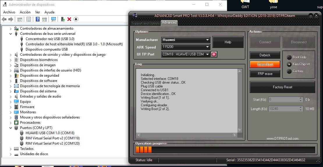

Huawei BAC-L23 8.0.0.334(C469) Downgrade Success!! World First
unlockxd
Aug 2, 2019
8
6
Initializing..
Selected interface: COM18
Checking USB driver status...OK
Plug USB cable
Connected to USB1
Device identification...OK
Writing Boot [1 of 1]..
Verifying ok..
Configuring xloader..
Writing Boot [2 of 2]..
Verifying ok..
Rebooting to Bootloader Mode..
Waiting for Phone in (Fastboot)
Comunicating..
Model : BAC-L23
Build : BAC-L23 8.0.0.334(C469)
Serial AUYDU18130000902
Imei 864843030350456
Imei 1864843030362469
MEID 00000000000000
Bootloader :ERASED/UNLOCKED
Done..

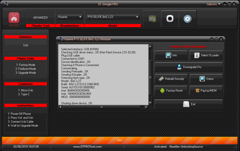

Initializing..
1. Select "Xloader" option.
2. Then select proper Xloader (*.xml or .DT) file.
3. Perform "DownGradePRO" operation (All Security of Phone will be Disabled)
Selected interface: USB (KIRIN)
Checking USB driver status...OK (Kirin Flash Device 2.01.02.00)
Plug USB cable
Connected to USB1
Comunicating..
Sending Preloader...OK
Sending IDloader...OK
Detecting flash type...OK
Model : BAC-L23
MEID 00000000000000
Total Files to Process : 28
Writing Partition : ptable
Max Write Size : 471859200 bytes
Uploading : ptable [17 KB]
Verifying.. okay
Writing : ptable
Verifying.. okay
Done..
Writing Partition : xloader
Uploading : xloader [68 KB]
Verifying.. okay
Writing : xloader
Verifying.. okay
Done..
Writing Partition : fastboot
Uploading : fastboot [3180 KB]
Verifying.. okay
Writing : fastboot
Verifying.. okay
Done..
Writing Partition : boot
Uploading : boot [16986 KB]
Verifying.. okay
Writing : boot
Verifying.. okay
Done..
Writing Partition : recovery
Uploading : recovery [36578 KB]
Verifying.. okay
Writing : recovery
Verifying.. okay
Done..
Erasing : misc
Verifying.. okay
Done..
Writing Partition : cache
Writing Partition : fw_lpm3
Uploading : fw_lpm3 [164 KB]
Verifying.. okay
Writing : fw_lpm3
Verifying.. okay
Done..
Writing Partition : fw_hifi
Uploading : fw_hifi [3030 KB]
Verifying.. okay
Writing : fw_hifi
Verifying.. okay
Done..
Writing Partition : teeos
Uploading : teeos [2962 KB]
Verifying.. okay
Writing : teeos
Verifying.. okay
Done..
Writing Partition : trustfirmware
Uploading : trustfirmware [118 KB]
Verifying.. okay
Writing : trustfirmware
Verifying.. okay
Done..
Writing Partition : sensorhub
Uploading : sensorhub [631 KB]
Verifying.. okay
Writing : sensorhub
Verifying.. okay
Done..
Writing Partition : dts
Uploading : dts [11352 KB]
Verifying.. okay
Writing : dts
Verifying.. okay
Done..
Writing Partition : modemnvm_update
Writing Partition : modem_fw
Uploading : modem_fw [98304 KB]
Verifying.. okay
Writing : modem_fw
Verifying.. okay
Done..
Writing Partition : system
Uploading : sparse [460429 KB]
Verifying.. okay
Writing : system
Verifying.. okay
Uploading : sparse [460183 KB]
Verifying.. okay
Writing : system
Verifying.. okay
Uploading : sparse [406489 KB]
Verifying.. okay
Writing : system
Verifying.. okay
Uploading : sparse [56764 KB]
Verifying.. okay
Writing : system
Verifying.. okay
Done..
Writing Partition : vendor
Uploading : sparse [434003 KB]
Verifying.. okay
Writing : vendor
Verifying.. okay
Uploading : sparse [143294 KB]
Verifying.. okay
Writing : vendor
Verifying.. okay
Done..
Writing Partition : product
Uploading : product [97720 KB]
Verifying.. okay
Writing : product
Verifying.. okay
Done..
Erasing : version
Verifying.. okay
Done..
Writing Partition : version
Erasing : userdata
Verifying.. okay
Done..
Writing Partition : userdata
Uploading : userdata [202753 KB]
Verifying.. okay
Writing : userdata
Verifying.. okay
Done..
Configuring Oem Part..
Verifying.. okay
Done..
Verifying.. okay
Done..
Verifying.. okay
Done..
Verifying.. okay
Done..
Shutting down device...OK
Operation completed successfully. You can disconnect the phone now
FINISHED
