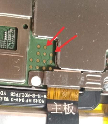

- Join the TP or Short the TP of Device (you need to disassemble the device).

Test Point

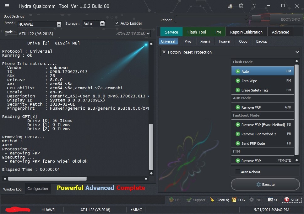

Logs
PreOperation Configuration
Brand : HUAWEI Model : ATU-L22 (Y6 2018) Storage : Auto
Loader: Huawei-ATU-Y6.mbn
Port : Auto
Connection :
FriendlyName :Qualcomm HS-USB QDLoader 9008 (COM7)
SymbolicName :\??\USB#VID_05C6&PID_9008#5&1e7d8db7&0&5#{a5dcbf10-6530-11d2-901f-00c04fb951ed}
Driver Ver :08/31/2015,2.1.2.0
Getting device info..Ok
Device MODE : Firehose
Connecting to Firehose...
Ping.. Ok
Configuration......
Identifying Chip....
Ok
Chip Configuration :
MemoryName : eMMC
MaxXMLSizeInBytes : 4096
TargetName : 8917
Version : 1
*** STORAGE DEVICE INFO ***
Memory Type : eMMC
Block Size in Bytes : 512
Page Size : 512
Manufacturer ID : 144
Serial Number : 847850672
Firmware Version : 858796104
Product Name : HAG4a2
Physical Partitions : 3
Total Logical Blocks:
Drive [0] 30777344[14.676 GB]
Drive [1] 8192[4 MB]
Drive [2] 8192[4 MB]
Protocol : Universal
Running : Ok
Phone Information.....
Vendor : unknown
SDK : 26
Release : 8.0.0
ABI : arm64-v8a
Locale : en-US
Description : generic_a53-user 8.0.0 OPR6.170623.013 eng.root.20200225.190715 test-keys
Display ID : System 8.0.0.073(091X)
Security Patch : 2020-02-01
Fingerprint : Huawei/generic_a53/generic_a53:8.0.0/OPR6.170623.013/root02251907:user/test-keys
Reading GPT[3]
Drive [0] 56 Items
Drive [1] 0 Items
Drive [2] 0 Items
Removing FRPta...
Method :
Auto
Processing...
- Removing FRP
Executing ...
- Removing FRP [Zero Wipe] OkOkOk
Elapsed Time : 00:00:04
