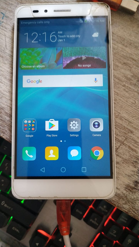

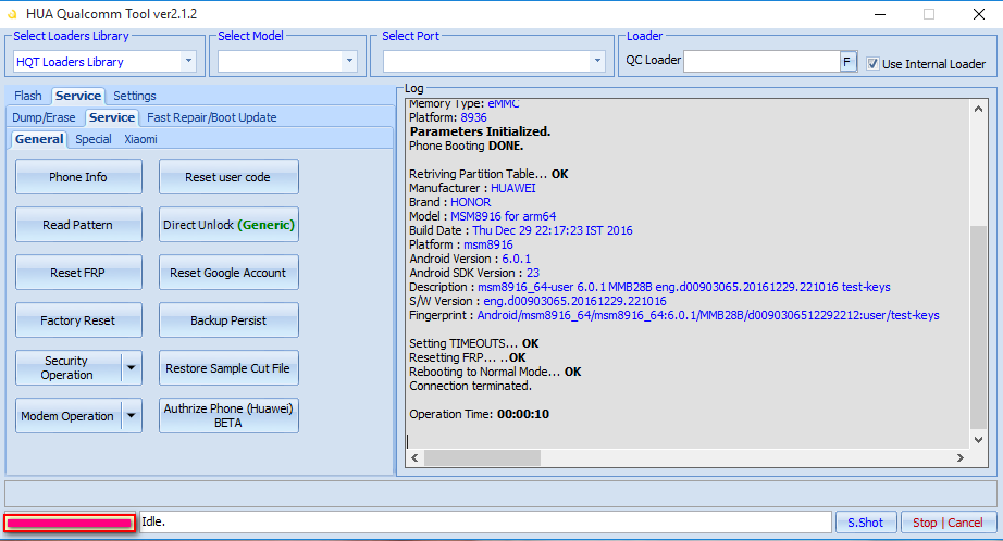

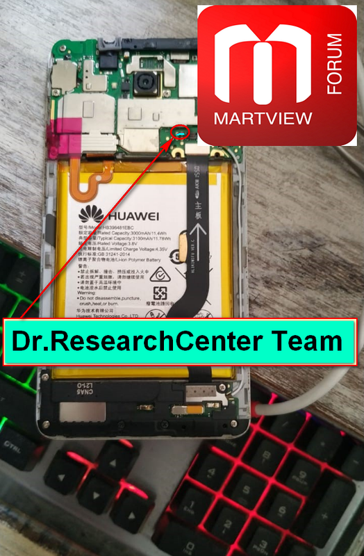

Huawei 5x KIW-L21 EDL Point | Test Point + FRP UNLOCK ( SOLVED )
Searching for Device... OK
Prepairing Device on [COM33-Qualcomm HS-USB QDLoader 9008 ]... OK
Waiting for Phone ACK... OK
Serial Number: 06XXXXXXX
CPU ID: 0090B0E100000000 | Type: MSM8936 Snapdragon 610
SBL Ver: 00000000
OEM Key(PK): CC3153A80293939B90D02D3BF8B23E0292E452FEF662C74998421ADAD42A380F
Changing Mode to SAHARA... OK
Prepairing... OK -> [0000000D][00000000:00000034]
Sending Loader... OK
Resetting... OK
Waiting for Loader Response...Fail!
Second Try... OK
Memory Type: eMMC
Platform: 8936
Parameters Initialized.
Phone Booting DONE.
Retriving Partition Table... OK
Manufacturer : HUAWEI
Brand : HONOR
Model : MSM8916 for arm64
Build Date : Thu Dec 29 22:17:23 IST 2016
Platform : msm8916
Android Version : 6.0.1
Android SDK Version : 23
Description : msm8916_64-user 6.0.1 MMB28B eng.d00903065.20161229.221016 test-keys
S/W Version : eng.d00903065.20161229.221016
Fingerprint : Android/msm8916_64/msm8916_64:6.0.1/MMB28B/d0090306512292212:user/test-keys
Setting TIMEOUTS... OK
Resetting FRP... ..OK
Rebooting to Normal Mode... OK
Connection terminated.
Operation Time: 00:00:10
