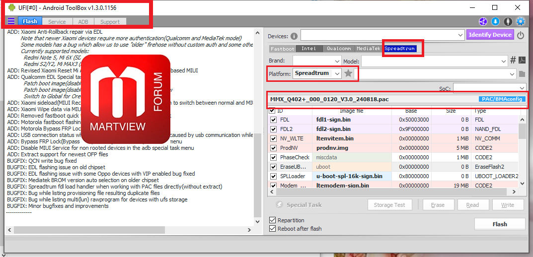

Hi As In Title Many User Confuse How Use Ufi-Box In Spd Pac File NOw We Explain All thing with Full Image Guide
Step-1 Open Ufi-Andriod Tool Box And Select Vendor(Spreadtrum) Then Select Your Flash FIle(Pac Format).

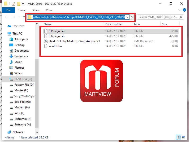

Step-2 Now All File Extract HEre Open This Path-C:\Users\AppData\Local\Temp\UFI\MMX_Q402+_000_0120_V3.0_240818

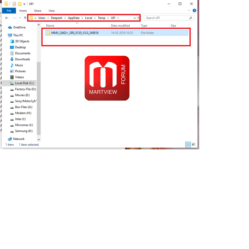

Step-3
Copy Your Model Folder As See In Image And Paste As You Wish(After Close Ufi Andriod Tool You Cant Found This Folder)

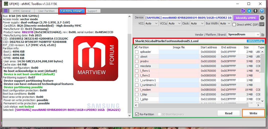

Step-4-

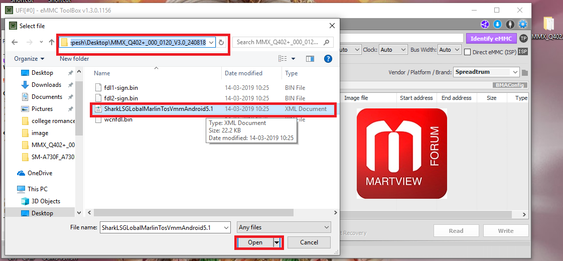

Now Close Ufi- Andriod Tool And Open Ufi-Emmc Tool Select Vendor-Spreadtrum And Select BMA Config File In Your Copy Folder
Step-5 After Select File You Will See All Partition As Image Below Then Select Write
Congratulation After Write You Successfully ReProgramed Your Emmc For Your Handset
